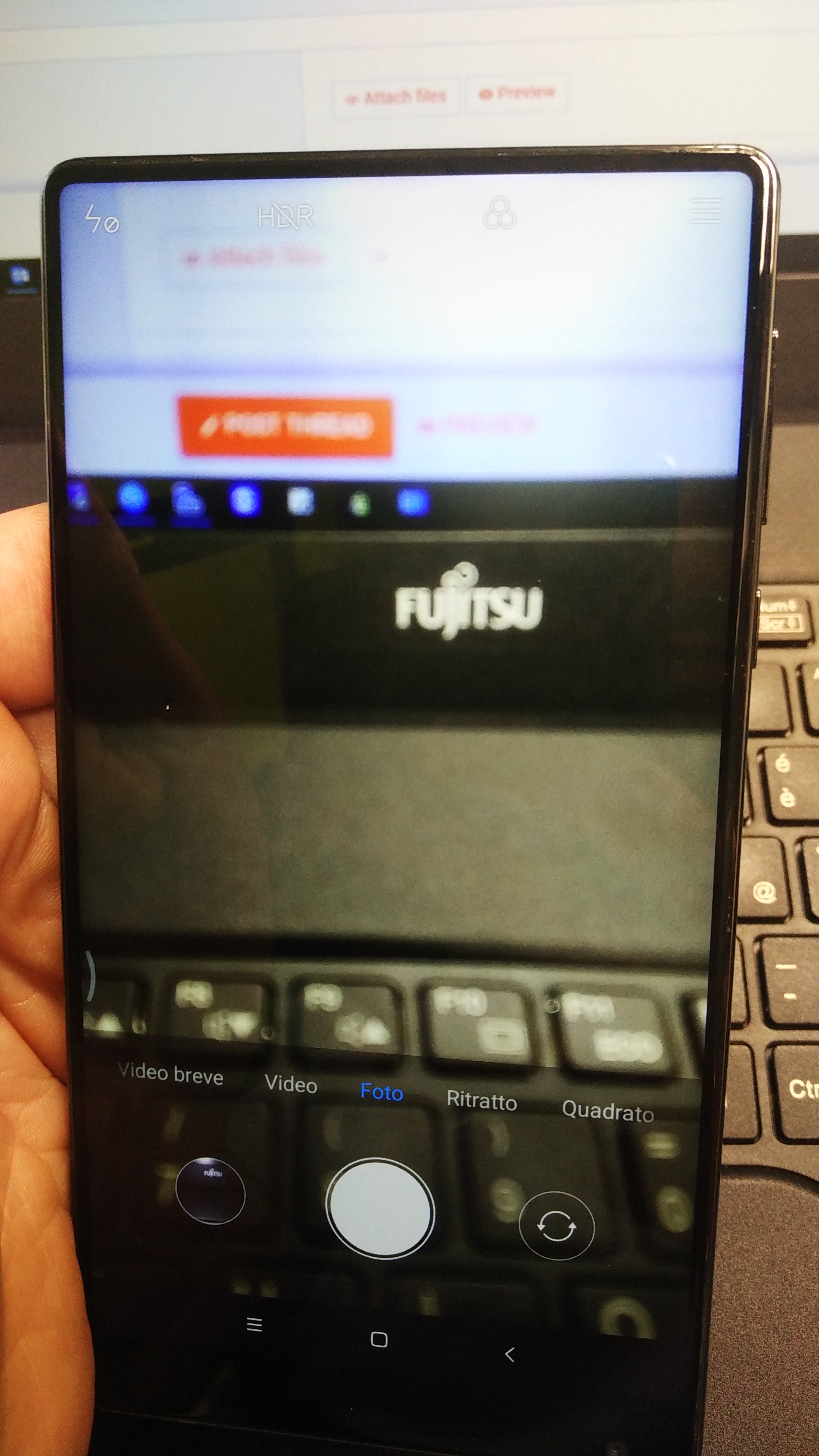

Hi all,
i have upgraded my Xiaomi MI MIX from miui 9 to 10, from 8.3.26 developer to 8.8.9 developer using twrp-3.2.1-raupe-blunden.
Now is impossible make focused photo. i can't set focus by clicking the touch.
any suggestion?
thanks a lot
Andrea

i have installed WEEKLY 8.8.9 from this site
Any suggestion?
it will be even an hardware problem?
thanks

I try with other 3 camera apps but focus is very bad. i think that it will be an hardware problem that appears after the substitution of the damaged screen made by a technican...
Do you knows a centre that can change it professionally(in Italy)? However I try to find out the part on aliexpress and after I change it...
Thanks a lot for support
