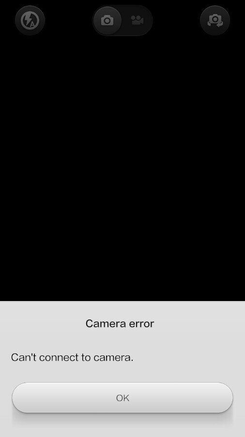

There are still camera issues on the mi2s on 3.9.13, 3.9.6 and in 3.8.29 that require a reboot to fix
Someone else also has this issue
en.miui.com/thread-7209-1-1.html
Sent from my MI 2SC using Tapatalk 4
I will also add that a reboot fixes it but this problem affects all apps trying to access the camera.
No I haven't and reading around it won't help. Can't even believe it will fix it as well as issue goes away after a reboot.
For 3.8.29 I did do a complete reinstall of apps and Roms. Which is why I think doing it again won't fix it.

Also when hen trying to activate the flash as a torch which doesn't work and play a podcast in beyond pod where there is no sound during playback.
Seems HW issue... Return your phone under warranty...
~Tapatalk 4~
If Miflash version didn't fix that, its HW related and there is nothing what we can do... Sorry....
~Tapatalk 4~
I'm prepared to do a miflash and completely flatten and restore the device but when you say if miflash didn't fix that, as I am only updating via downloading the run and using the recovery update process again what is making you deduce it is hardware related because a reboot fixes it. I would have expected if it is hardware then it would be more consistent. As mentioned this only started happening since 3.8.23.
So make a MiFlash and we all will see.. Hope it will solve your problem...
~Tapatalk 4~
I have successfully updated with miflash. I will let you know the outcome over the next few days. From my first observations the font in the notification bar is different ie slightly larger even though I have selected small.
This isn't an issue but it's showing me that the miflash had fine something.
I will speak soon. Thanks for your help so far.
just install our ROM again.. MiFlash version wiped all and hope it fixed your issue..
I'll run with the miflash 3.9.13 for a few days before putting your Rom on. Thanks
Sadly its not worked. Looks like I need to return the mi2s. Do you know where I start with me being in the UK?
I bought the phone from ibuygou.
Contact ibuygou support... You will have to send your phone back to them for repair...
~Tapatalk 4~
