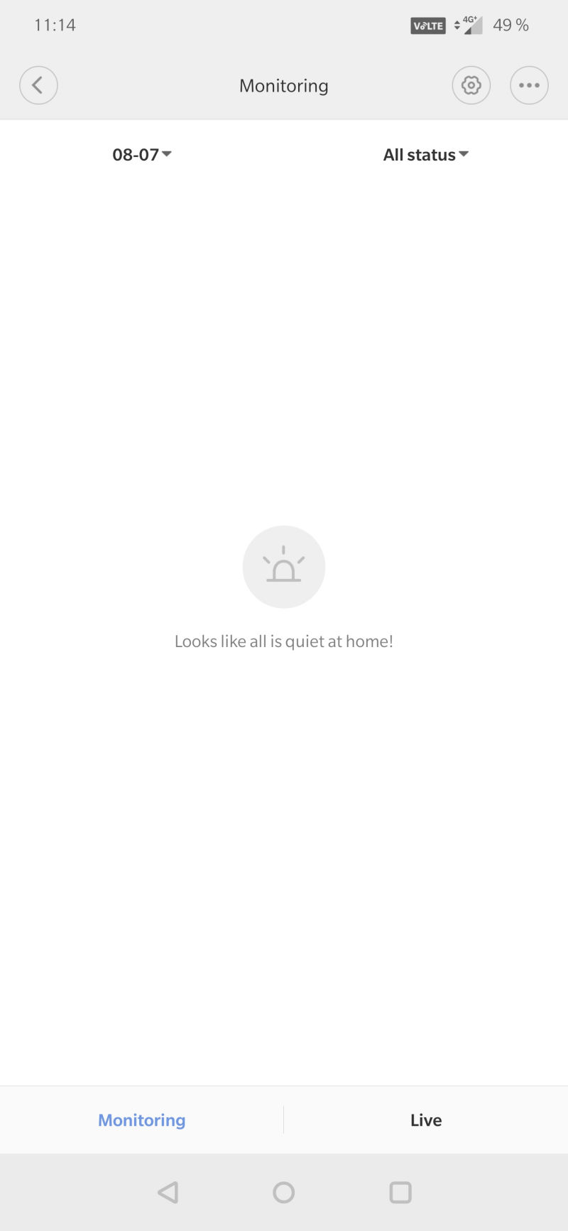

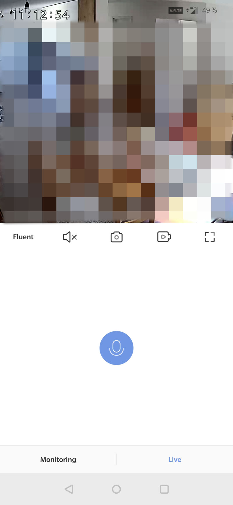

Mine is 5.8.7 showing no "+" button
There is a monitoring and a live tab.
No way to add another camera in both menus settings either.
