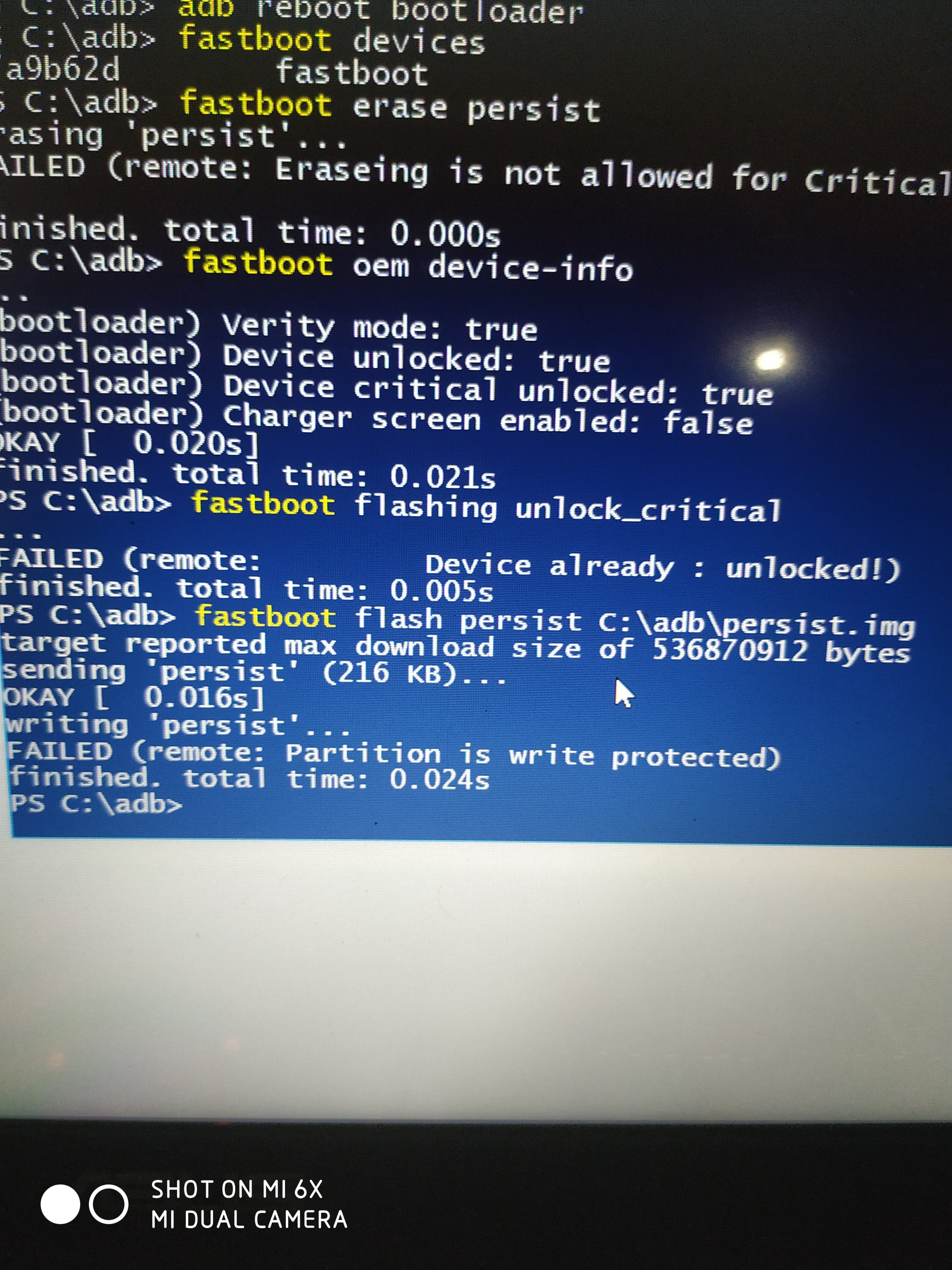

skip other step and do that
fastboot flash persist persist.img
fastboot reboot
still failed,partition is write protected. what is that meang?

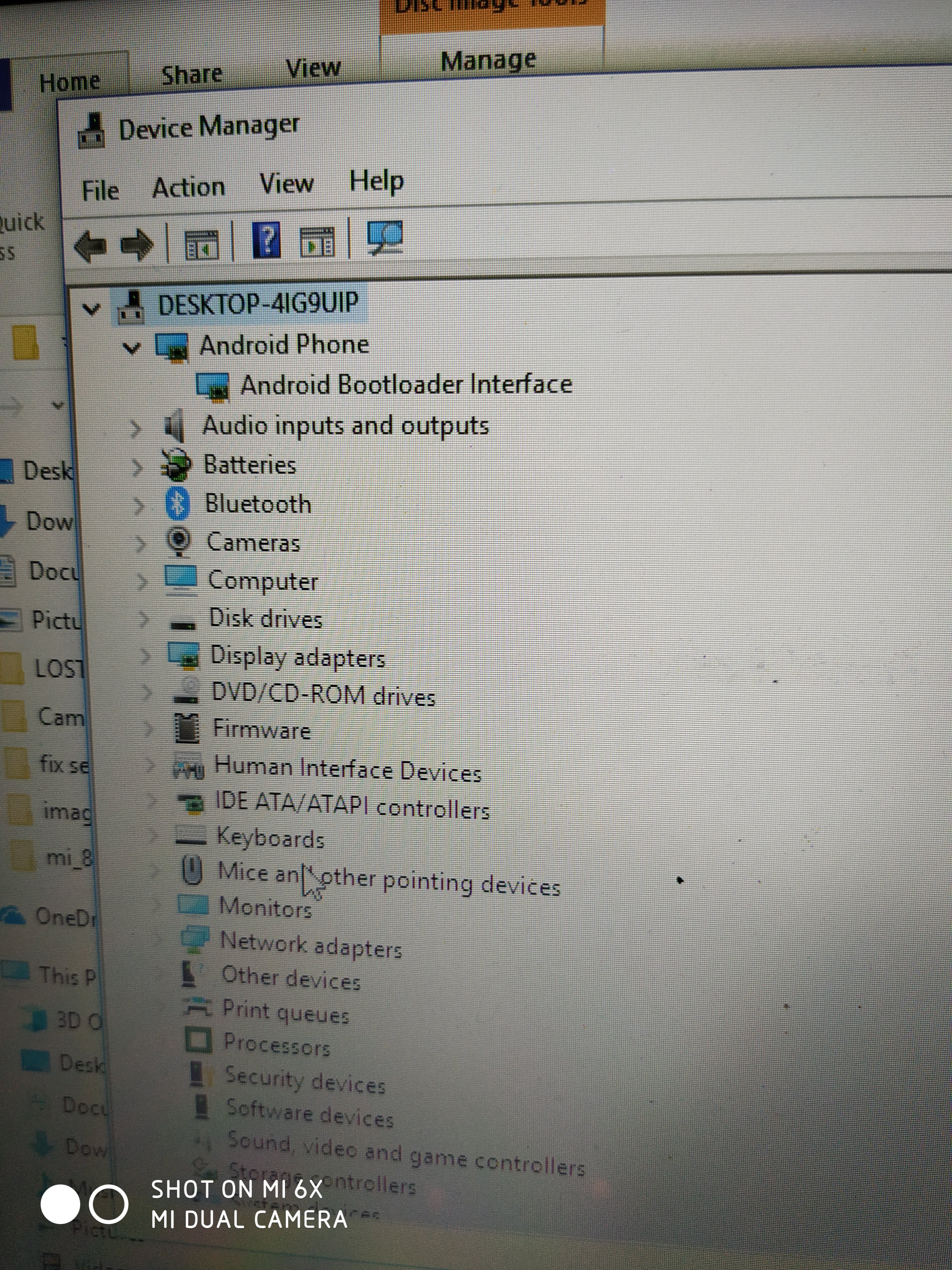

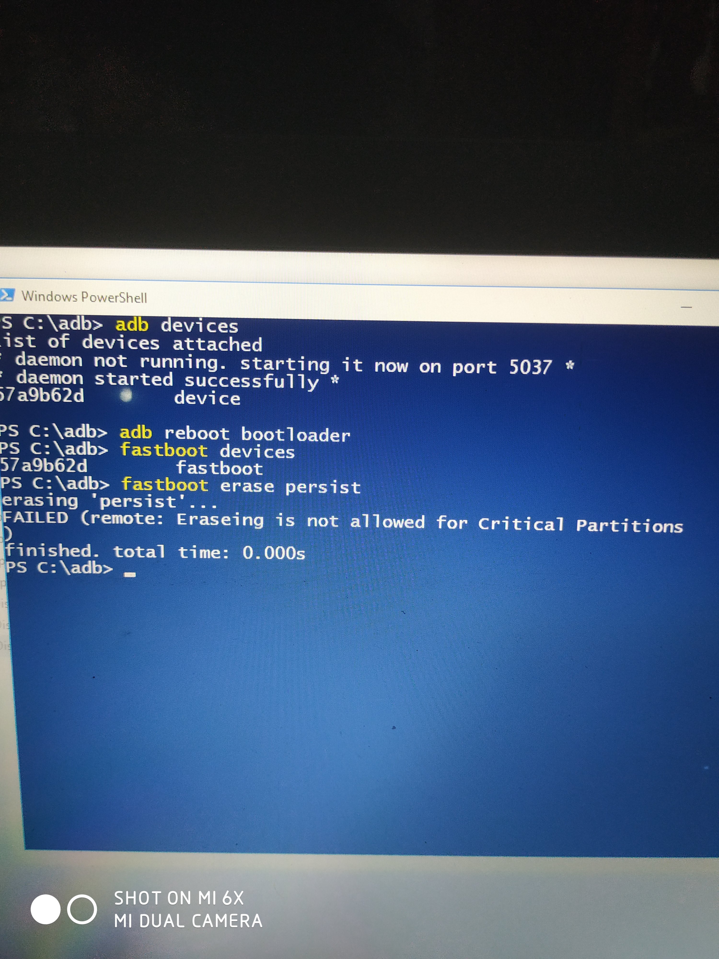

1) when phone opened, write this
adb devices
adb reboot bootloader
fastboot devices
fastboot erase persist
fastboot reboot
2) and in fastboot mode write this command
fastboot devices
fastboot reboot
adb devices
fastboot devices
fastboot reboot
fastboot devices
fastboot reboot
im already use that command,but always failed remote partition is write protected
