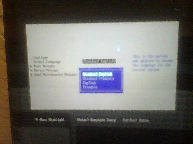

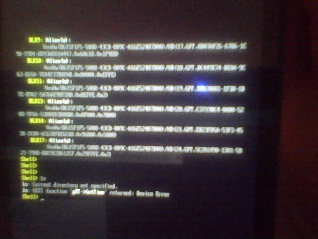

status update:
- Build system: Done
- LK: can be compiled as a library, used by UEFI
- UEFI: boots, console, MMC, Display working, can boot to UEFI shell or GRUB.
Next steps?:
- improve rendering speed (using NEON)
- improve MMU mappings and automatically import them from LK
- add support for booting Android
- add support for finding Multiboot installations
- create a better GUI
