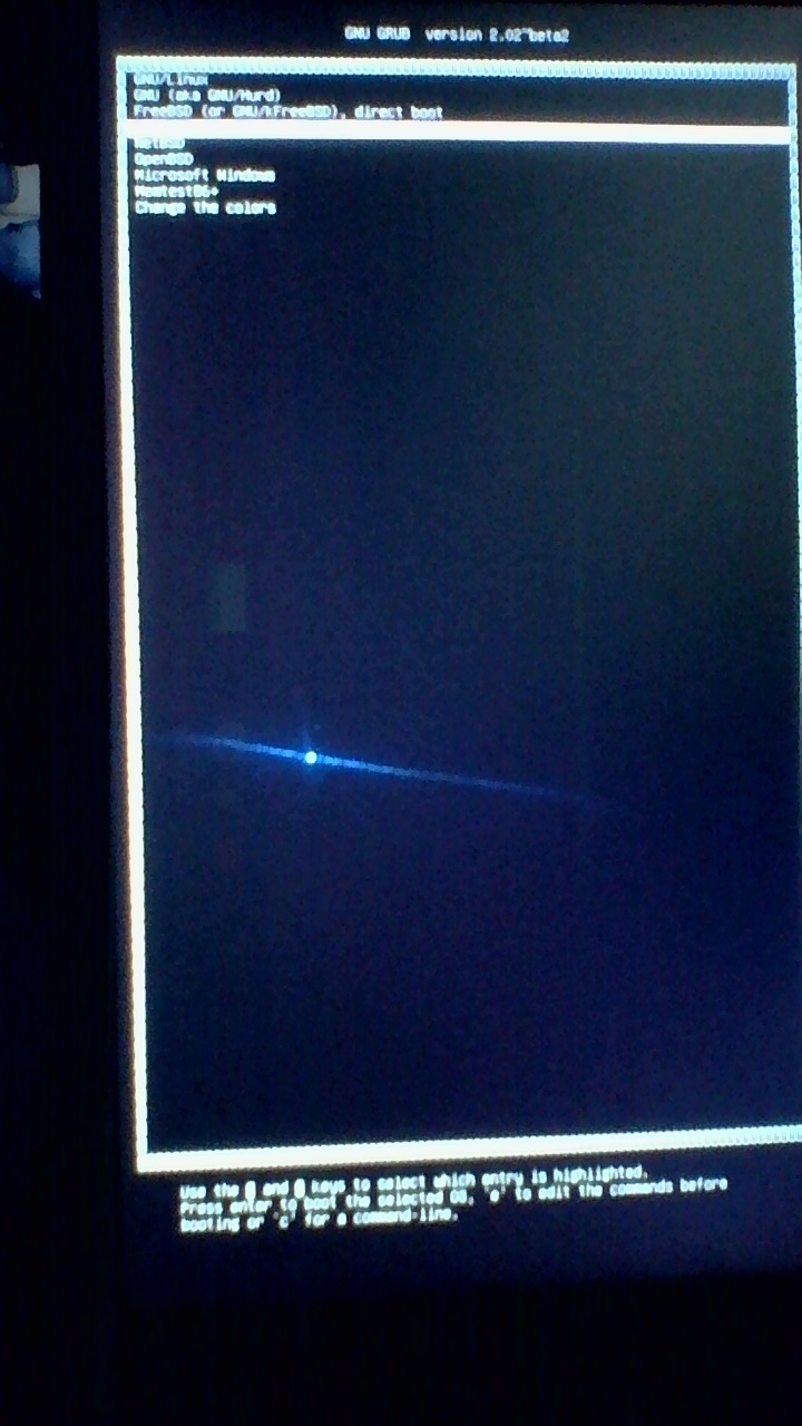

couldn't get memory map, not enabling caches[1430] API_env_get: grub_term
[1430] API_dev_enum
Welcome to GRUB!
error: unknown terminfo type `r'.
[1430] API_env_get: grub_bootdev
[1430] API_env_get: grub_bootpath
GNU GRUB version 2.02~beta2
Minimal BASH-like line editing is supported. For the first word, TAB
lists possible command completions. Anywhere else TAB lists possible
device or file completions.

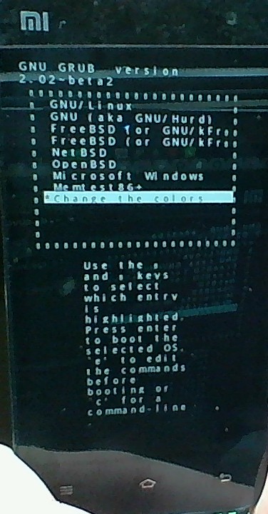

grub> help
authenticate [USERLIST] boot
break [NUM] clear
continue [NUM] devicetree
echo [-e|-n] STRING export ENVVAR [ENVVAR] ...
gettext STRING help [PATTERN ...]
initrd insmod MODULE
linux ls [-l|-h|-a] [FILE ...]
menuentry BLOCK normal
normal_exit parttool PARTITION COMMANDS
probe DEVICE return [NUM]
set [ENVVAR=VALUE] setparams [VALUE]...
shift [NUM] submenu BLOCK
terminal_input [--append|--remove] [TE terminal_output [--append|--remove] [T
terminfo [[-a|-u|-v] [-g WxH] TERM [TY unset ENVVAR
grub>

That's some seriously awesome stuff.LCD works now. First time I saw the GRUB UI on a phone![]()
