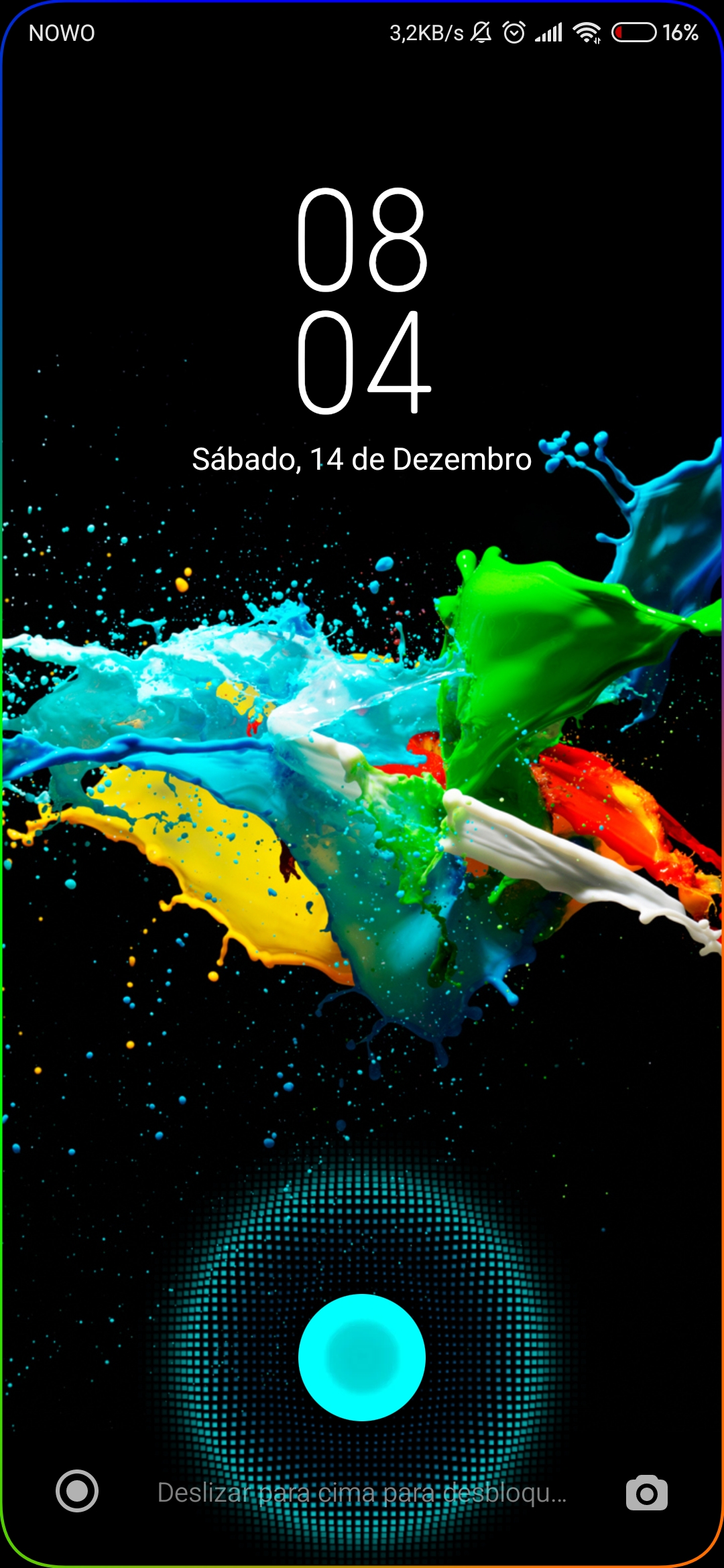

I don't understand what happened after I update to 9.12.12 OTA from 9.12.5 on my k20 pro, my fingerprint sensor doesn't work anymore.
It's like the light coming from the sensor is lower, I don't know if it's possible to see it in the screenshot.
