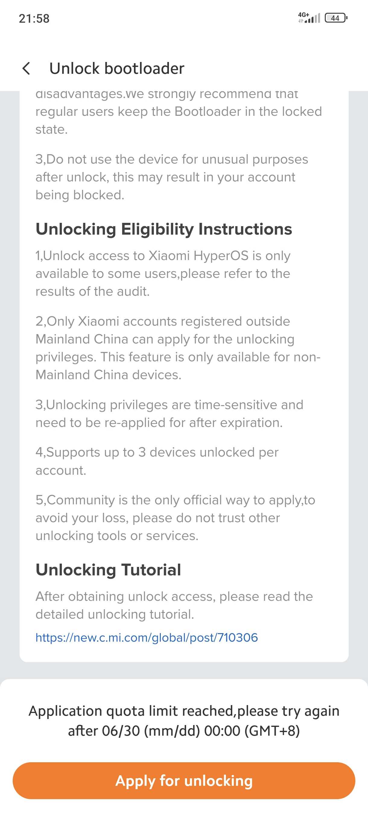

Hi, i have this message "quota limite reached", i need to wait 2 days ?

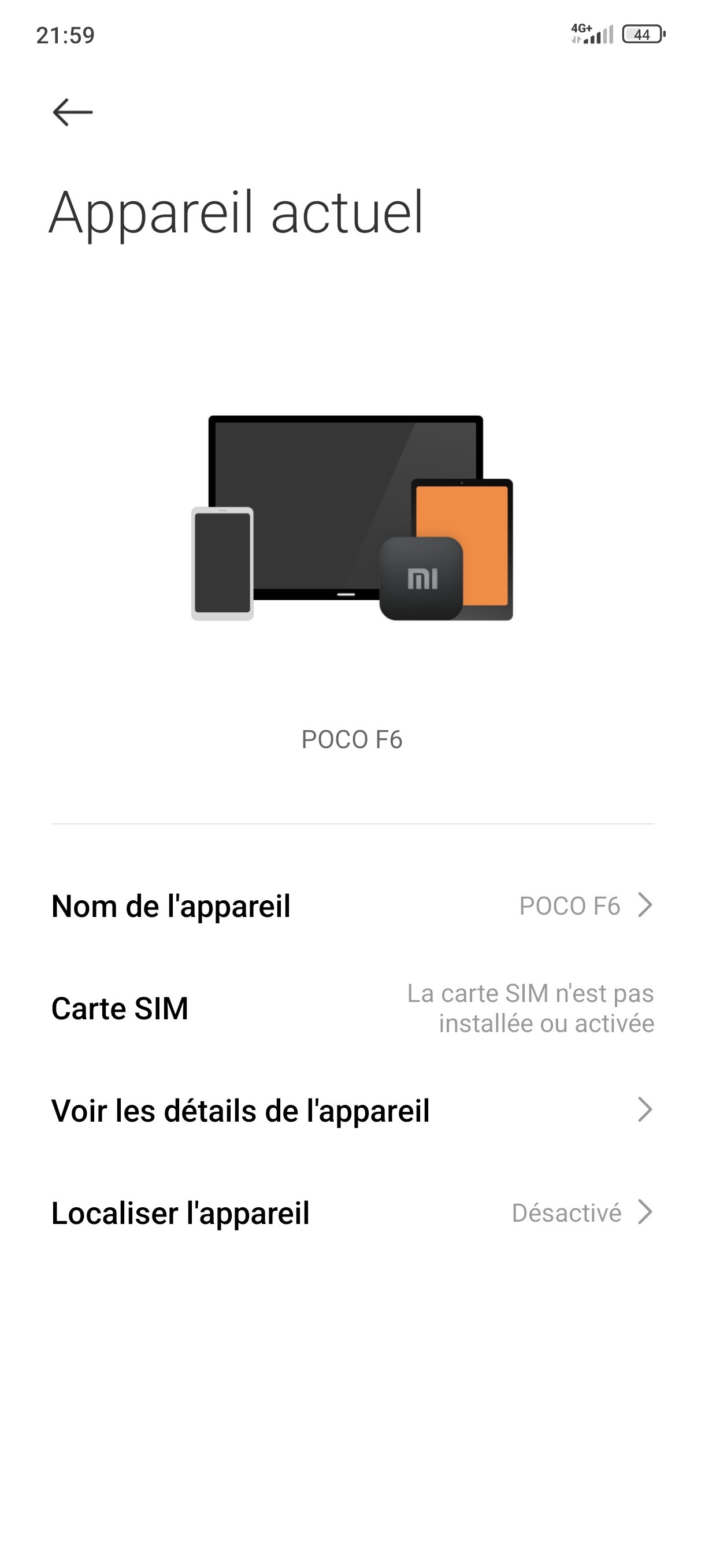

And i have this message Who say my sim is not insered or activated, she is in the Phone And 4g work
Any ideas ? Thanks
Any ideas ? Thanks
I'm unsure about the sim, but if you want to unlock your poco, you need the sim registered with your Xiaomi account. You can change the phone number associated with your account at account.xiaomi.com.
About the quota, you open Google, type in Beijing time, choose the first result, and wait till it's 00:00 Beijing time, you apply for permission to unlock around that time and you'll surely get it.

No, the 30 days requirement is for your Xiaomi account, not your phone number that attached to it.
The quota is granted based on the time in Beijing (UTC +8) and it got reset everyday at 00:00. If you want to get it for sure, you should click the apply button around that time.
If I change the number There's no guarantee that it's going to work, because I really feel that nothing happens when I enter my number
I show you in video https://streamable.com/50zh4v
Reactions: SamRezaX
Update I have successfully add my account in my unlock on dev setting, but stay the problème the sim is not installed or activated
