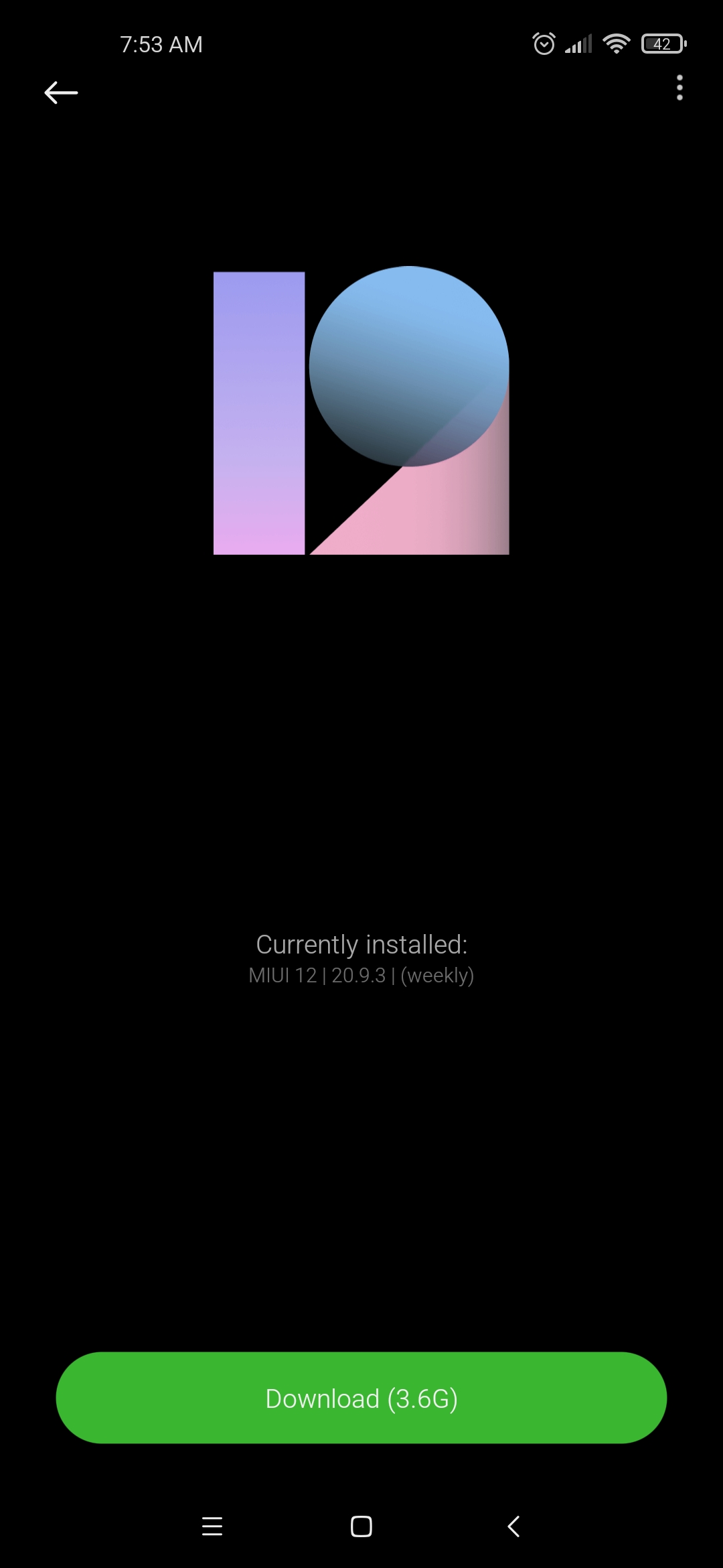

I have the EU ROM on the Mi 10 Ultra, how do I do the updates.

The updates from within the device itself (Over The Air - OTA) need to be installed in 'recovery mode' with a special tool - TWRP (TeamWin Recovery Project). An official version of this tool is not yet available. A Chinese alternative, originally meant for the Mi10Pro that also seems to work on the Mi10Ultra, has been spotted. You can use that - at your own risk - or wait for the official version to be released. Without TWRP you cannot install the OTA updates, you'll need to use fastboot.
So I understand that I have to download from a given soft link and run fastboot updates ?

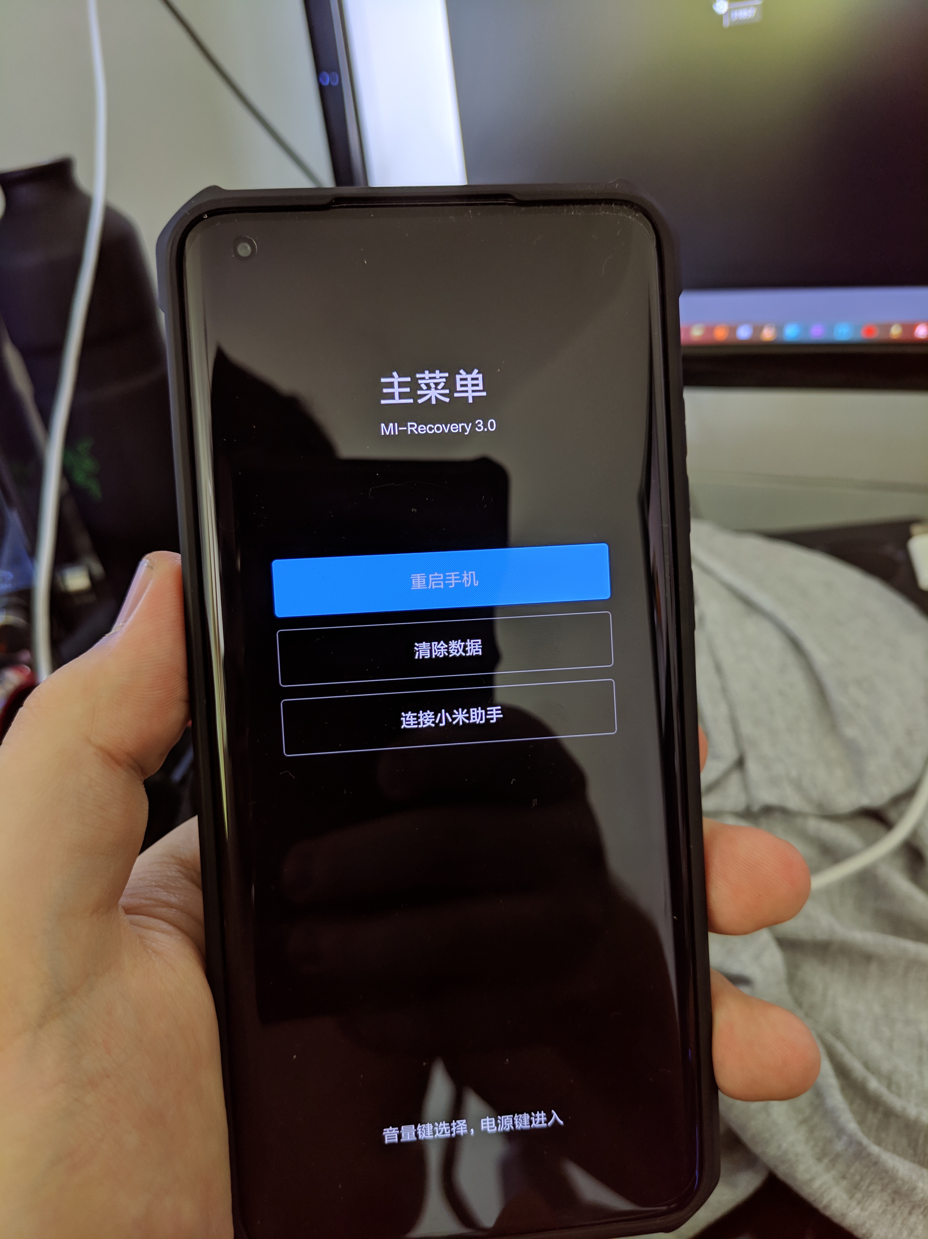

I don't get it.. I did everything OP and everyone here said.
Swapping fastboot.exe with fastboot.exe from mi flash unlock directory.
Starting: windows_fastboot_first_install_with_data_wipe
Then after that:
windows_fastboot_update_rom
(Using a script .bat file with the provided code)
My phone keeps on rebooting or boots into this:
Also the same menu when i try to boot in recovery mode:
I can't press anything in the menu and after a minute it keeps on rebooting
*Edit*: found out that the second one is "clear data" and that i have to press with the buttons on the phone.
Please help :(

Why did you use second script? If you are updating for the first time it is only the first script with wipe. The second script is only for updates. If it's your first time, just the first script.
Boot to fastboot, power vol down and flash as stated.

Ok I managed to get it working.
I had to clear the data of the phone while inside the Chinese recovery menu :)
