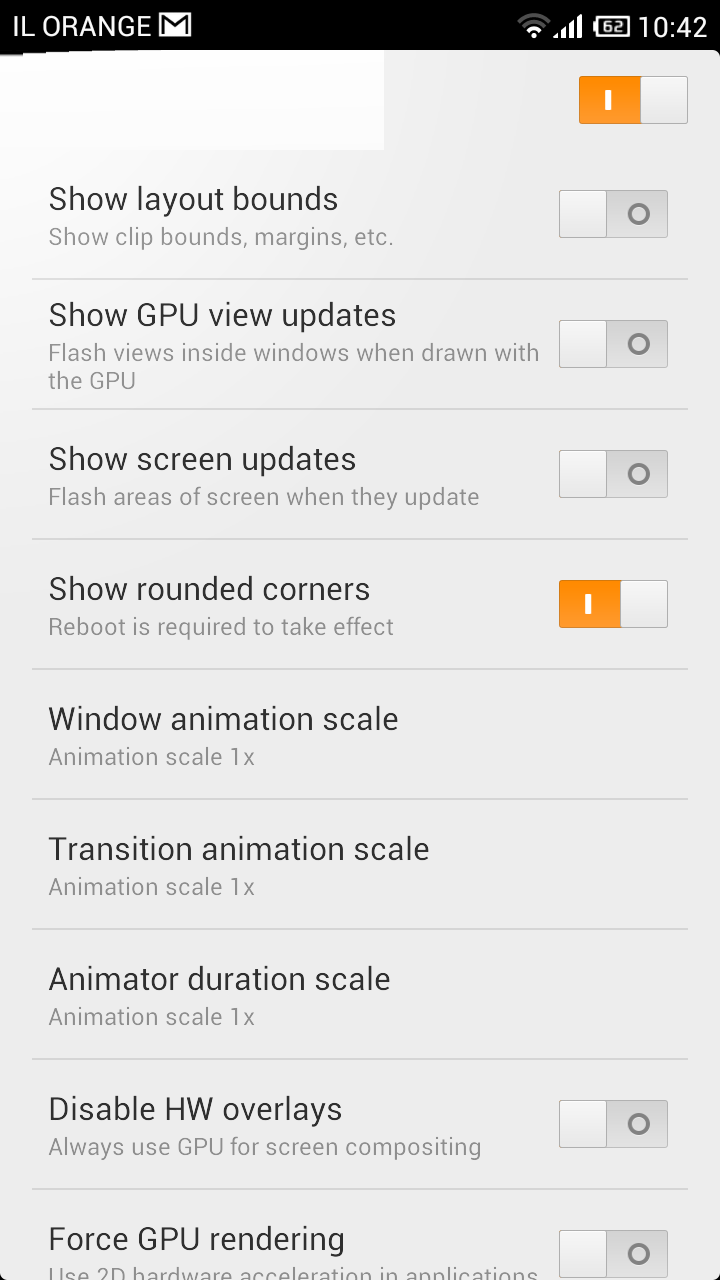

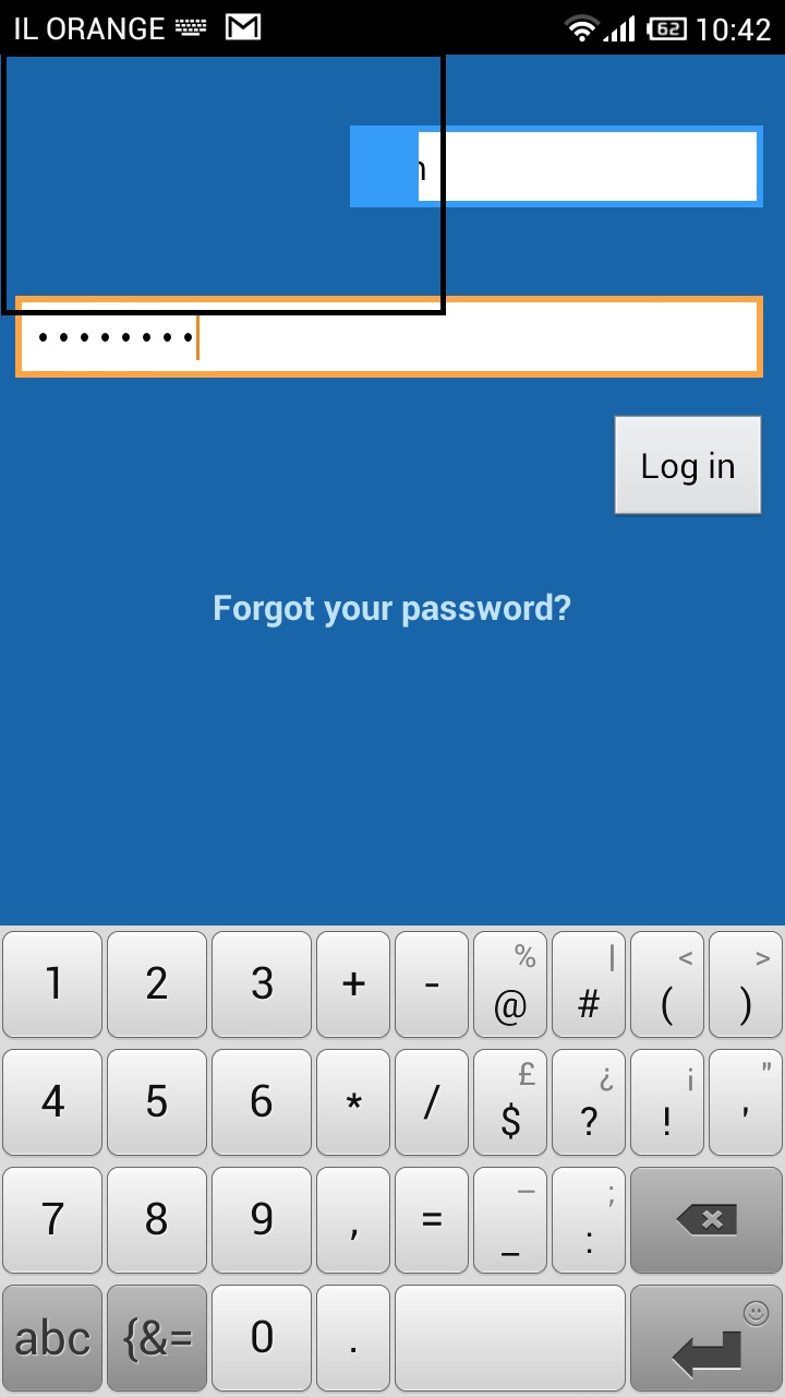

I have a driver problem in my screen, sometimes the screen shows a 2cm x 3cm rectangle at the top left side of the screen with something it takes from another place in the same screen.
I've tried flashing JLB versions and did a full wipe but it still happens.
Do you think that this process may work to fix the screen driver? as this flashing is in a lower level?

I have tried the last version, version 3.2.1 now. JBL 7 and JBL10. 3.2.1 with MiFlash and the same problem appears. BTW, the screen test of Xiaomi with the dialer code works fine in RGB, only sometimes after a couple of seconds/immediately I see the rectangle, it becomes normal after I move the screen a little bit.
I marked it in black in the 'dropbox' screen shot.Screenshot_2013-01-30-10-42-14.pngScreenshot_2013-01-30-10-42-43.jpg
