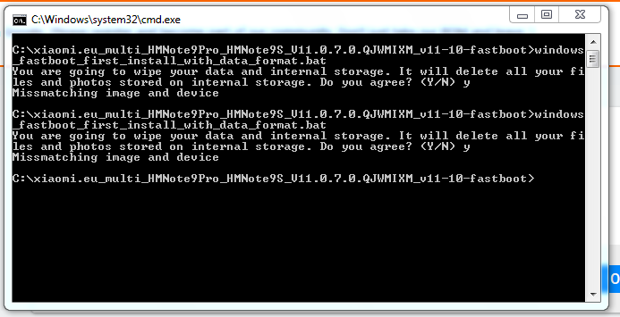

Redmi note 9 pro showing mismatch device and image
30828
