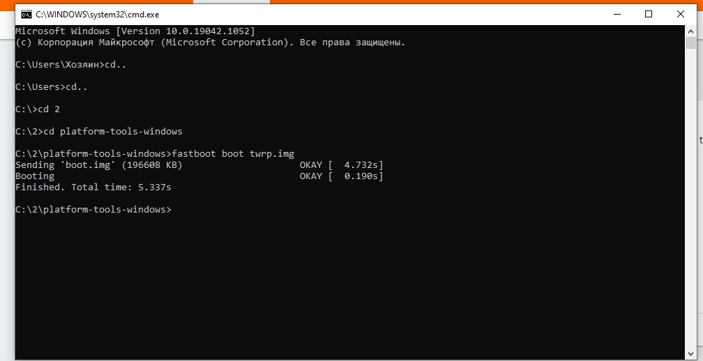

can`t boot into TWRP - after "fastboot boot twrp.img" my phone is in black screen....
it did not power up itselves
When i tryied to see what recovery inside - "pressing volume UP button + power button" i saw stock MIUI recovery
Used this one link from first post
What i did wrong?

did you do this:
Some people are downloading the twrp image file, they dont put it into the fastboot path, dont rename it and then they try to execute this command
# fastboot boot twrp.img
Without any detail we cant help
PS: why dont you use this TWRP-Image for MI11Pro/Ultra mars/star :
Reactions: Nuclear Blast
did you do this:
yes, after downloading i put renamed file into right directory and it was booted into phone normaly
With this image of recovery everything went smooth - phone booted into TWRP
