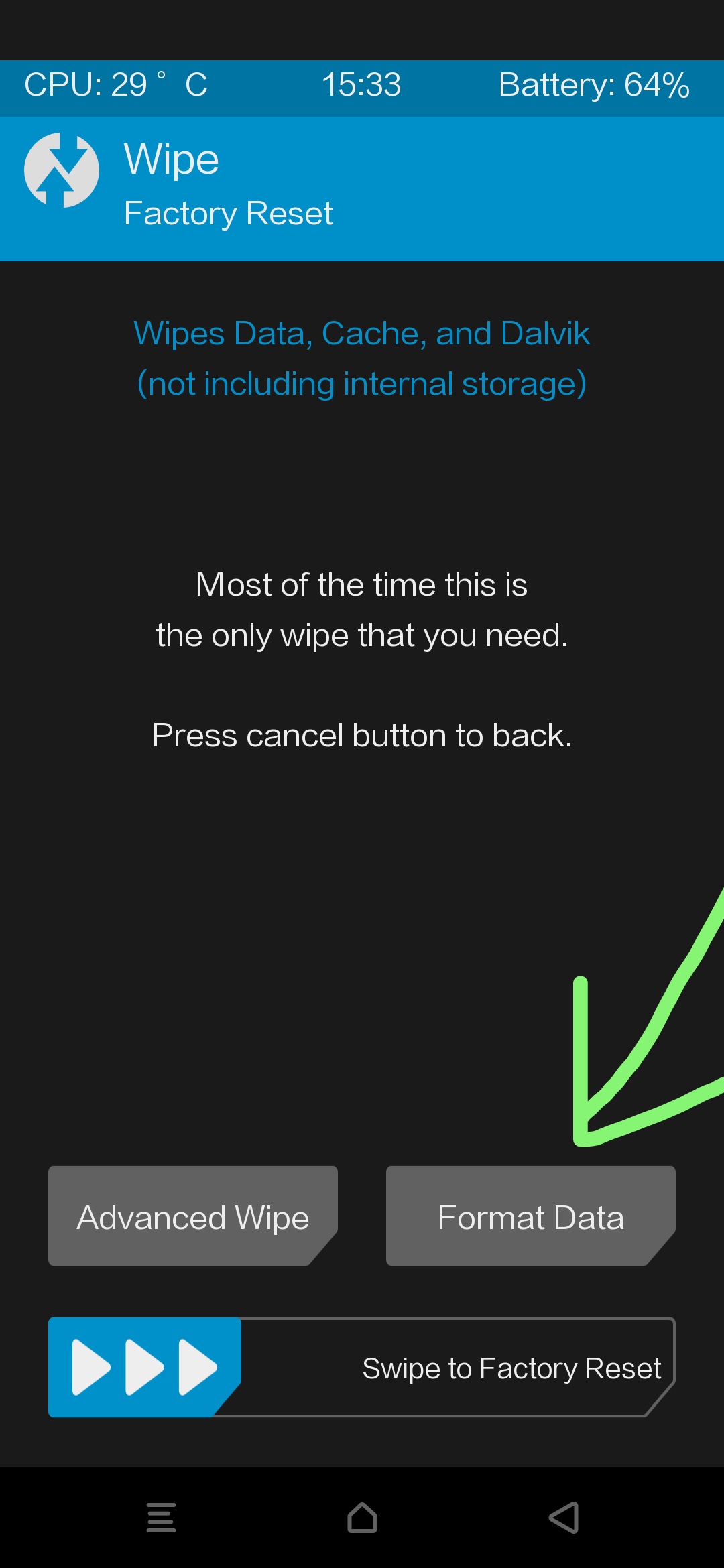

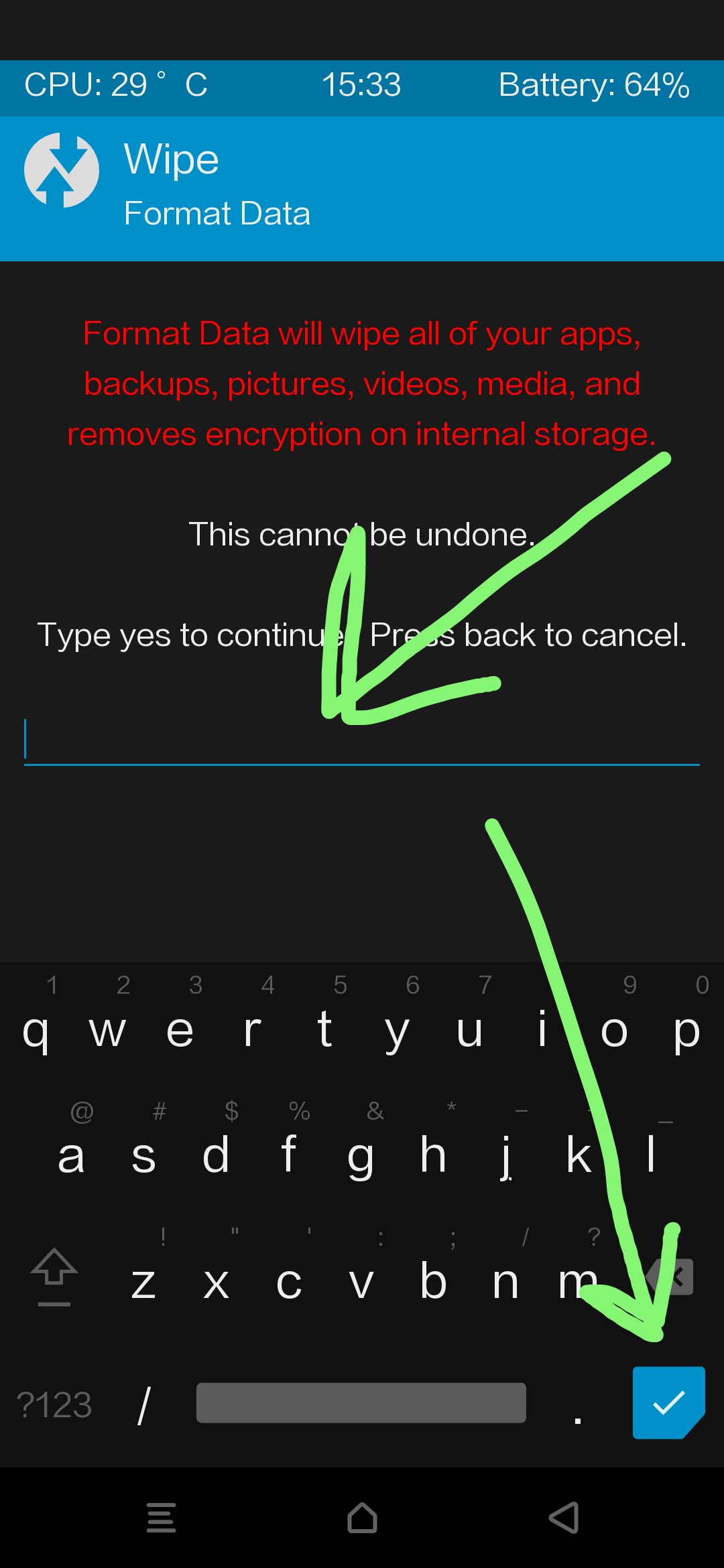

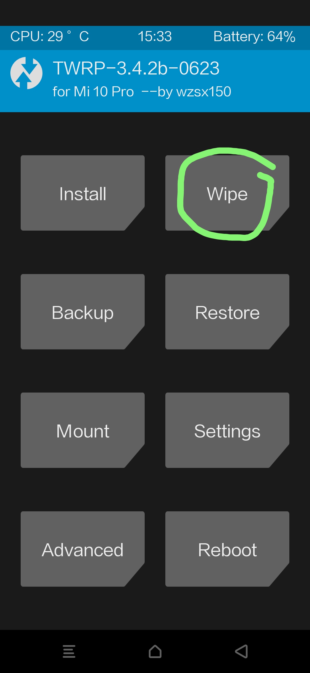

TWRP, wipe menu, select format, type yes to confirm then phone is formatted.
Copy new ROM to phone and install.
Or
Install new ROM, then go in to wipe menu and format. You will know if you are 8n right menu as you must type yes to confirm.
