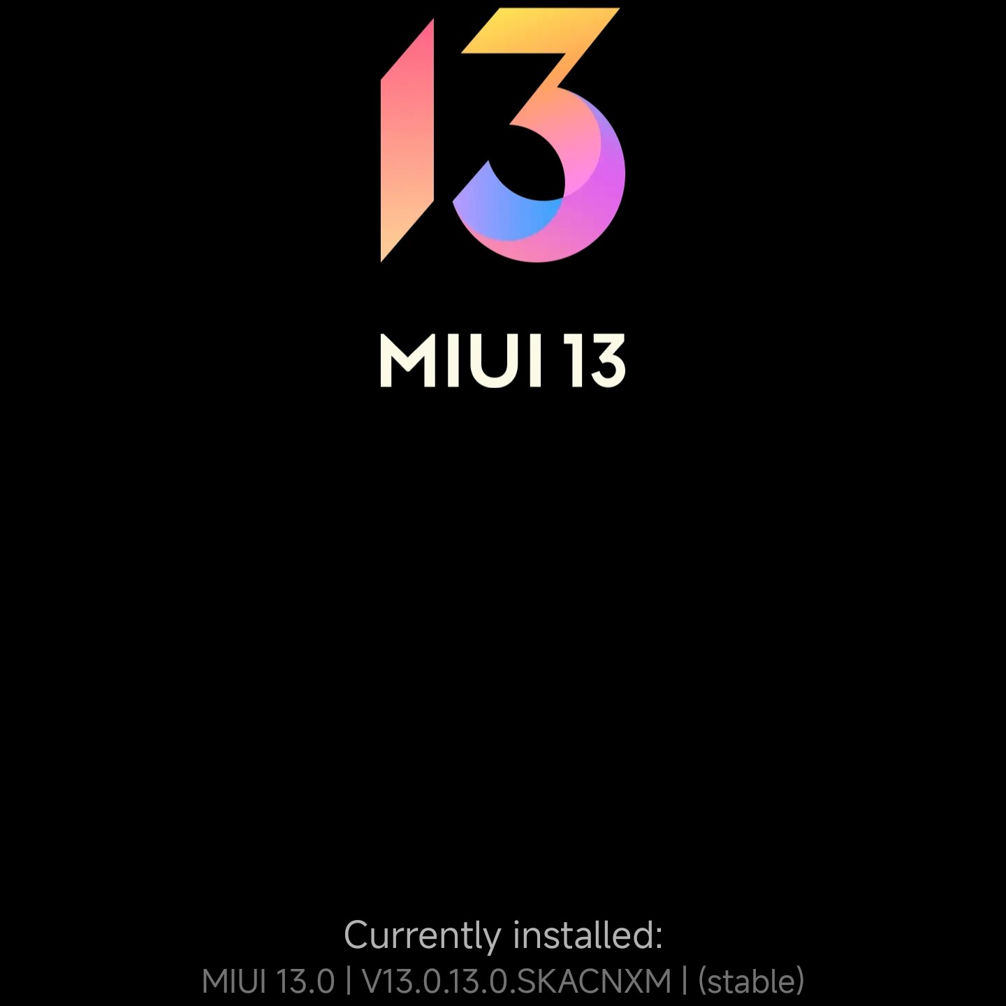

My device is Mi 11 pro. This is my current ROM. Bootloader unlocked. I am planning to install the latest MIUI14 xiaomi.eu ROM.
1. Are the steps still the same? ie. TWRP and install?
2. Does the Stable ROM have any issues with Camera or WhatsApp?
3. Banking apps working?
4. What version of TWRP is recommended?
5. Can I flash latest TWRP over my current ROM and then flash new ROM from it?
N.B device not rooted. No Magisk module
Many thanks

Since we have a new A14 TWRP for Mars/Star is it okay to update TWRP and then flash from latest A13 stable to latest A14 released the last days?
Since you have an A/B device without a dedicated recovery partition, there is no point in flashing TWRP A13/A14 before installing the ROM. Because the ROM will overwrite it to the factory. Install/update TWRP only after installing ROM.

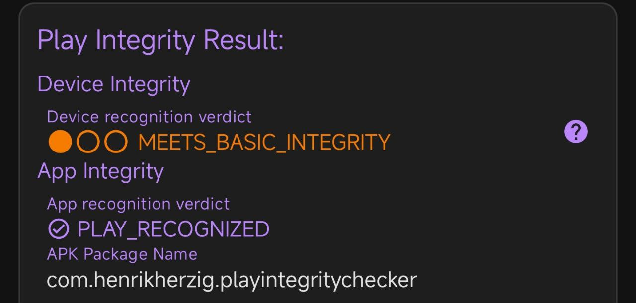

Xiomi.eu 14.0.13.0. TKACNXM Rebooted my phone yesterday and card payments stopped working.
I did the following:
1. install https://sourceforge.net/projects/xiaomi-eu-multilang-miui-roms/files/xiaomi.eu/Xiaomi.eu-app/ app
2. clear "all data" app Google Play Store
3. reboot your device
But after rebooting, have only one ball of passing inspection MEETS_BASIC_INTEGRITY Payment doesn't usually work with, it usually takes 2 check balls to make it work. What else is there to try?

And in HyperOs payment and all other functions work normally, or do you need to update periodically to work?
It is necessary to keep the application "GPay_fix" up to date
Yeah it just updated to version 16, I updated, everything is fine now. Another question, should I upgrade to HyperOS what benefits will I get? After all, when I reflash I will have to install all the applications again? Does it make sense to me?
