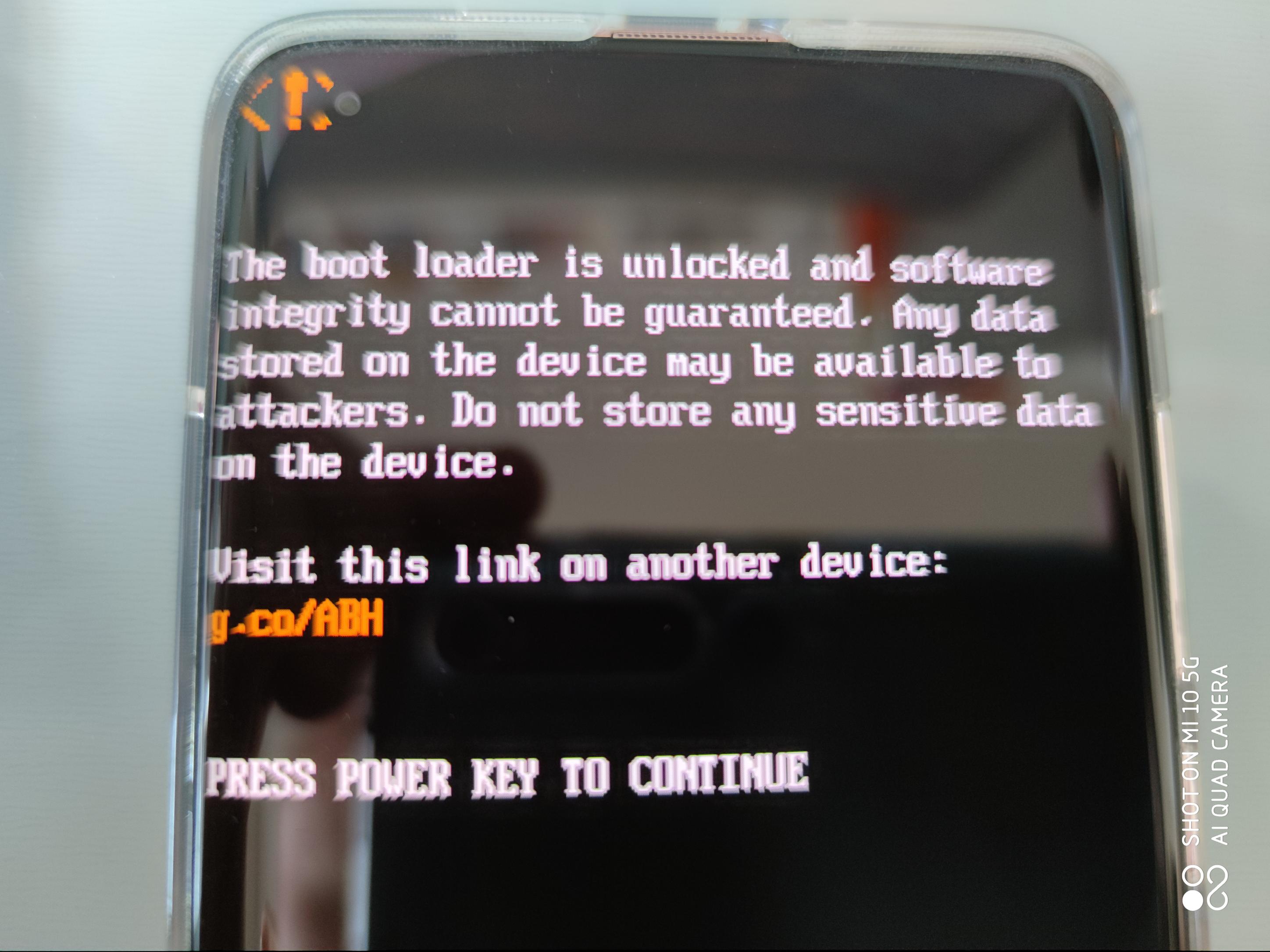

I tried to apply another logo to get rid of the "Unlocked" text at boot up on my Mi 10 Pro.
After using "fastboot flash logo logo.img" and "fastboot reboot" I ended up with the attached text.
The phone still boots up, but before it looked better with just saying "Unlocked" at the bottom of the screen.
So, can anybody help?
Thank you!

u cant unless u relock the bootloader
Wait, there's really no other way to replace this with another picture?
I mean, this message wasn't there after I unlocked the bootloader.
It just appears after I tried flashing the "logo" partition...
Have you tried flashing it back? Use either a complete Xiaomi image, or maybe update the firmware (which may or may not include the logo partition).
Reactions: AlexxWishez
I flashed back the original fastboot ROM & locked my bootloader again. So the message is gone ;)
It seems, that the bootloader is not only "relocked", but actually "locked" :D
