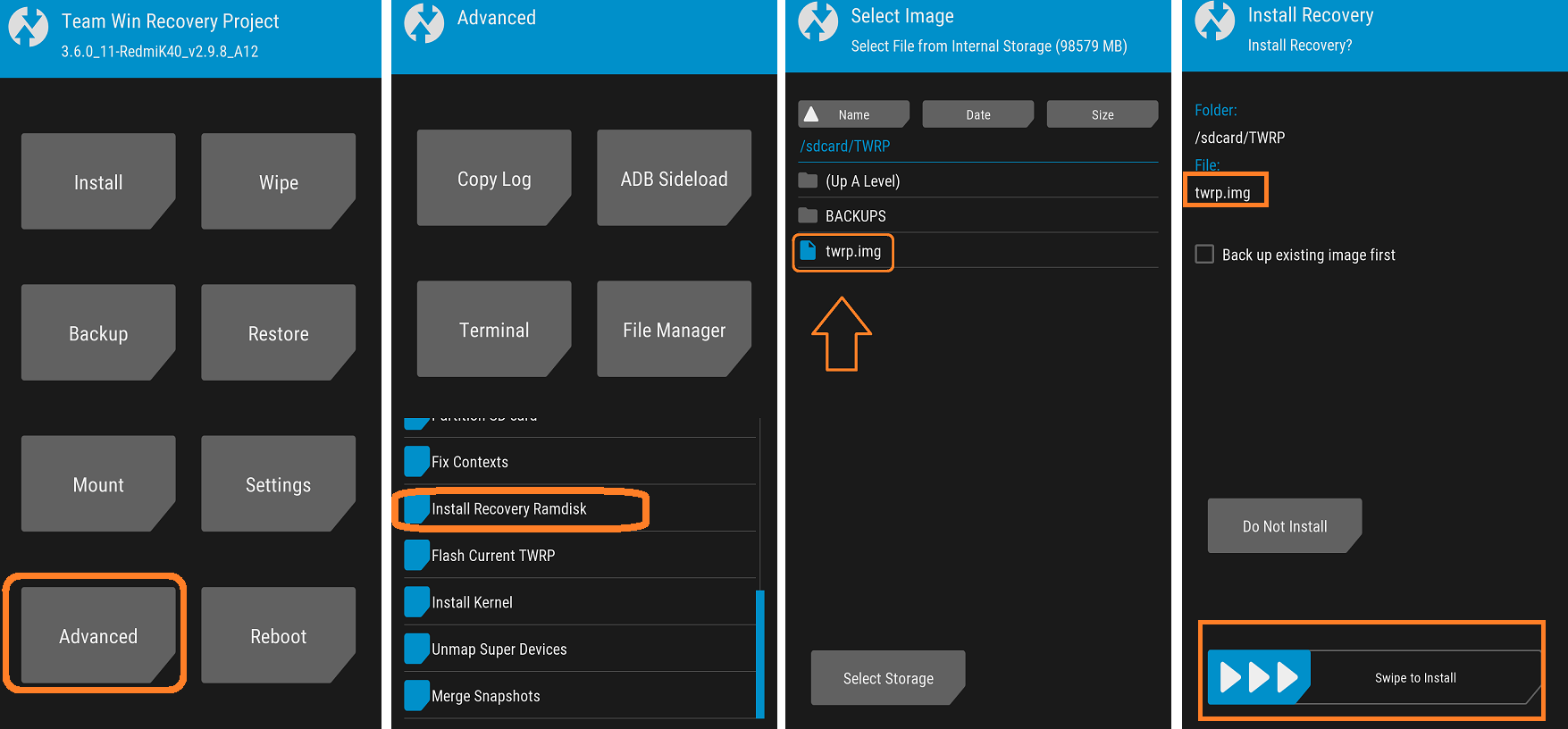

Since I followed your guide about 2 months ago, I definitely installed the "first" modified version of the TWRP specific for the Mi 11 Ultra, but not yet the "official" one ... what can I do if now I want to update the TWRP to this latest one official version?
Thanks again!
Do not update TWRP unless you need it
Updating to a newer build:
1. download new build to internal storage
2. go to Advanced > Install Recovery Ramdisk
4. select the new image
I flashed the 3.5.1 TWRP for my Mi 11 Ultra and there are no such options under the advanced menu. This was before TWRP officially supported Mi 11 Ultra is there any other way?
