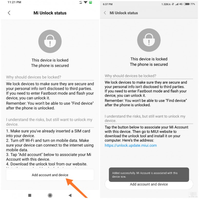

- Enter on "Developer Options" → "Mi Unlock Status".
- Press Add Account and Device and continue to next step.

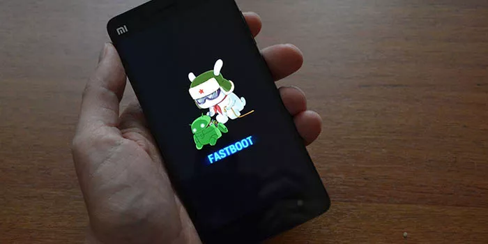

- Press and hold Volume down and Lock Button at the same time.

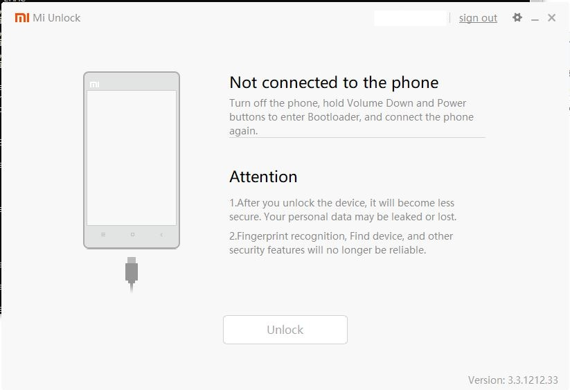

- Wait for this screen
- Connect your phone to your computer (in Fastboot mode)

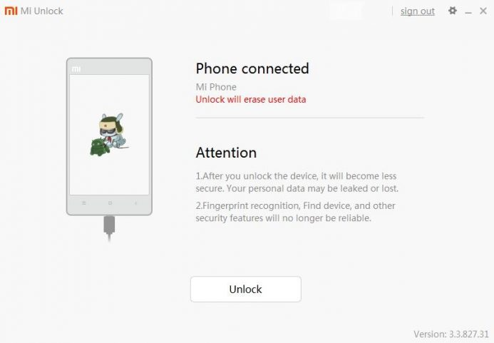

- When the program recognize your phone this is what you are going to see:

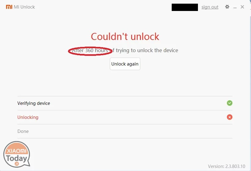

- Click Unlock, you need to see an error like this, in my case it was 168 hours.
[BGCOLOR=rgb(26, 188, 156)]To continue with the process you need to wait the time is showing you the program.[/BGCOLOR]

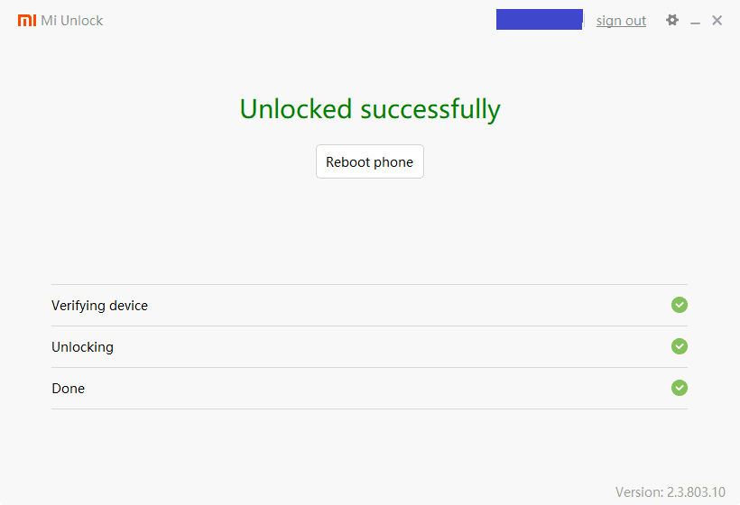

- Open Mi Unlock and try again.
-This time this window will come out.
[BGCOLOR=rgb(184, 49, 47)]This step will [/BGCOLOR][BGCOLOR=rgb(184, 49, 47)]erase[/BGCOLOR][BGCOLOR=rgb(184, 49, 47)] all the contents of your phone[/BGCOLOR]
[BGCOLOR=rgb(243, 121, 52)]6.AFTER SUCCESFULLY UNLOCK[/BGCOLOR]
[BGCOLOR=rgb(65, 168, 95)]I consider a succesfully reboot when you can use your phone as always, It means for example enter your SIM code, use apps, call...[/BGCOLOR]

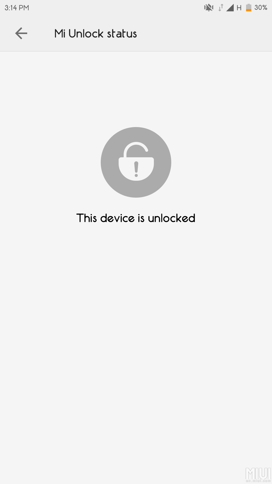

- Enter in Developer Setting → Mi Unlock Status to make sure that your phone status is unlocked.
[BGCOLOR=rgb(26, 188, 156)]If you don't see Developer Settings, go back to 2nd step.[/BGCOLOR]

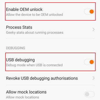

- Turn on USB Debugging and OEM Unlock. (In developer options too)
Press and hold Volume down and Lock button and the phone is going to make a reboot.
With this simply reboot you can use your phone as always.
[BGCOLOR=rgb(243, 121, 52)]Volume down + Lock button[/BGCOLOR]
[BGCOLOR=rgb(26, 188, 156)]This combination is so useful to reboot in situations when your phone gets freezed or you can't select a turn off option[/BGCOLOR]
Observations:
Use your phone as always, don't do a wipe or factory reset, try to have always internet connection during the 168 hours.

- Take your phone and enter on fastboot mode.
- Connect your phone to the computer.

- Put your phone on Fastboot mode
- Run Flash_TWRP.bat and just follow the indications, you just need to press a key when the program tells you.
