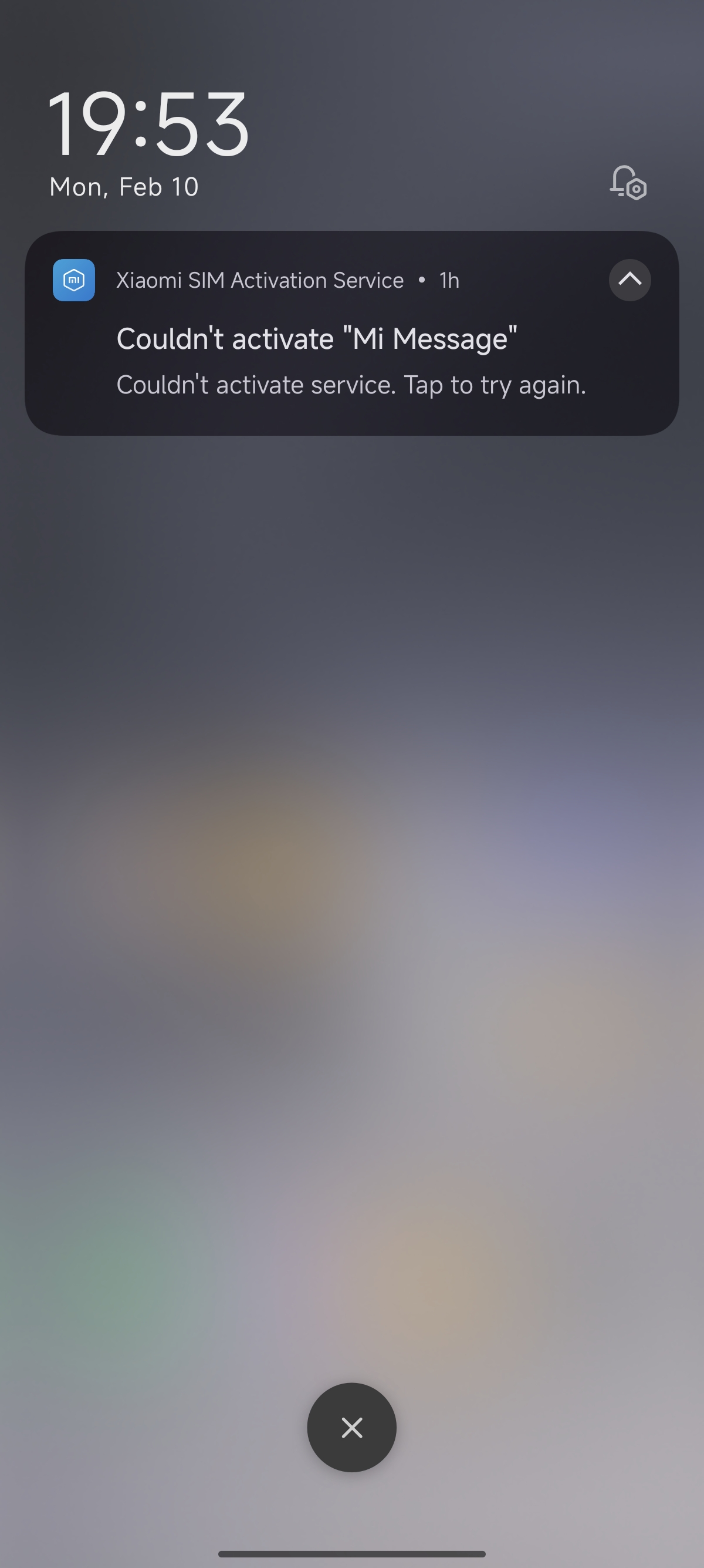

I can't activate mi message. Any suggestions for fixing this? Houji.

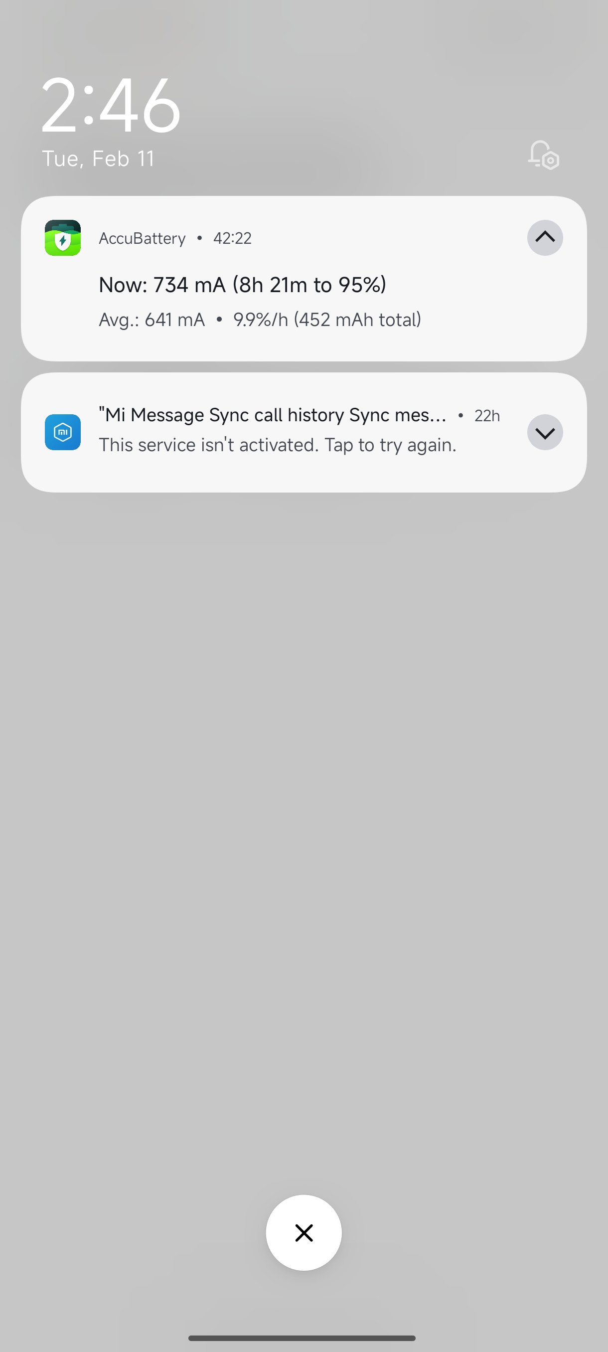

Has anyone had some issues with Turbo Charge (120W) on RN14P+? (amethyst)
It somehow doesn't charge as fast as it used to and won't show "120W charging", but "Quick Charging" only...
Tested on 3 official chargers and cables and with different outlets

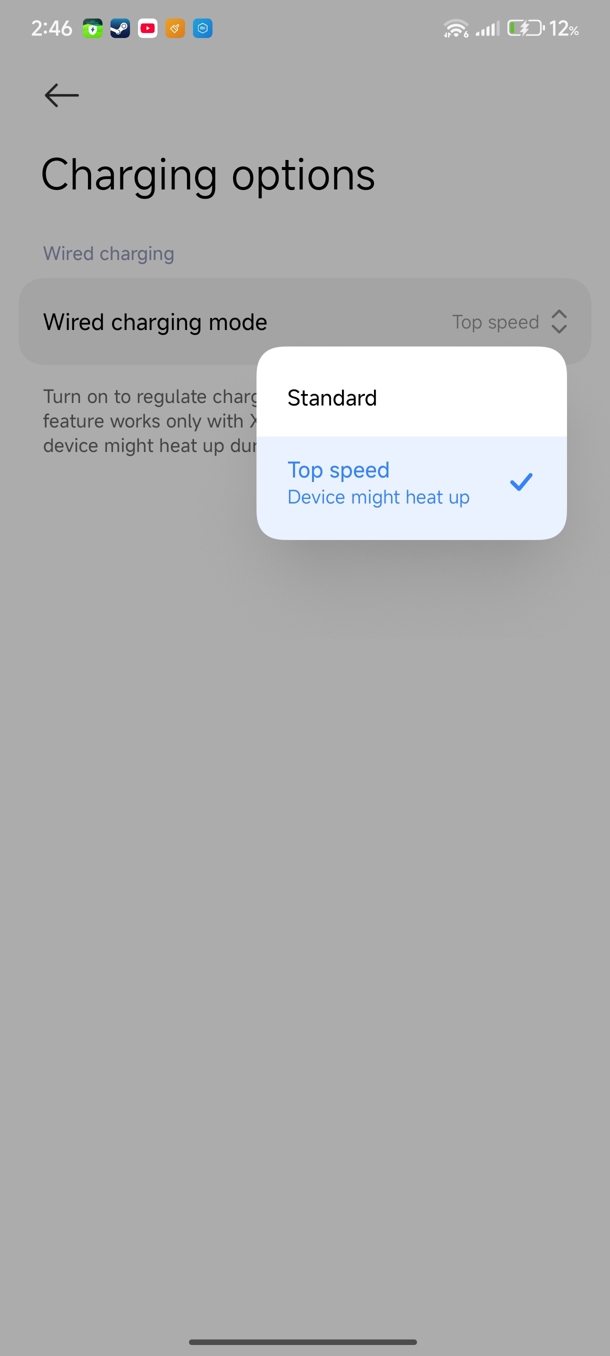

Did you set charging mode to "Top speed"?
Thanks for the answer. But sadly yeah, it's set to top speed. Oddly changing it to standard doesn't change anything, still says quick charging. Pic rel from settings and accubattery notif
Its normal that it remains on quick charging. The charging mode option only decides if it uses normal PowerDelivery ("Quick charging"), or Xiaomis turbo charging ("120W MAX").
Usually, if it doesn't use 120W mode, it means that it detects the cable to not be compatible with 6A. Have you tried cleaning your charging port?
If that doesn't work and you're sure that the cable is original from Xiaomi and 6A ready, last thing you can do is wipe cache and dalvik cache from TWRP.
