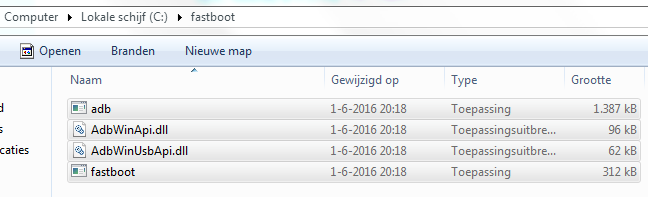

    cd C:\fastboot

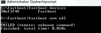

    fastboot devices
    30ef3f48 fastboot
    fastboot oem edl
    This is where I get the Fail part
    There is no real connection i guess
    Can somebody please help me to get everything the way it was or even better.

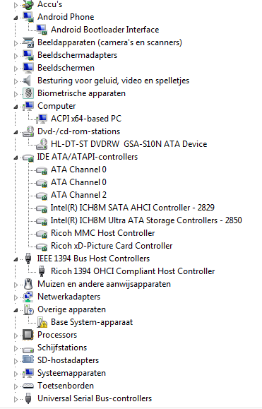

    Have you installed Qualcomm qloader drivers?
  10. SigNL
    SigNLMembers
    May 29, 2016
    7
    0
    11
    Male
    Yes the 32bit version but it doesn't show in:
    I restarted and tryed again.
