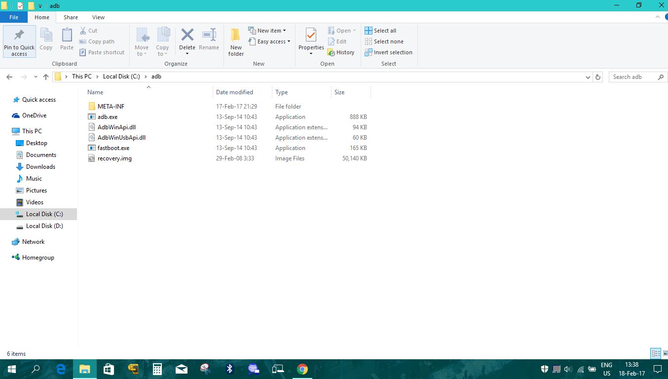

rename twrp.img as recovery.img , put recovery.img on C:\adb folder, after this open cmd from adb (Shift + Right click) when the phone is pluged on laptop and is in fastboot mode, type on cmd: fastboot flash recovery.img

guys, there is nothing wrong with the file
please make sure you install TWRP 7 in Android 7, that's all
I have the same issue and now it's resolved
