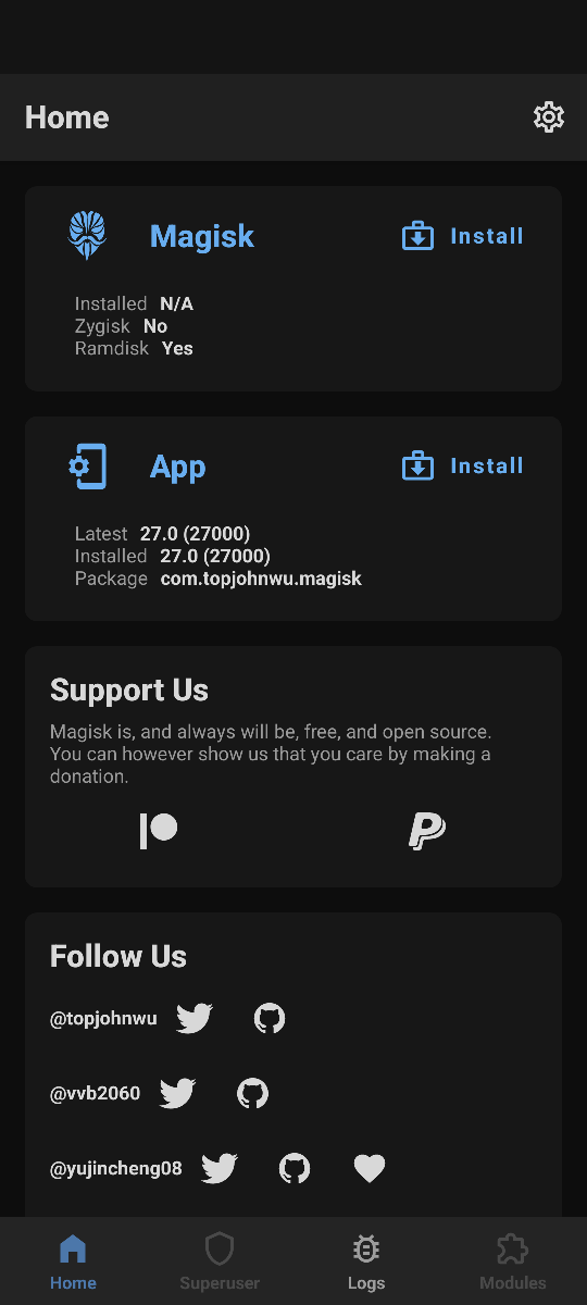

hi,
I followed the steps but after reboot, the magisk app is still not installed.
hi,
Magisk app IS installed - you posted the screenshot FROM Magisk app
However, Magisk (mask, service, whatever we call) is not installed, that's what Magisk APP shows: Magisk NA
So, what did you do - did you patch and flash the patched img, describe your steps. Nobody can help you without the detailed info

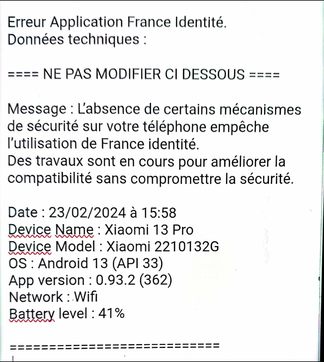

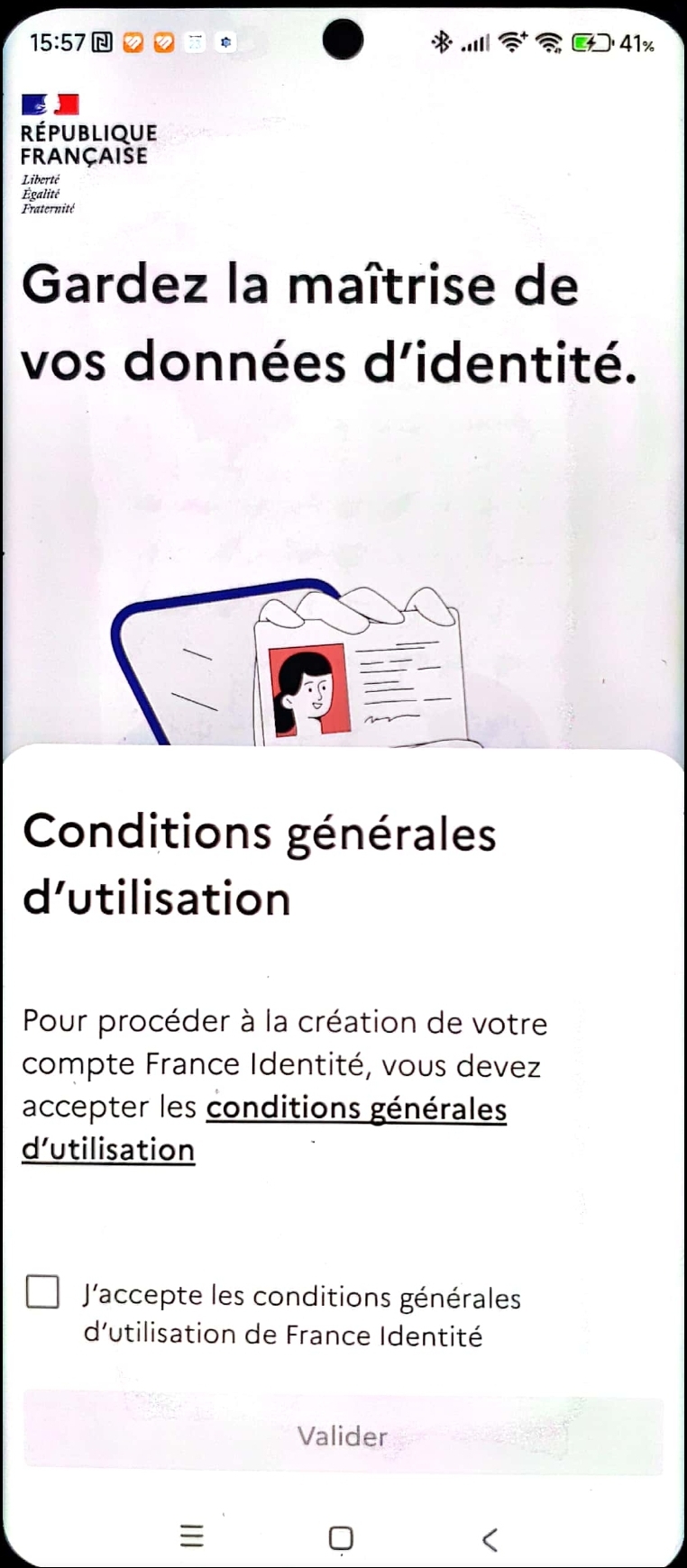

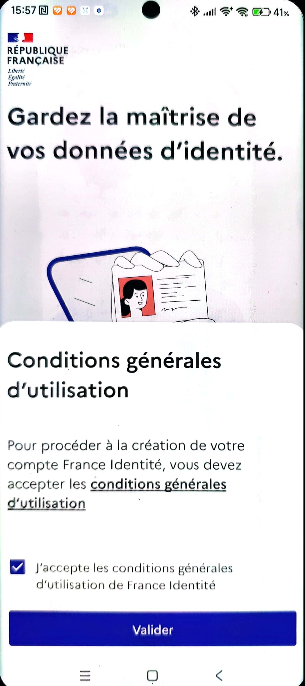

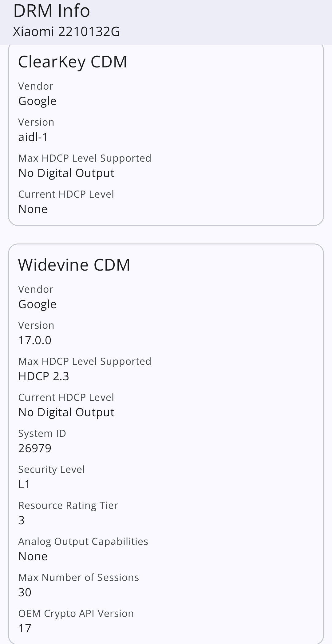

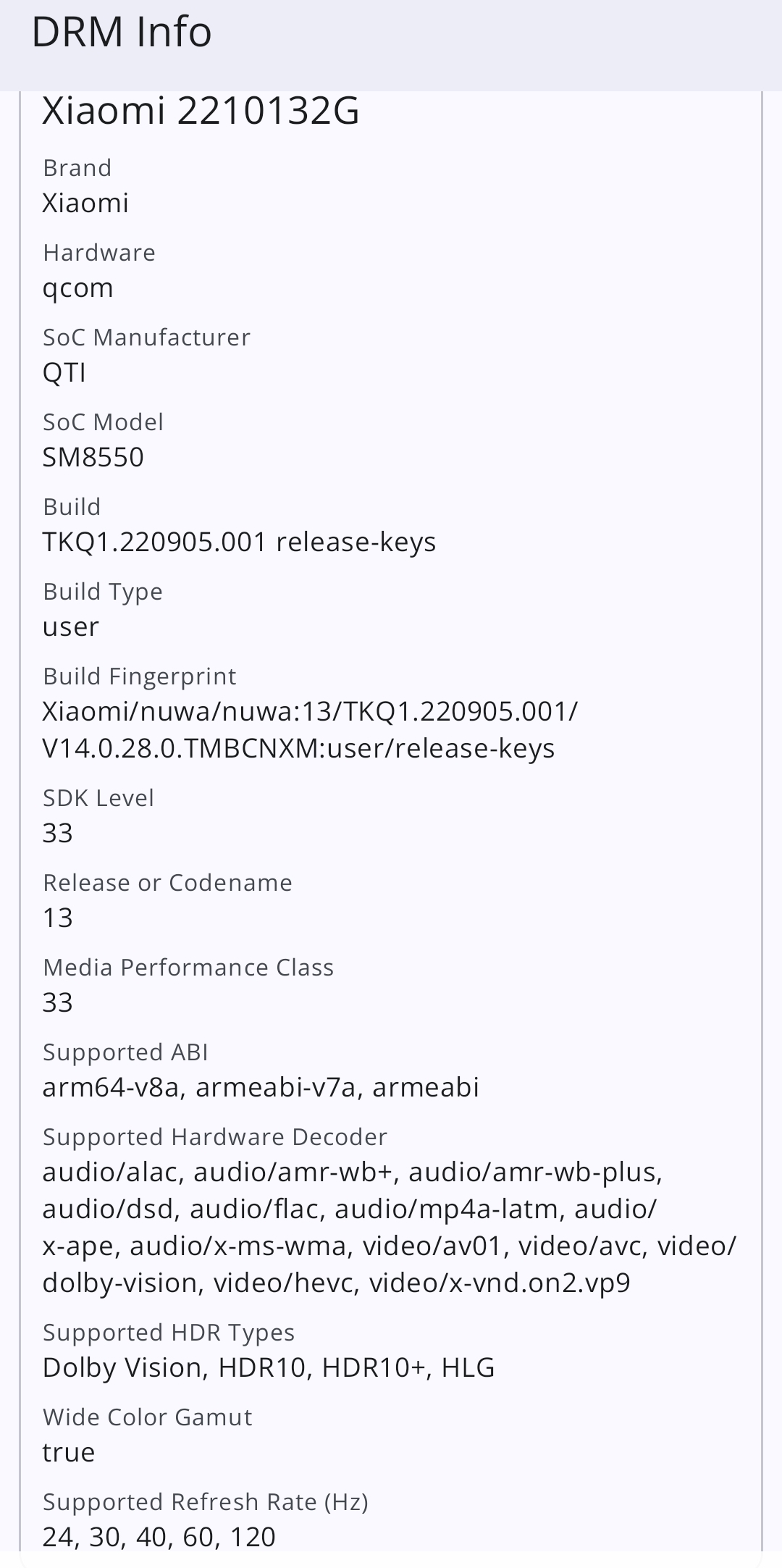

XIAOMI 13 Pro Xiaomi.eu MIUI 14.0.28.0 TMBCCNXM stable - Bug in the operation Install of the "France Identity" application​
Hello everyone
Help
Bug in the operation Install of the "France Identity" application which generates an error "The absence of certain security mechanisms on your phone prevents the use of France Identity
Smartphone Brand: Xiaomi
Model: XIAOMI 13 Pro
Rom: Xiaomi.eu MIUI 14.0.28.0 TMBCCNXM stable
Magisk 27.0
Zygisk: Yes
PlayIntegrityFix_v15.8
See attached screenshot
Thank you for your answers
Hello everyone
Help
Magisk 27.0
Zygisk: Yes
Thank you for your answersView attachment 51469View attachment 51473
THERE IS NO 'BUG'. That's the price of unlocking BL, installing custom ROMs, potentially rooting your phone
Various apps use various methods to detect the aforementioned modifications. If you're not ready to play that cat and mice game and to look around the forums and TG channels and to test and find solutions (what works today may no more tomorrow and you will have to search for new tricks and spoofs again):
- return back to stock ROM, stock recovery, unroot, everything official
- relock your Bootloader
and you won't have the problems anymore
Or look around, try various Magisk forks (Stable/Canary, Delta/Kitsune or Alpha), try with Zygisk or Zygisk-Next, try with DenyList, Unmount Modules, SU List, try LSPosed with Hide My Apps and maybe Bootloader Spoofer, etc.You French app maybe really looks for Strong Integrity (in that case only stock + locked BL will do) or one of combination from above will (temporarily) do the trick - but you have to find it or find somebody who found the trick and posted somewhere the how-to guide

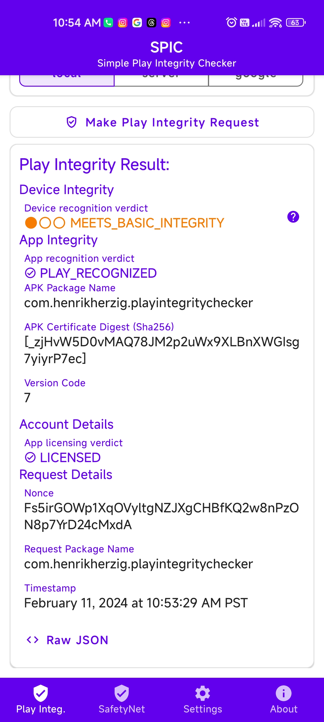

Before I completely lose my mind, please (PLEASE) help me troubleshoot the reason why i'm not passing device integrity.
I have flashed the stable HyperOS rom on my garnet and the device was not certified.
I have updated the GPay Module apk and the device still was not certified.
So these are the steps I took:
1. Installed latest Kitsune Magisk (v27)
2. Enabled Zygisk and MagiskHide
3. Installed latest Play Integrity Fix (this automatically uninstalled the inject apk, as stated by OP)
4. Installed playcurl
5. Installed AutoPIF apk
6. Used AutoPIF to download a fingerprint
The device was still not certified.
So:
7. Cleared Google Services Framework, Google Play Services, Google Play cache and data
Device still not certified
8. Added Google Services Framework and Google Play Services to MagiskHide (I hid the gms process)
Device is now only passing MEETS_BASIC_INTEGRITY but did not pass MEETS_DEVICE_INTEGRITY
I wonder if the problem is that I have flashed a modem from latest EEA firmware as the one included in the stable release did not work with my SIM.
The fingerprint from the stable release is Xiaomi/garnet/miproduct:14/UKQ1.231003.002/V816.0.1.0.UNRCNXM:user/release-keys
9. I tried changing the fingeprint with MagiskHidePropsConfig (I used a certified fingerprint from the list)
Still can't pass device integrity.
Some guidance will be greatly appreciated.
At the very beginning, all you had to do was clear "all data" from the Google Play app and restart the device. You don't need any wilds and root.
- Uninstall all modules from Magisk
- uninstall root (Magisk) or install the ROM again as an update
- Clear all GPlay app data
- reboot the device.
- done
Thanks.
That was done, i just left all of the clear/reboot cycles out of the list. I still was not able to pass.
Also, i needed root anyways.
What i have done is:
1. Remove gms from the hidelist (I only kept com.google.process.gapps enabled)
2. Reinstalled the GPay module
3. Clear caches/data + reboot
I'm now passing BASIC.
I don't which of those made it work, but at this point i'm keeping both PIF and the GPay module installed. I just hope they won't clash with each other at some point.
EDIT: Although the device is now certified, Google Wallet crashed with "unable to set active account". I wonder if i have to use some shenanigans like the SQLite fix as i have messed with the device fingerprints
EDIT 2: Found a solution on this forums. It looks like it wasn't related to device attestation at all
P.S.: I also removed com.google.process.gapps from the hidelist. Zygisk should take care of gms so you won't need to hide any Google process. Wallet is not hidden as well.
