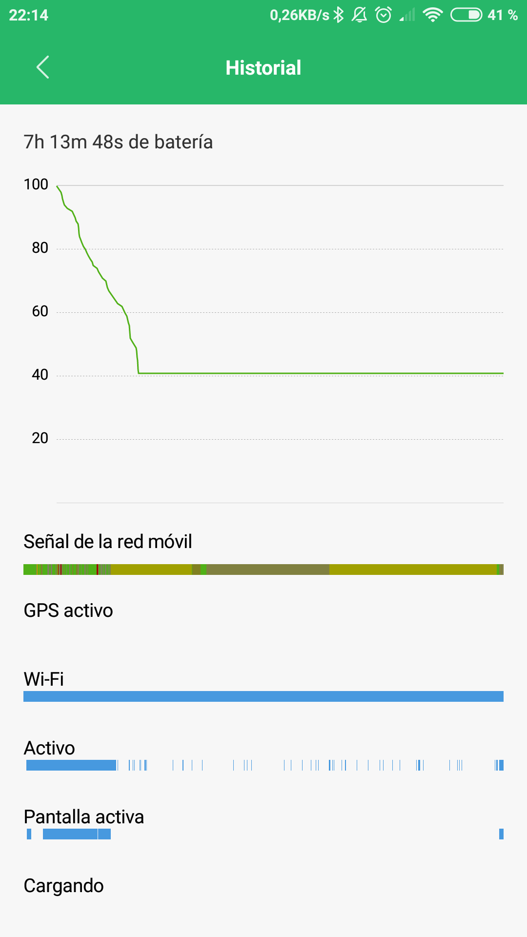

I still having the same issue with my battery. I've tried:
-Full discharge (even when the phone turned off, I turned on again and again and again)
-Then opened TWRP and the battery icon was at 0%. I turned the screen to not turnoff and set the brightness to maximum. The phone was at 0% for like 30-40mins and then shutdown. I was unable to turn on it again
-Full charge it again, using a slow charger and leave it poweroff. The battery indicator jumped from 0% to 1-2-3-4-5-6-10% in like 5-10 seconds, so I think something is wrong.
-I let the phone to full charge and turned on. Nothing changed.
Yesterday I updated to Miui10 with the hope this was something related to the ROM (which I think is not, because I've updated too many times) and the issue persist.
Here are 2 screenshots from yesterday.
