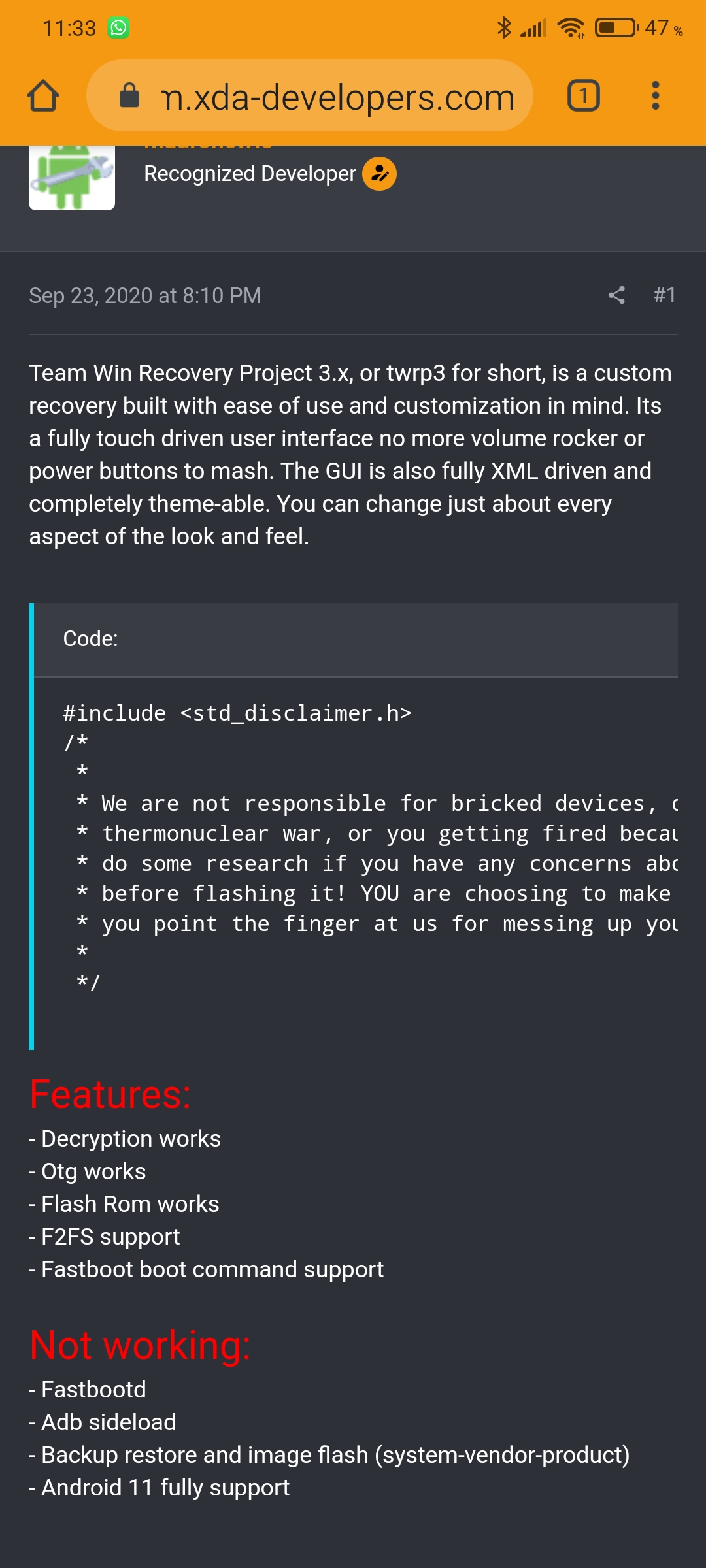

...working TWRP...
and V11 ROM...
Tapatalkkal küldve az én M2002J9G eszközömről
Both of them are problems.
TWRP: Because data is encrypted and nothing works to decrypt on Android 11, even the dfe zip. This is known because the stock ROM with Android 11 can be rooted but only if you format data or flash files via OTG.
ROM: That's it. That .eu ROM is faulty. Some things don't work well and the stock ROM works without any problem.
