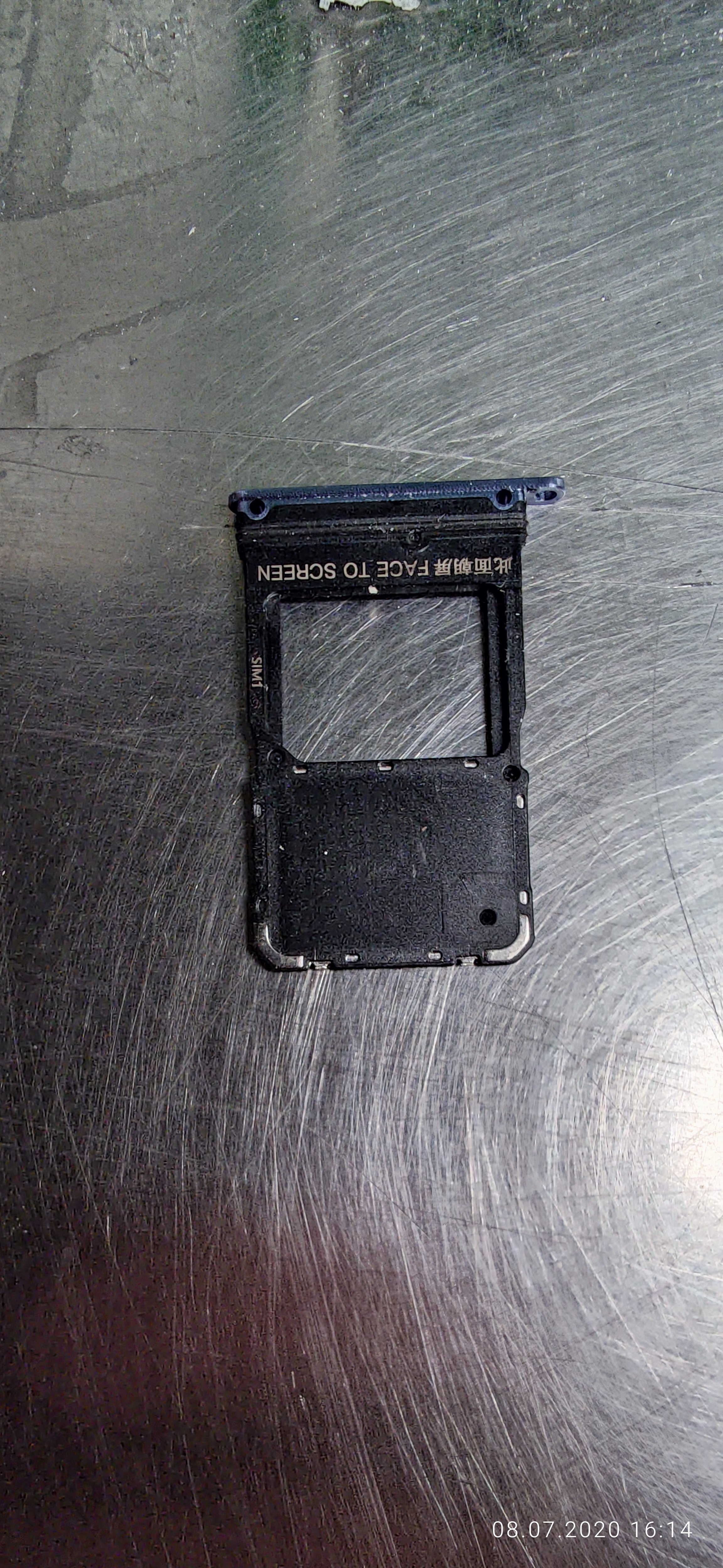

Can confirm dual SIM works. I've ordered a SIM tray from AliExpress, running miui 12 weekly on mi 10 and dual standby by works like a charm!

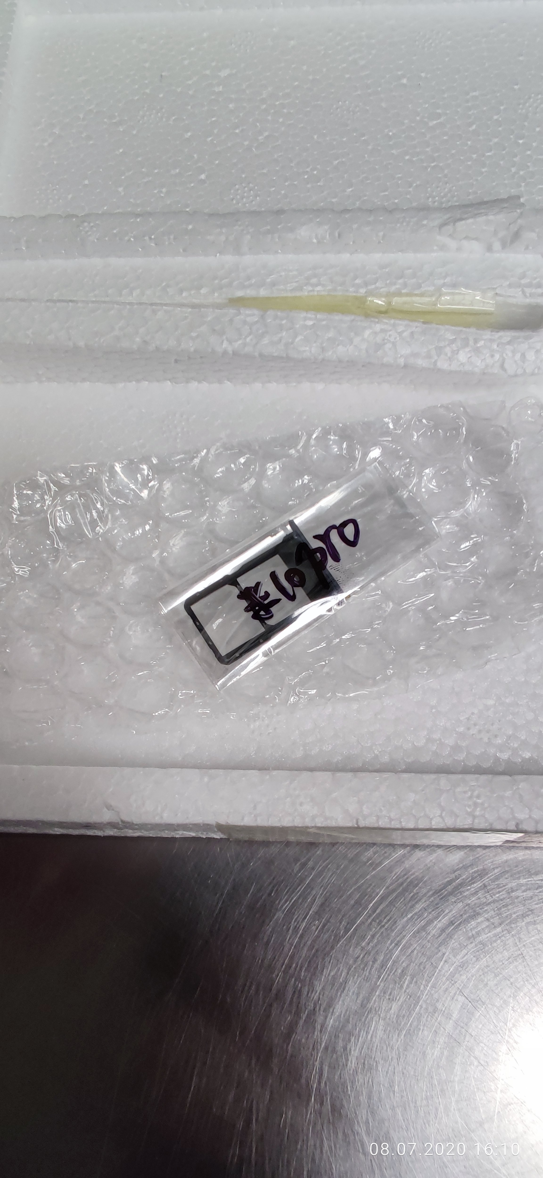

IMG_20200708_161433.jpg global single
IMG_20200708_161041.jpgglobal dual

Thanks for the info, I've just got my dual SIM adaptor works a treat on my global mi10.

I spend around 3 hours to modify the sim trail in order to put inside my 2 sim cards.
And I confirm that the 2 sim cards work great in a Global Mi 10 ( with b20 band and only 1 sim) flash with Xiaomi.eu rom.
Champagne .
No need to buy the china version, just the global one and a double sim trail.View attachment 29285
