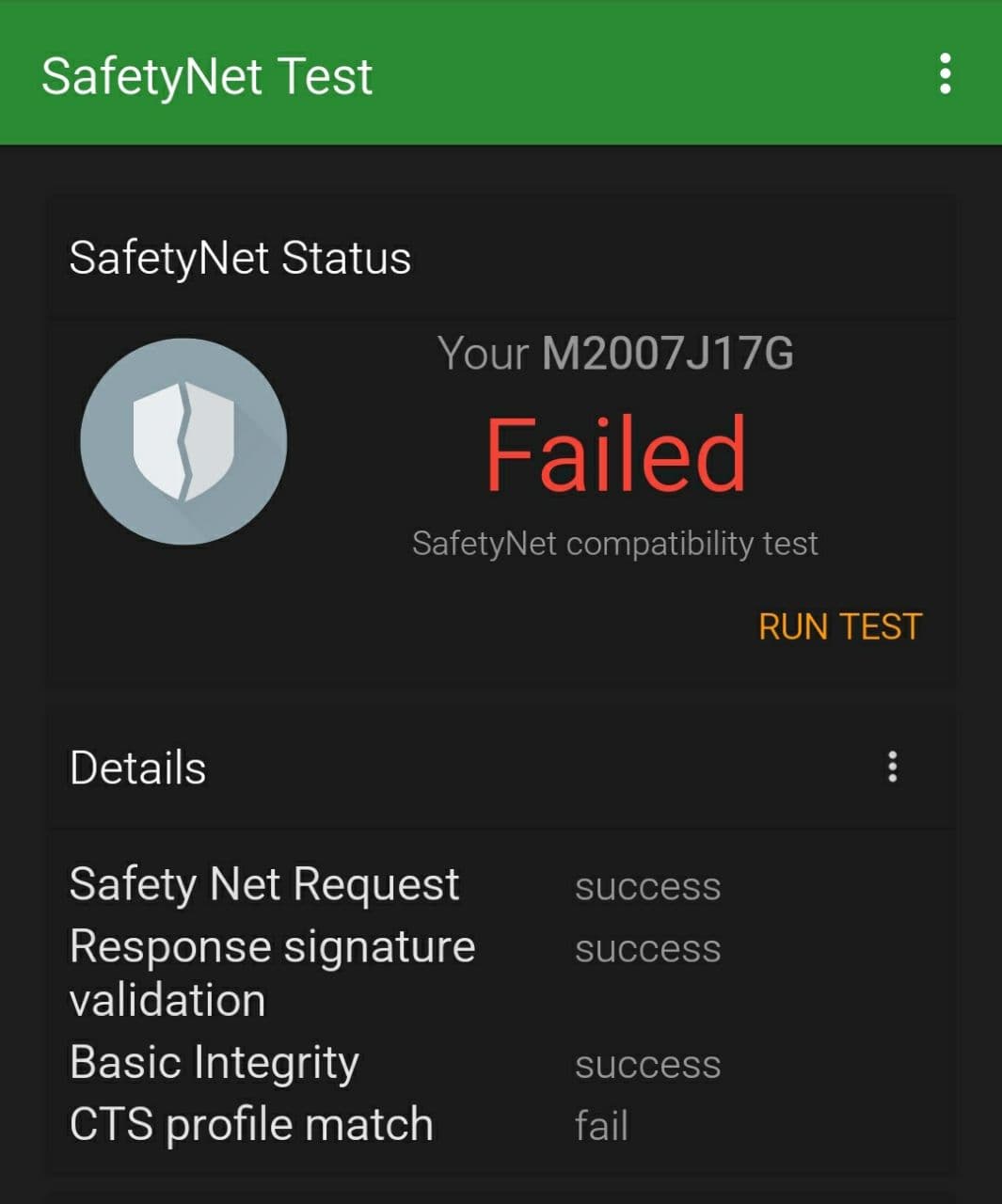

Hi all, I have finally installed Xiaomi.eu (stable V12.0.6.0.QJSCNXM) on my Mi 10T Lite. Widevine is L1 :).
However, my SafetyNet fails and Google Play says my device is not certified.
I did clear data of Google Play, Google Play Services and Google Service Framework and rebooted . My device was certifiied for about 15 minutes. Now it reverted again to not certified.
Since the 10T Lite doesn't have TWRP yet, I dont know how to fix this problem. I prefer to not have root and magisk tho.
Can anyone help me? Thank you in advance!
Edit: i checked with the magisk app. evalType is BASIC.

Have you tried to rename your Magisk Manager and turning on magisk hide ?
Sent from my Redmi K20 Pro using Tapatalk
I only have the Magisk manager apk installed. No root or flashes because there is no TWRP for my device.
I uninstalled the magisk manager and deleted the 3 google data. My device is certified again, but still not passing the SafetyNet check.
You gotta use Magisk props module , so i would suggest rooting .
Google added a new method (=evalType) for some devices (based on the device name set by "ro.product.model" prop in /system/build.prop) named "Hardware attestation" since June, 2020. No bypass method is theorically possible if your bootloader is unlocked but like @innerTide said, you can avoid this new method if you enable "Force 'Basic' attestation" with MagiskHide Props module or simply edit "ro.product.model" prop
