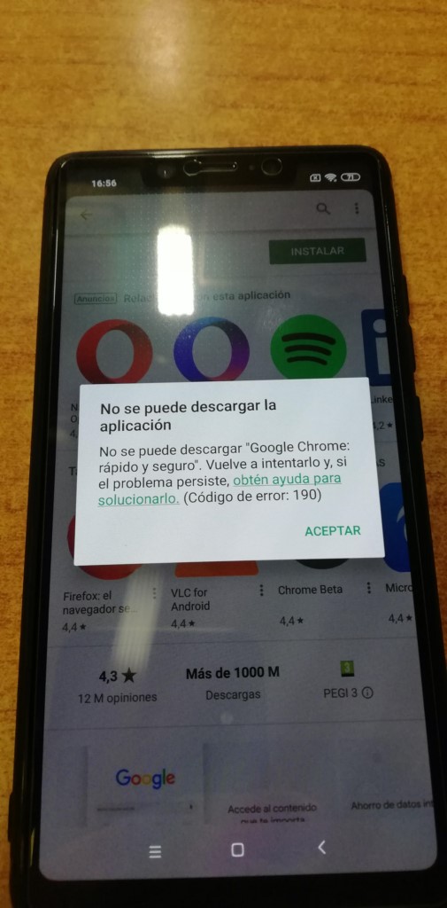

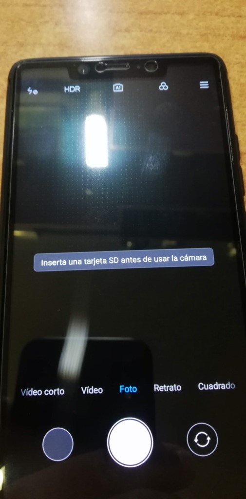

Hi. I'm writing with the google translator, I'm Spanish and I do not speak English, I'm sorry if you do not understand something.

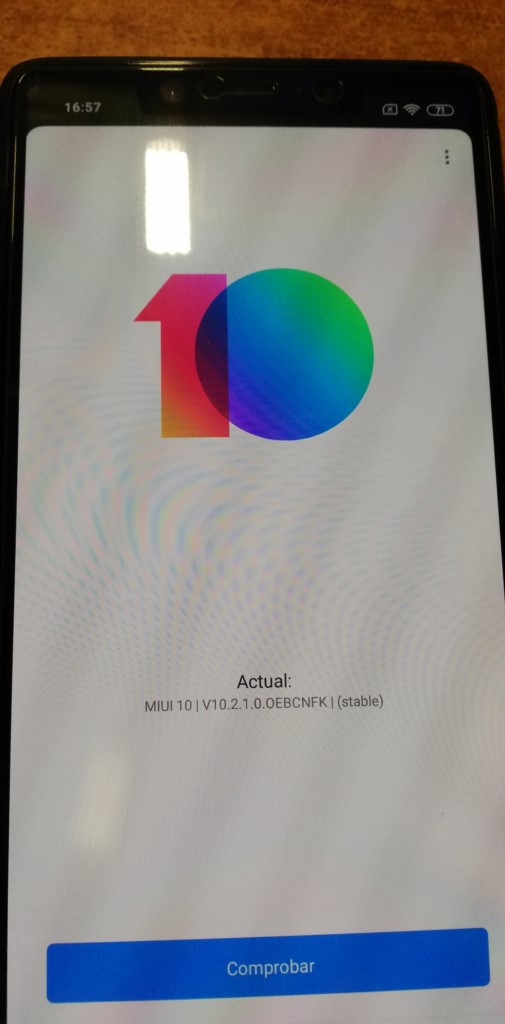

I installed in an MI 8 SE, the rom MIUIv10.2 STABLE. I have had 2 problems:
When I open the camera, it says "Insert an SD card before using the camera", and this phone does not have the option of inserting an SD, and I have not been able to change the option to save in internal storage. Then I do not have a camera.
Also, there are several Google Play applications (Chrome, Garmin connect, etc ...) that are not installed. I get a notification: "Error code: 190".
Can you help me?
Thank you.
IMG_20190201_165705 [1024x768].jpg IMG_20190201_165644 [1024x768].jpg IMG_20190201_165628 [1024x768].jpg

The version that I have installed is this: xiaomi.eu_multi_MI8SE_V10.2.1.0.OEBCNFK_v10-8.1.zip
I do not know if it's stable or stable official, I'm sorry. :rolleyes:
You're right, the post I mentioned is not for your device, but the tip is a general one for all devices: Did you try a full wipe?
You don't know, if you are using a stable or a weekly ROM? You just install the weekly and stable ROMs wildly? Then don't be surprised if apps have failures. By switching from weekly to stable a full wipe is always recommended to avoid issues.
P.S.: xiaomi.eu_multi_MI8SE_V10.2.1.0.OEBCNFK_v10-8.1.zip >> that's the stable ROM from xiaomi.eu.

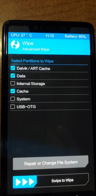

In the installations I have cleaned both factory reset and Dalvik / Data / Caché. I have not wildly installed some ROMs on others without cleaning.

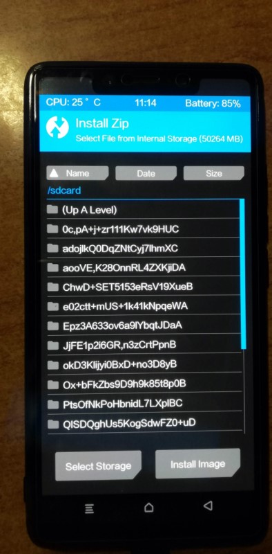

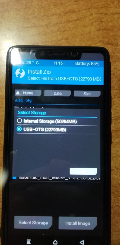

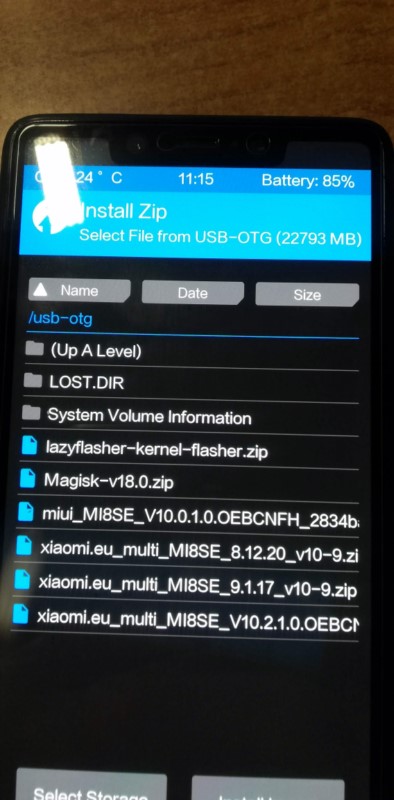

IMG_20190202_041222 [800x600].jpg IMG_20190202_041351 [800x600].jpg IMG_20190202_041452 [800x600].jpg IMG_20190202_041504 [800x600].jpg IMG_20190202_041521 [800x600].jpg

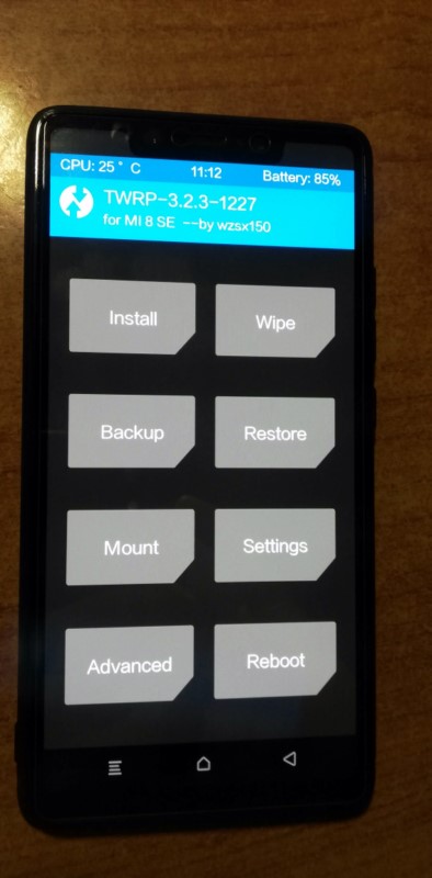

View attachment 23145 View attachment 23146 View attachment 23147 View attachment 23148 View attachment 23149
Greetings.
Now I understand your issue!
1-Your phone is encrypted so next flash have to be done after FORMAT DATA and not only wipes!)
2- you must reflash twrp 1102 or 1217 in order to flash miui eu rom. I see you have 1227 installed and this is to be used ONLY after eu 8.12.27_v10-9 installation. that's what I told you.
Your phone is like mine and many others, so you should succeed.
edit:
- format data
- flash 1102 twrp
- reboot twrp
- flash miui eu dev rom you want
- flash twrp 1227 BEFORE booting the rom if you flash a rom younger than 8.12.20!!! that's why I suugested you to do before to avoid lost of twrp if you reboot direct the newest rom.

You format data in TWRP in the wipe section. in it two options "avanced" and "format".
WWWWOOOOOWWWWW
Both the camera and the google downloads work. :D
It was for not having formatted, and only wipe.
I am eternally grateful for your help, both for your advice and for the speed with which you have helped me.
Thank you. Thank you. Thank you. ;)
