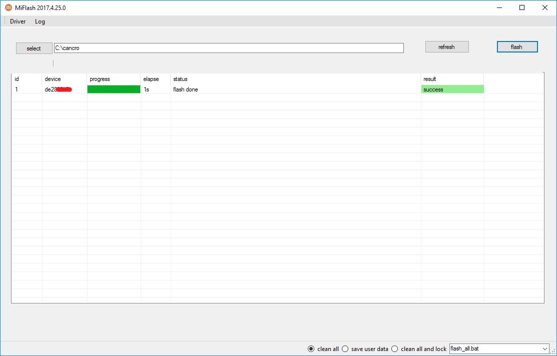

I wan't to flash my Mi4 with global stable ROM (at the moment I have xiaomi.eu weekly 7.5.11). I tried the fastboot method but flash ends in 1sec, says: success, and then I'm stuck with bootloop so I can only install twrp again and the same weekly to get it to work.
Why can't I flash global stable?
Tried: making the map name shorter, putting it on c root, desktop... tried flashing both global stable and global developer...
EDIT: Solved by flashing with older version of Mi Flash tool.
Hi ivo.hr,
I have exactly the same problem as you do (or did). Could you please describe precisely what steps did you complete to resolve it? And could you share a link to the version of MI Flash that has finally worked for your problem?
Great thanks in advance!
Yesterday I faced a similar problem in a friend's Mi4.
In the past, I flashed:
- Official fastboot image through fastboot;
- Flashed TWRP;
- Flashed Xiaomi.eu ROM.
Then, my friend said to me: "My phone is having some issues, so can you fix it?".
I said yes and tried to perform the steps above.
MiFlash returned the "Done" and "Success" information,but it took 1 second and the phone did not boot.
I entered TWRP and flashed Xiaomi.eu latest Stable version.
It worked great.
So, something is definitely wrong here.
Whether it is the fastboot image or the MiFlash software.
I just did not have the time to debug it...
