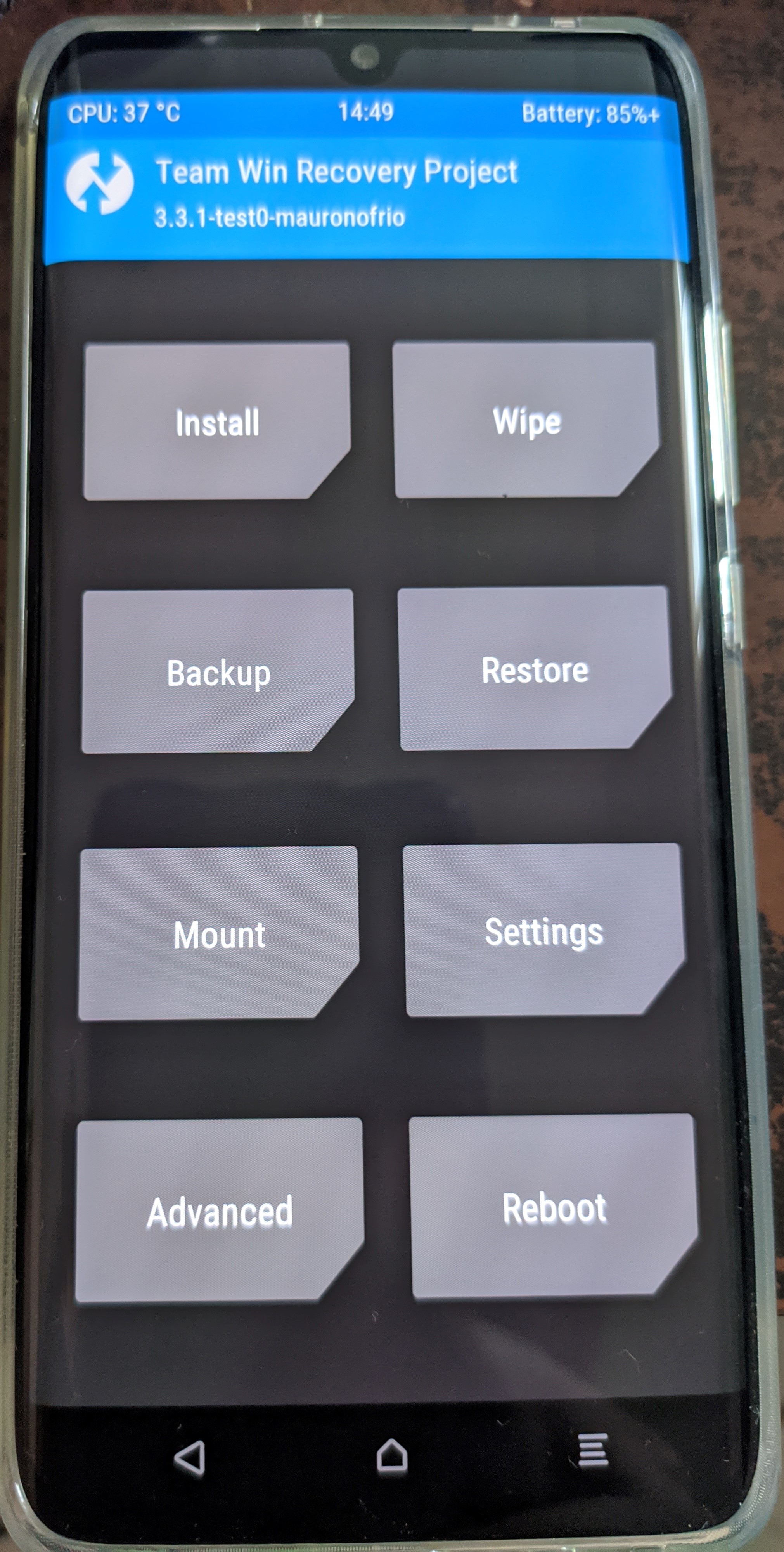

Thanks for the link, but this Twrp version is still a test version and so the viping and flashing is not yet possible, but I have written with Mauronofrio and at the end of next week there will be a new test version of TWRP, but if the flashing and viping will work I can't say.

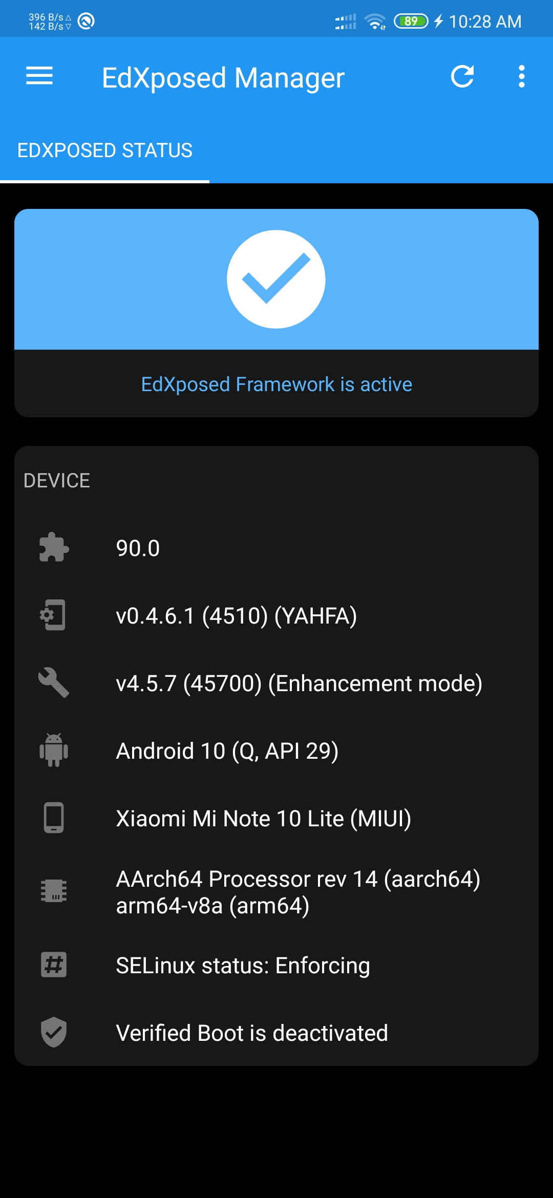

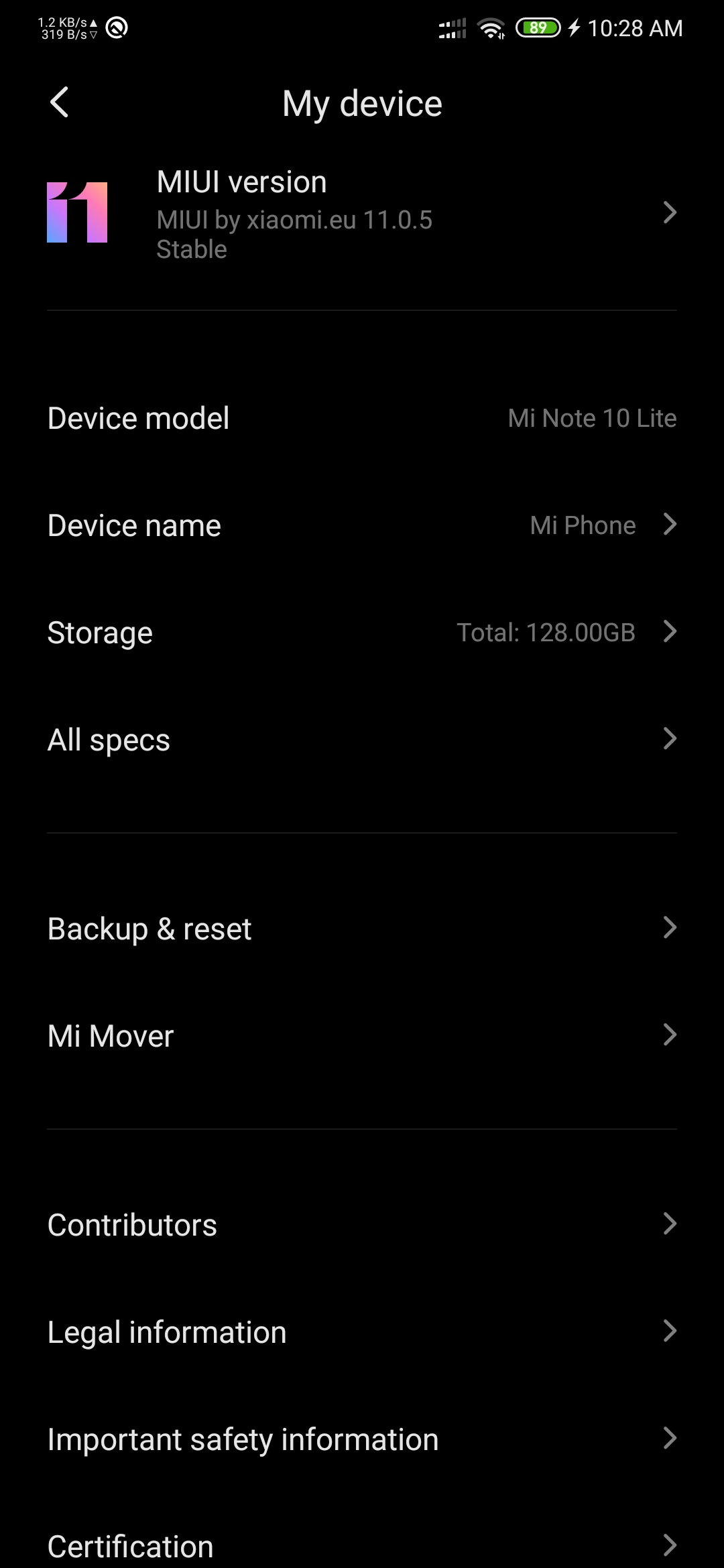

Done
Flashing 11.0.5 successfully
