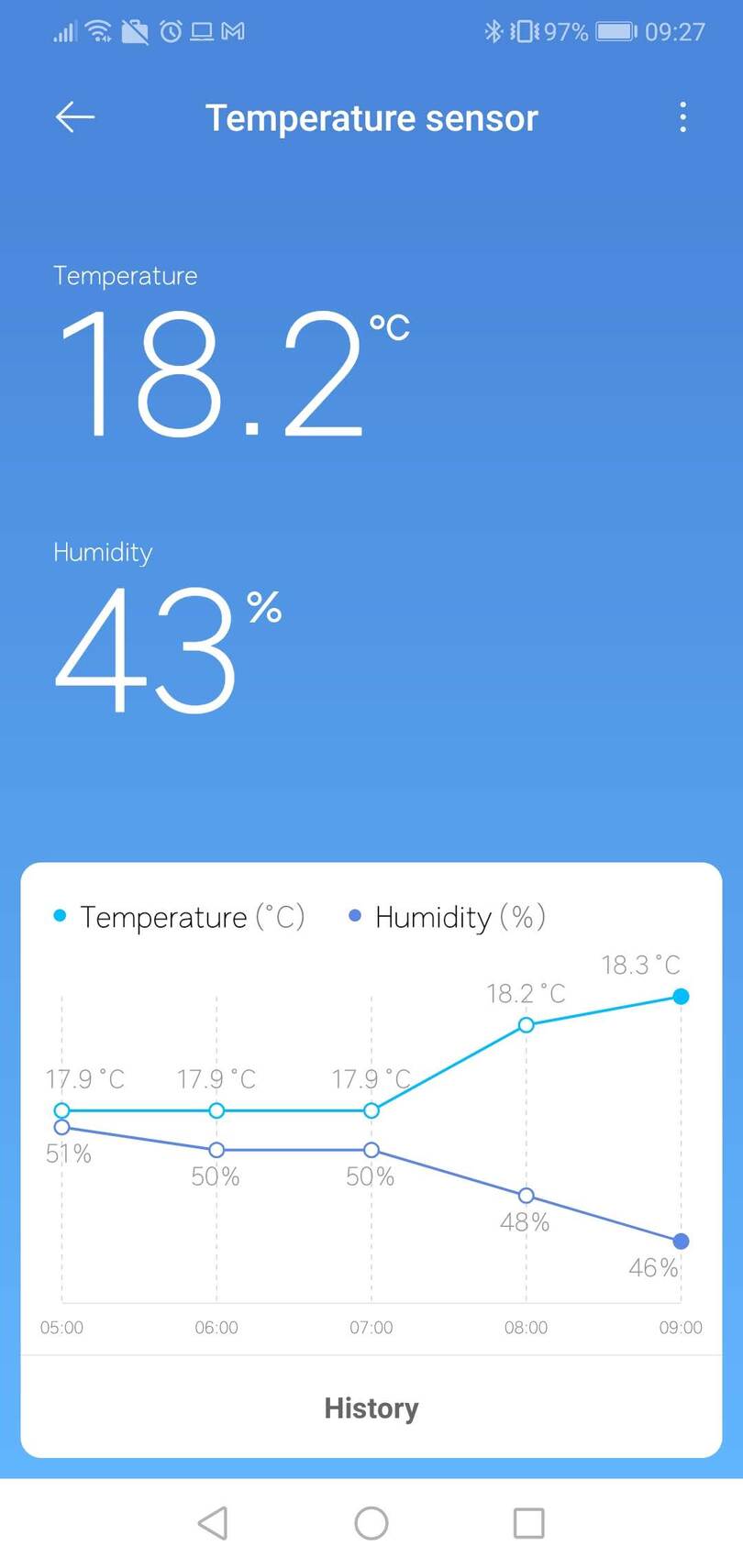

I'm also still facing two issues (one is new).
My Setup:
- 4 Xiaomi Hygrometers (the round ones with display) located in different rooms
- 2 Xiaomi bedside lamps (the one with BLE Gateway)
Both lamps detect all 4 sensors via the BLE Gateway (with different signal quality) and I am able to see sensor data from outside my network using the mi home app.
Everything works finde for more than a year now (with some issue times already discussed hear). But what never worked was the monthly and weekly history charts. Anyone have them working and a idea how to get them to work?
Second Issue:
The daily history chart has an offset of 16 hours.
The last Value I can see is 15:00 when it is actually 07:00 the next day.
Someone has a fix for this issue?

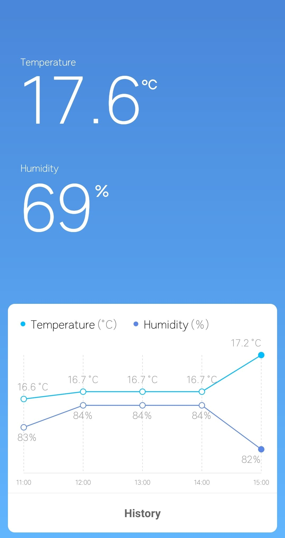

I have two devices Mi Temperature and Humidity Monitor 2. Everything was fine at the beginning, but now the history registry just shows values that do not correspond to the actual values on the devices:
34586
Today, the humidity level has been always lower than 80, yet it logs different levels from the real ones, as you can see, both temperature and humidity.
Has this happened to anyone here? Any solutions?

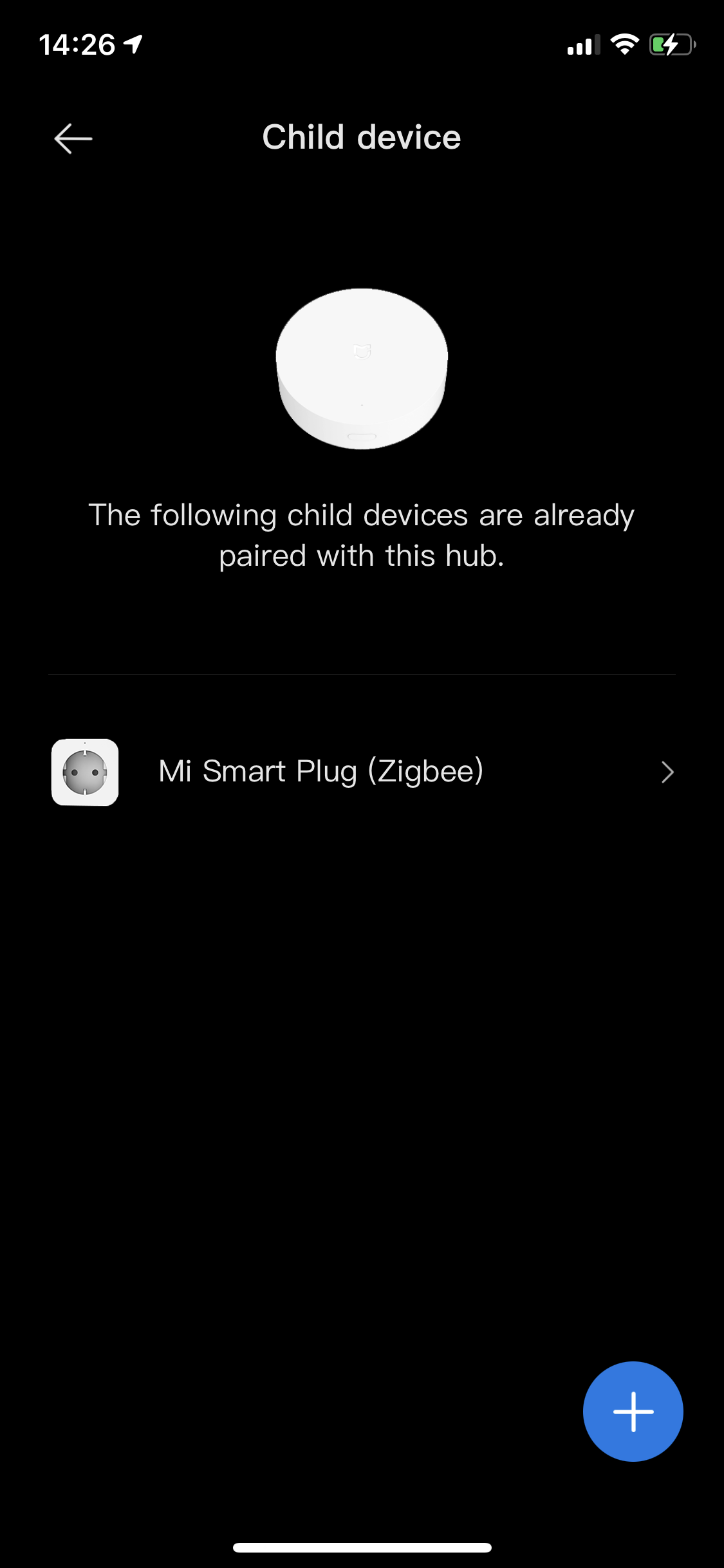

Hello I’m having a problem with the sensor...the gateway says it’s connected and sees the device but there’s nothing under child devices and when i click in the humidity sensor it says enable Bluetooth..I can’t control or see the accurate temp and humidity in the app...I don’t know what’s wrong please help
I faced the same issue... In my casethe fix was to change a setting i forgot i changed for testing.
Profile -> experimental features -> disabled forced ble gateways.
I hope it helps

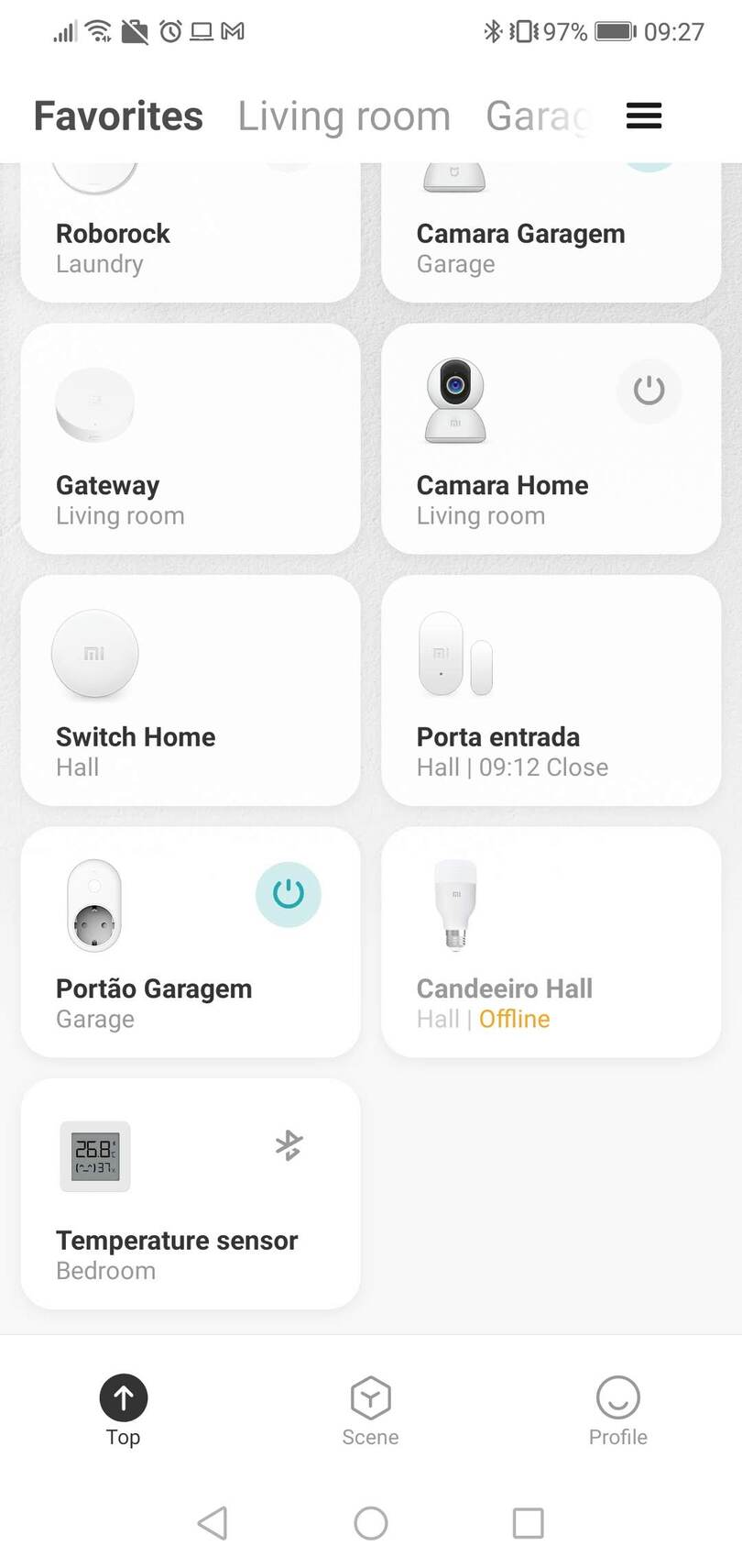

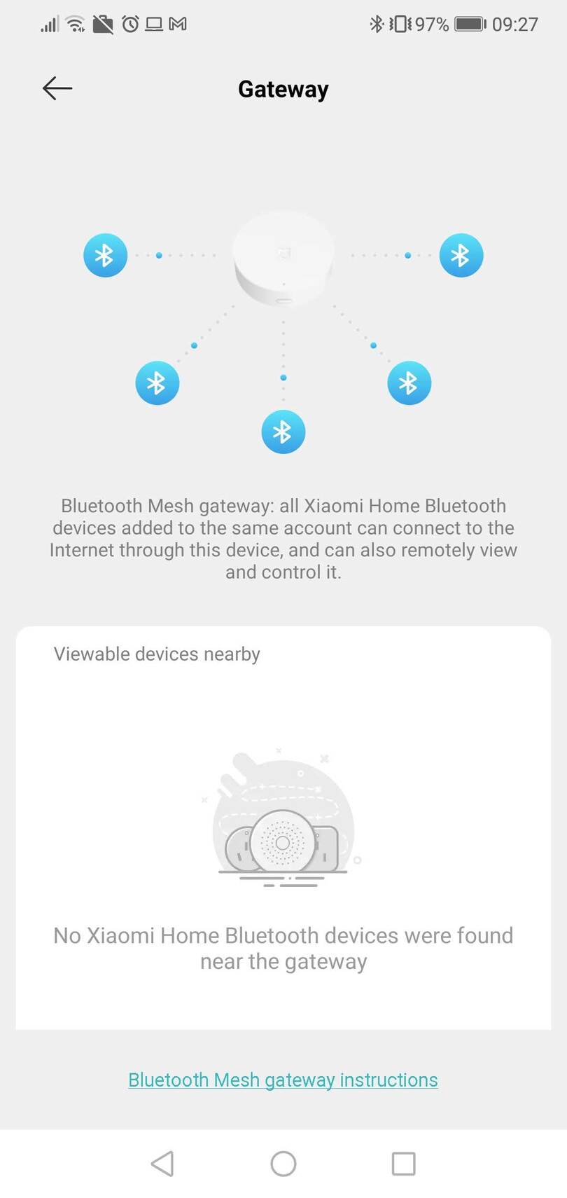

Hi everyone,
I just bought a xiaomi gateway (v3) and a couple of Bluetooth Temperature and Humidity sensors.
I cannot get the Gateway child devices to list the Bluetooth sensor :(
I'm using the Xiaomi App with Portugal region where I have other devices.
I can see the Temperature sensor if I try to associate directly with the phone but not with the gateway.
Any help?

Hi everyone,
exactly the same issue here: I cannot connect the Gateway v3 to devices to the Temperature and Humidity sensor via Bluetooth.
Seems that is an issue since October...
There is no update for this?

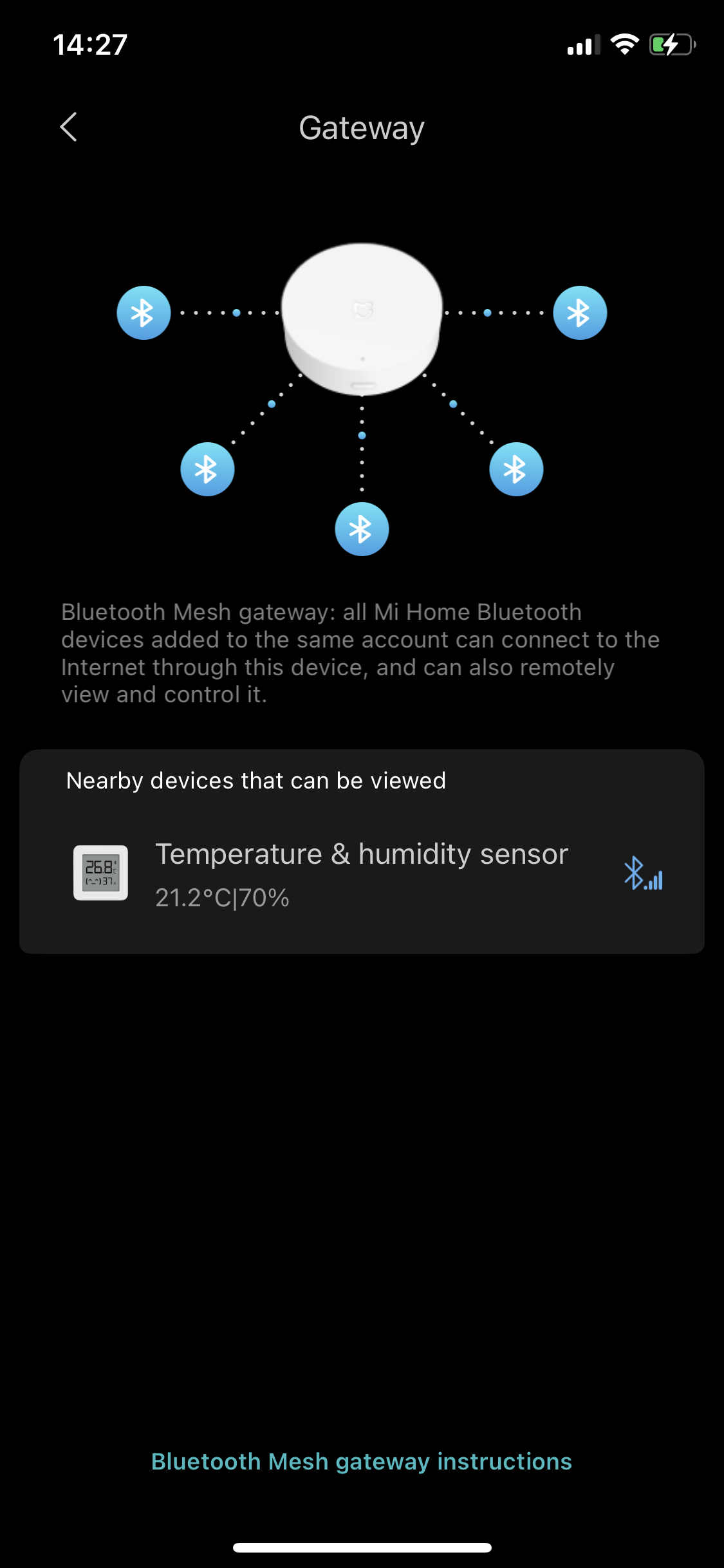

Actually, I was explained that you first add the Gateway and the Bluetooth temperature sensors into the phone. After 10-15m they will show up as child devices on the Gateway mesh feature. So you can try this, should work.
Thank you for your feedback @dapspt . Unfornutelly I already updated every device, I already did everything and I don't have success. Attached, the screenshots that show the Temperature Sensor connected to my account/phone and then, the Bluetooth catch-up screen where does not appear any BT device to connect as a child.
Does anyone with some news on this?
- Is the Gateway within BT range of the devices?
- Select the Gateway and go to Settings -> Additional settings -> Gateway bluetooth mesh: Ensure the mesh is enabled.

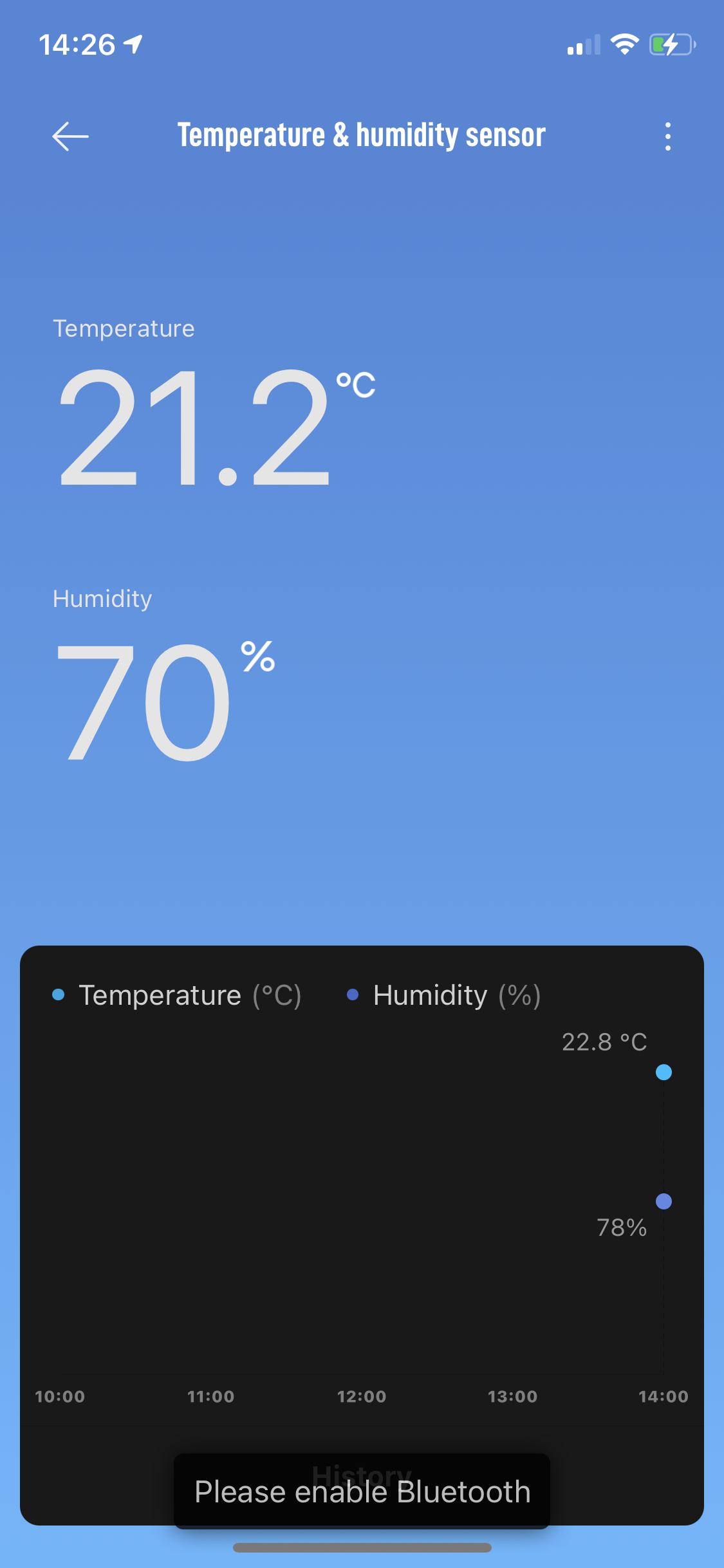

Check you app guys! I can finally see the temperature and humidity sensor through my Yeelight Ceiling Light BLE Gateway.
how? what is yeelight ceiling light ble gateway.... sorry i am new to all this . I own 2 Xiaomi Mi Bluetooth Temperature and Humidity Monitor v. 2 which is bluetooth as you know, and I was hoping that the Xiaomi Gateway 3 would work with it. please confirm this for me. Thanks
Hello I own 2 Xiaomi Mi Bluetooth Temperature and Humidity Monitor v. 2 which is bluetooth as you know, and I was hoping that the Xiaomi Gateway 3 would work with it. please confirm this for me. Thanks
I have everything set up via Xiaomi gateay, but when sensor reaches set temperature, it doesn't turn off the selected Xiaomi socket plug... Any idea why? Using default Xiaomi home app. Tnx!
Guys, I've been told that sync timeout between sensor > gateway is 10 mins. It means data is transmitted not onlin but each 10 mins. It explains a lot
