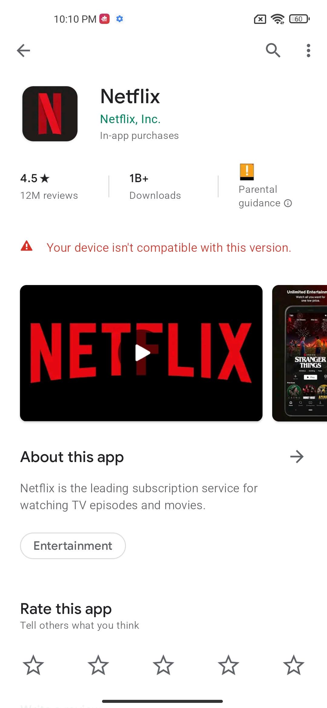

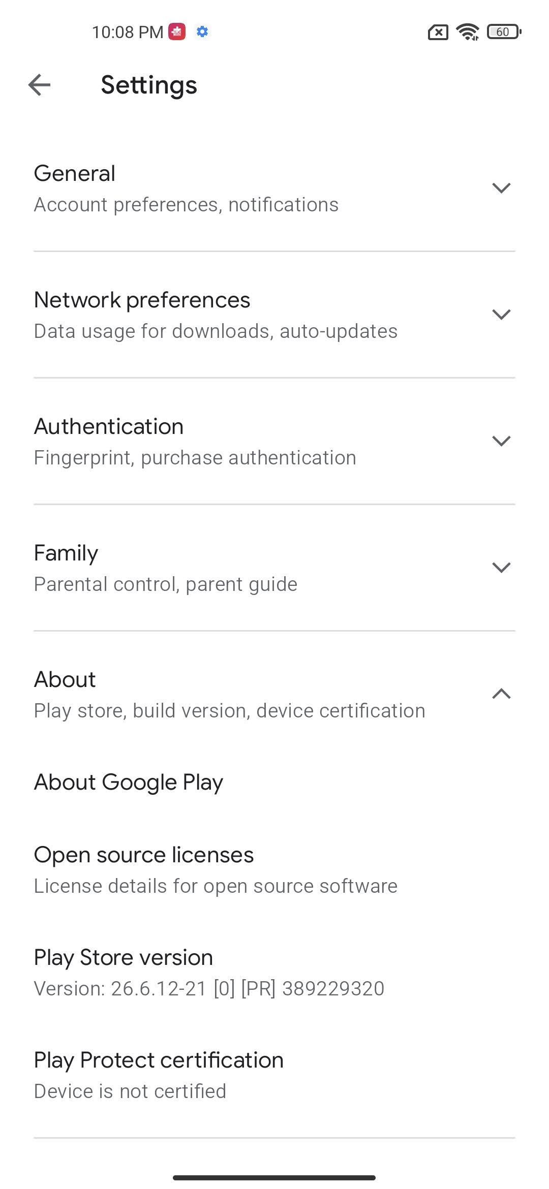

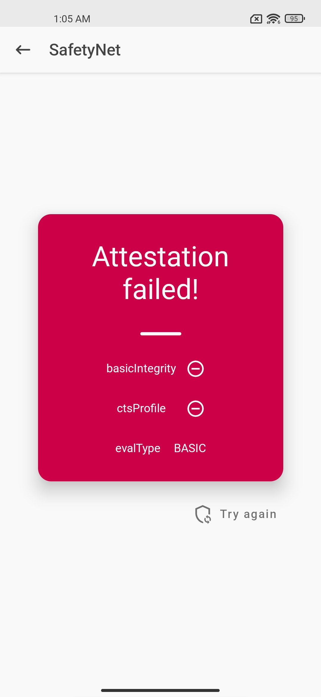

Yesterday I installed on my Mi 10 the newest stable version of xiaomi.eu (V12.5.8.0.RJBCNXM).
Unfortunately in my case the phone seems to no longer be certified on Google Store (Play) also Netflix cannot be downloaded and I was not able to use phone for payments using Google Pay.
On SafetyNet test the CTS profile match was failing.
Right now I have flashed Indian stock firmware and I locked back the bootloader (the phone is now certified, the CTS is passing) but I'm not satisfied by this stock firmware being forced to have dual sim support and also I need to be able to pay with my phone trough Google Pay and Revolut (I don't have my physical card any longer) :(
I really don't know how to proceed to flash back the xiaomi.eu custom rom and to have it certified easily without too much hassle. Yesterday I tried the steps suggested on another post on this forum, but without success: https://xiaomi.eu/community/threads...-failed-redmi-k30-pro-zoom.57923/#post-567224
I had previously 12.5.7.0 and I upgraded trough twrp to 12.5.8.0 but I saw that the SafetyNet is failing and the Google Pay disabled the contactless on store payments.
Then I flashed the latest EEA full stock firmware trough fastboot, without bootloader locked the phone is not certified, I locked back the bootloader then the phone appeared as certified.
In the end I tried again to flash the xiaomi.eu, unfortunately with same negative results.

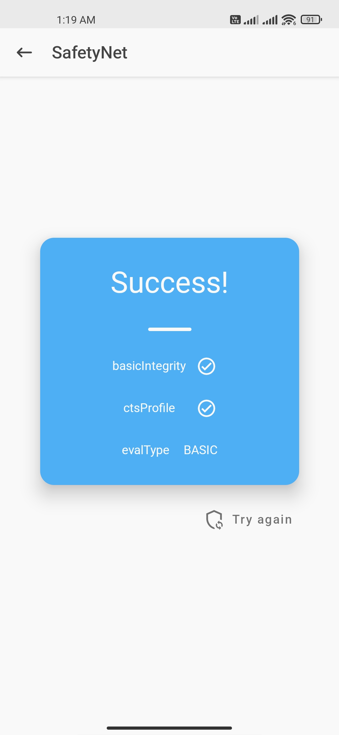

You followed an old workaround (already included in recent Xiaomi.eu ROMs)... ^^
My new workaround is posted here: https://xiaomi.eu/community/threads/21-9-1.62961/post-626475
Reactions: ciubex
I refuse to believe it was that simple :)
1. Flash firmware
2. Flash Magisk
3. Hide Magisk
4. Flash Fix_CTS_SafetyNet_v1.0-Magisk.zip posted on your post (link)
Many thanks @Poney70 :cool:
So, I'm back on xiaomi.eu stable v12.5.8.0 and all seems to work properly, actually with a minor change, the device name (model name) is "Xiaomi devices" due to your fix (modified system.prop)
1. Flash firmware
2. Flash Magisk
3. Hide Magisk
