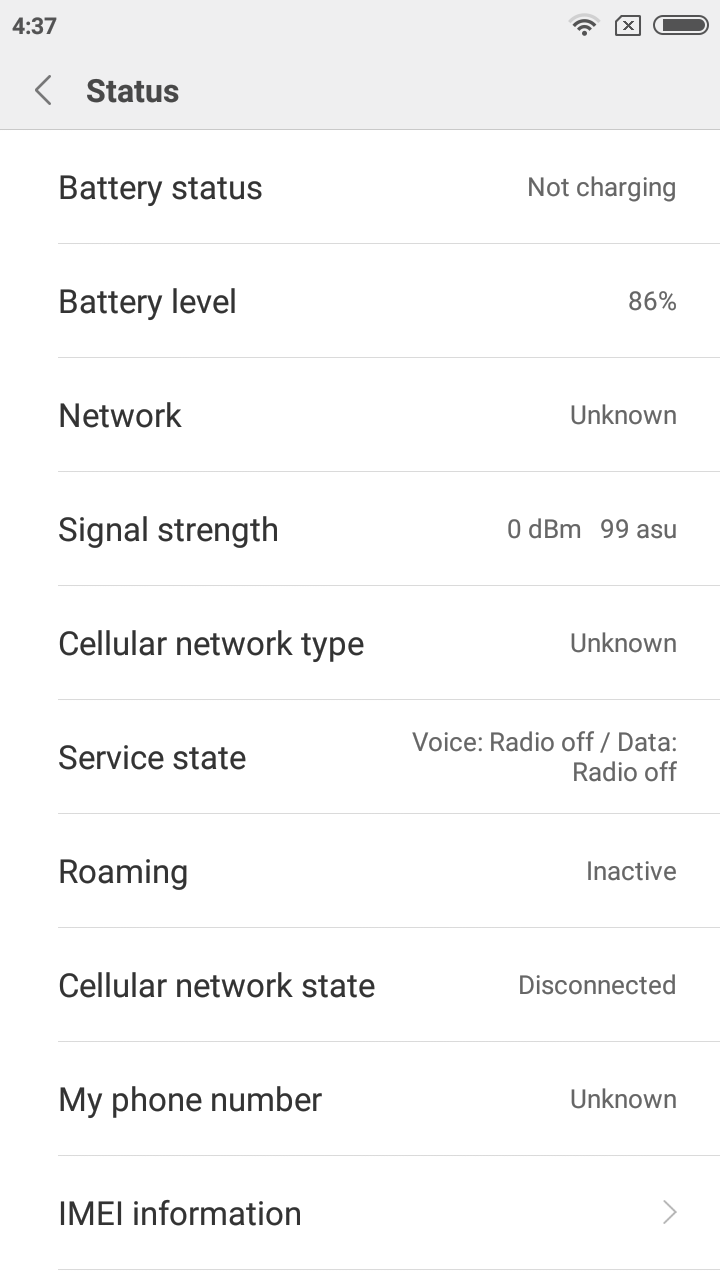

hi,
i too have a problem related to imei;
my phone's imei changed by a technician to a new one but i got "no service" error..
phone recognising sim card, asking and accepting pin code but then no connection to the service.
cheked the "service state";
voice and data radios seems "off".
flashed the rom via fastboot but no luck..
what should i do, anyone knows?
thanks in advance..

hi,
thanks in advance..
gonewild, sorry if i am out of topic, mods can move my post..
nobody? there must be a way..
