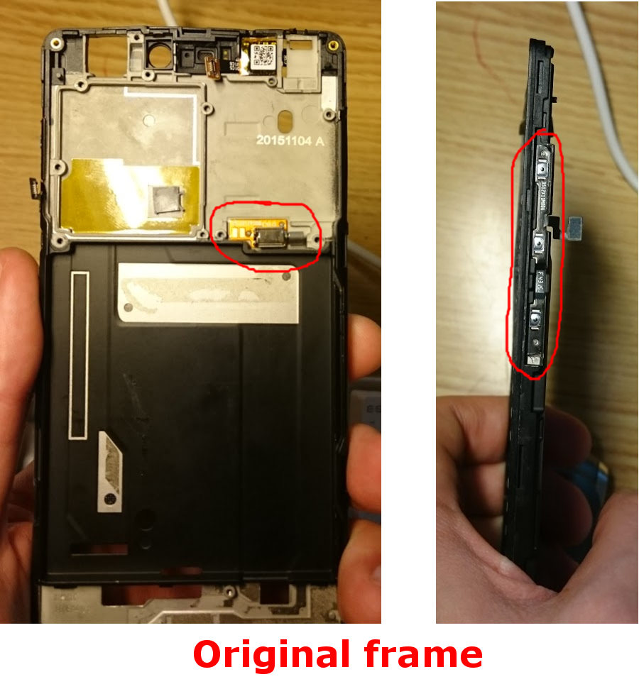

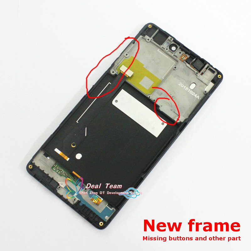

I bought a screen replacement for my Mi4C
The problem is it comes with all the frame instead of just the LCD and I've found that two parts are missing in the frame: the power and volume buttons and an other part which I don't know what it is.
As you can see the frame I bought doesn't come with these parts.
I tried peeling off the power and volume button strip from the old frame to put it in the new one but I can't remove it. Has anyone had a similar problem?
Thank you!!

Thanks I was able to remove both the buttons and the other part which is the vibration motor. I used a hair dryer to soften the glue and managed to scrape them off with a thin razor. They work fine in the new frame :)
