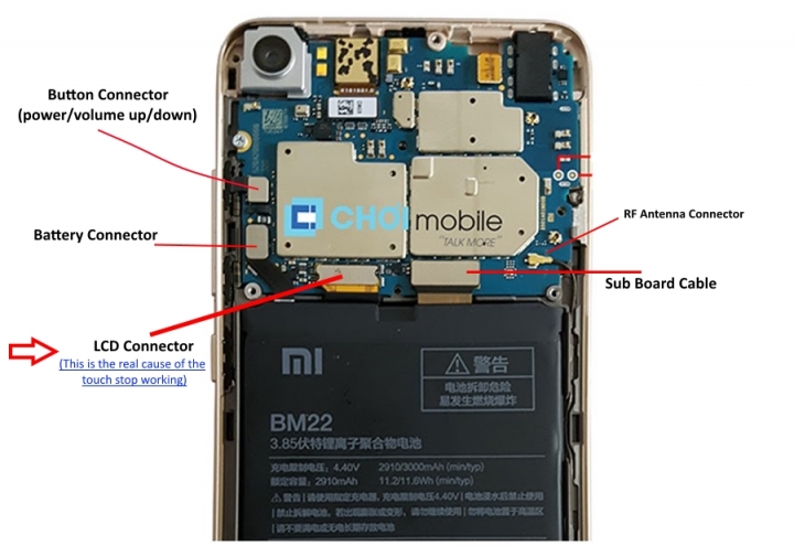

The problem causing this is LCD connector. I attached a photo so you can check.
A guy suggested that we should put insulation tape on battery connector and button connector as shown in the picture. After some tests figured out that those weren't causing any trouble but the LCD connector is doing the damage. Through some tests I believe that the problem is heat. I think LCD connector (without being complete sure) when it's heating up it is starting malfunctioning. Another guy suggested that we should put insulation tape in that LCD connector. I also tested it. It worked for a while but still issue appeared again. So what I did it might you permanent solution. Well, the problem is not really the LCD connector but the foam on the plate is defective. What I did is removing the foam from the plate by pulling it. I didn't even apply insulation tape, giving the LCD connector space to 'breathe' and function properly. This might be caused by poor material of LCD connector.

Solve step by step.
a) Open up phone's back cover. Use this site to see how:
http://www.myfixguide.com/manual/xiaomi-mi5-teardown/
b) Remove screws from top side in the back of the phone.
c) Remove LCD connector's foam (that soft think on the plastic plate)
d) that's it. Put it all back as it was but don't make the screw too tight. Good as new!!
I have attached photos to help you

I noticed that when I holding pressure on one connector evrything work fine, so I removed foam from one side and added to another side to create better pressure on that connector and from that moment I did not noticed this problem yet.
So probbaly you need to add something between that connector and intelnal upper cover so that pressure hold better that connector.
Just one more thing.
LCD connector in my case didn't causing a problem.
i noticed that problem is in sub board cable connector, so I made a pressure with two foams (one is removed from LCD connector to test previous solution).
This helping for now.

Just put 3 layer of paper(totally 0.5mm or smth like that, you can use also tape but it may leak because of temperature) on top of battery connector that i shown it in the picture as green box and close the back cover.
