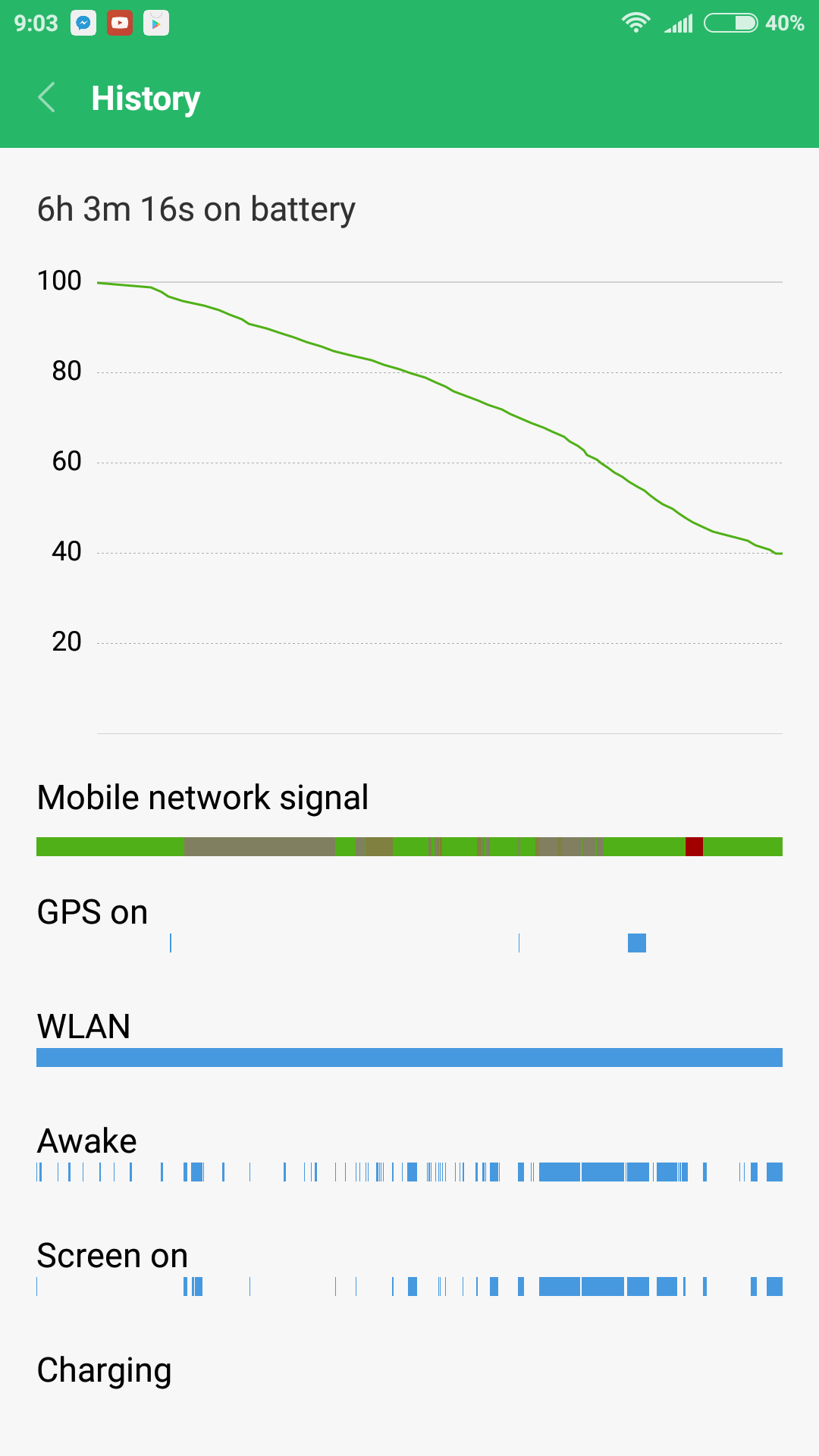

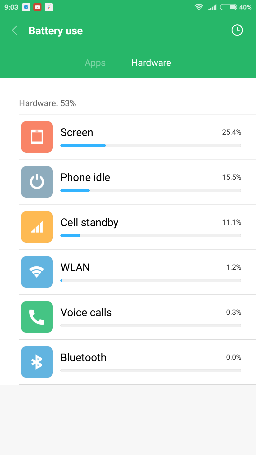

Here some screenshots, screen was on for 1h 35min so far, unplugged phone from charger 6hrs ago and now I'm on 39% :(

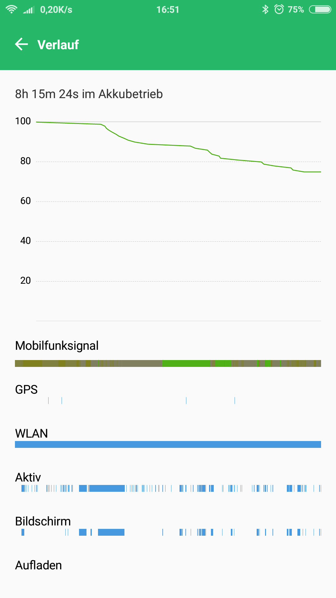

I will attach a screenshot of my battery history - I have MIUI battery saver enabled (only turned off for some important apps), MIUI Optimization off (in developer settings) and I use L Speed battery profile and Greenify. Amazing battery life so far with medium to heavy usage.

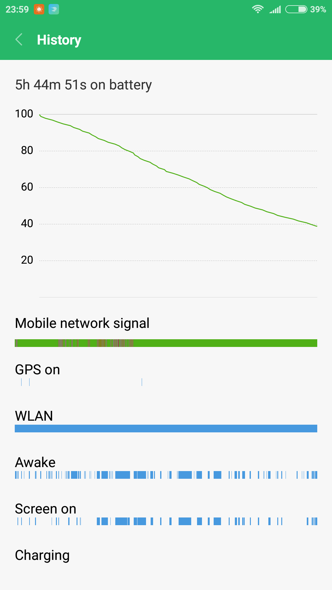

Installed BetterBattery Stats but nothing interesting there, can upload screenshots if needed. Betterybattery stats showing 10.2% per hour which is very high for me :(
L speed installed, rest set like you suggested please see screenshot, screen was on for 1hr 40min
What I noticed that at the bottom my phone is always warm for some reason, not sure is it cellular antenna, battery and what ever is installed there is always warm.
