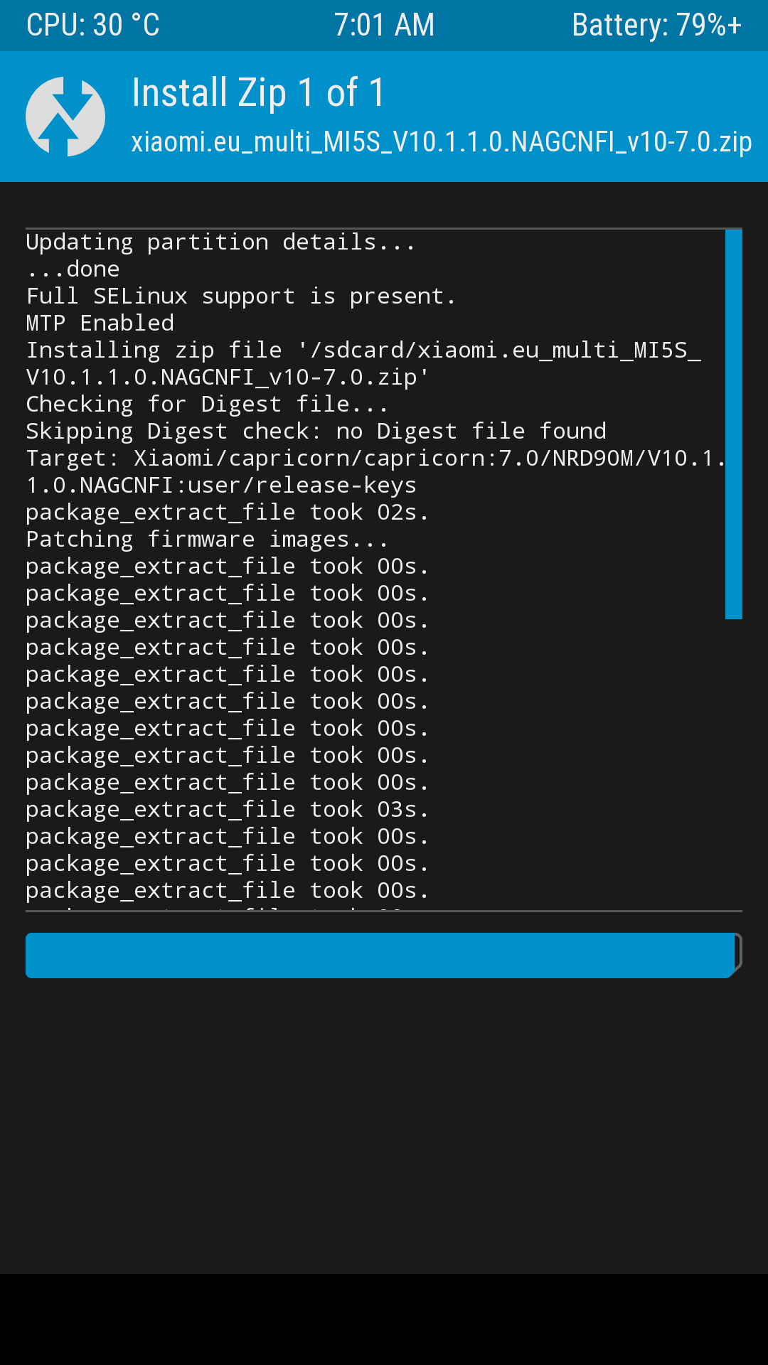

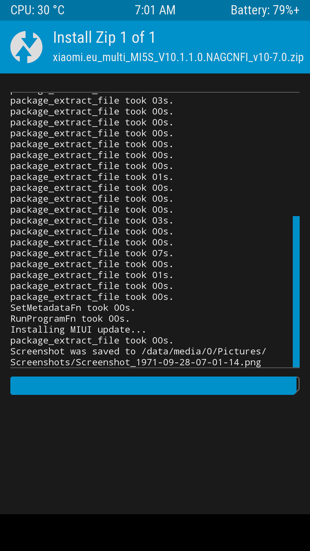

What TWRP version is needed to install this stable version on MI 5S?
I have TWRP 3.2.3-0 capricorn and i tried several times to flash this rom but it is stuck on 99% (see the attached image).
I did wiped cahe/dalvik/data/system and formatted data before install but it won't install 100%.
Anyone please help?
What i am doing wrong? Should i wipe the internal storage too, before copy the rom and flash it? If i wipe the internal storage it will wipe TWRP also?

Anyone please help?
I'm not sure this is a TWRP problem. In the past when the TWRP version wasn't the proper one (on my old MI5) I used to get a error message while installing. One way I was fixing it was trying with various version until it worked. Also try an older rom first or try flashing a global official one and then the .eu rom.
You say you formated data via twrp, that should of wiped all your storage, including the "internal sd emulated" one. The way it worked for mi on the mix2s was to format data by typing yes in twrp, than copied the rom on the fresh formatted internal storage, than install and boot . I suppose your bootloader is unlocked ...
Thanks for the answer!Of course my bootloader it is unlocked. I was on xiaomi.eu weekly 8.10.11 before, but i want the stable versions from now on...
I don't get any error when i try to install via TWRP, it just stuck on TWRP on 99%.
I also formatted data but same thing happens
Try an older twrp and / or an older stable release. it should work !!! also the rom takes pretty much time flashing. Have you let it do it's thing ?

So what exacly was wrong here in any possible way?
The instructions are not good. They are missing one key step! Which you did and written over the instructions found at the start of the thread but most users don't !!!
When you come from official global stable you need to format data via twrp. Enter the wipe menu and click format data. Than type YES when asked. Than TWRP will format all data including internal storage. Than copy the rom to internal storage, than flash, than reboot. If you don't format data via TWRP before flashing you'll get stuck at boot and the phone won't start.
This part about formatting data MUST be written in the instructions that you quoted because without format most of the phone's won't boot. It happed to me on the MI5, and than on the MIX2s when switching from official global to .eu roms.
