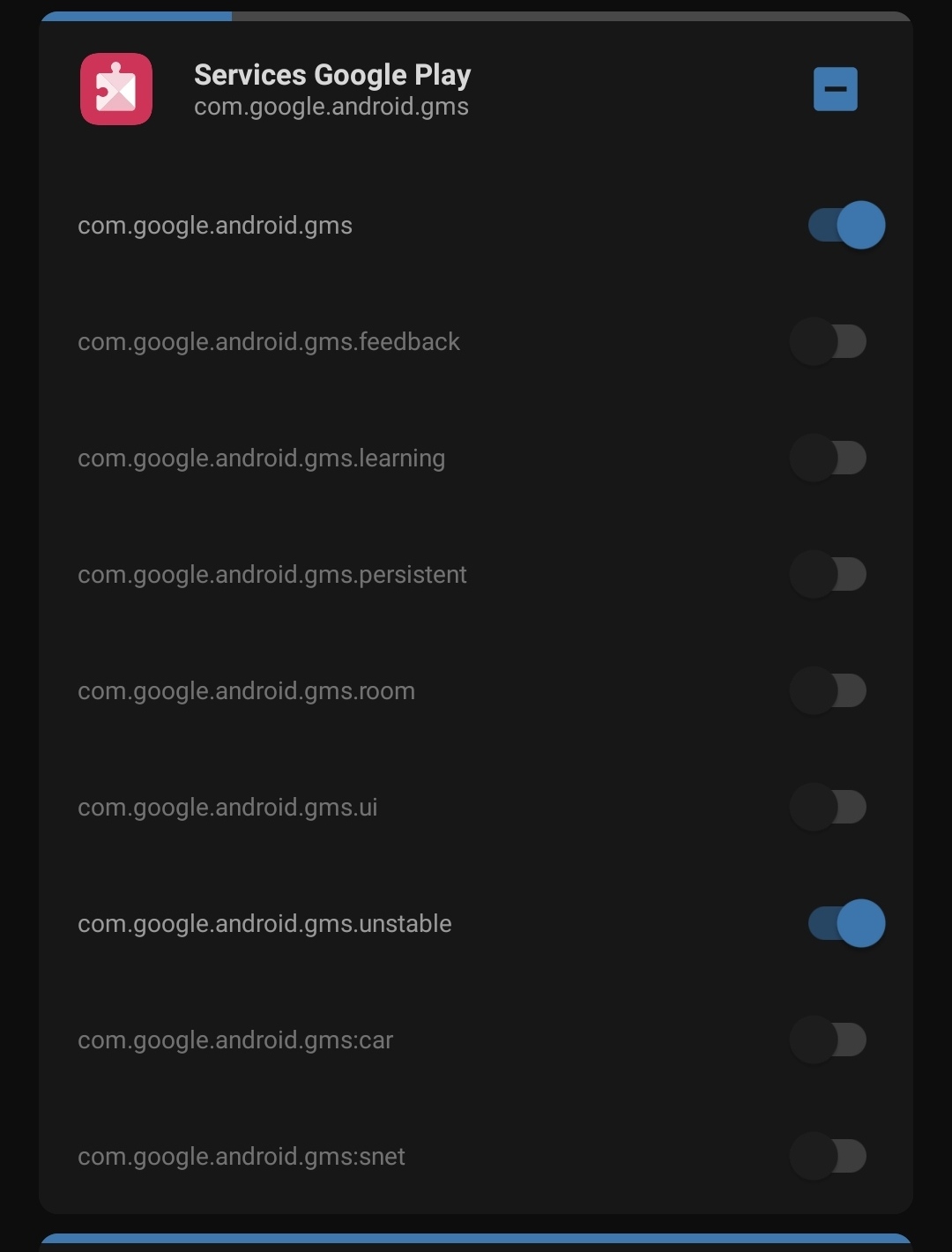

What's your Magisk version?
Anyway, in the root of your internal storage, you can also try to rename the "TWRP" folder to something else (like "CR") and also rename any filename with "Magisk" word in it.
And it's useless to enable MagiskHide for all Google apps.... Default config for MagiskHide is:View attachment 34755
Magisk version: 21.4 (21400)
Manager version: 8.0.7 (4834) (15)
Manager is hidden with name 'GiskMa'.
TWRP directory has been already deleted from the internal storage. There are no files/directories matching *twrp* or *magisk* (case insensitive search pattern) on the internal storage. I have not touched the system partition.
The only one thing I can think of is the open bootloader. I dont know whether the work profile enrollment app is able to detect that or not. But I dont want to lock it back.
Or some Magisk magic props config is detected...

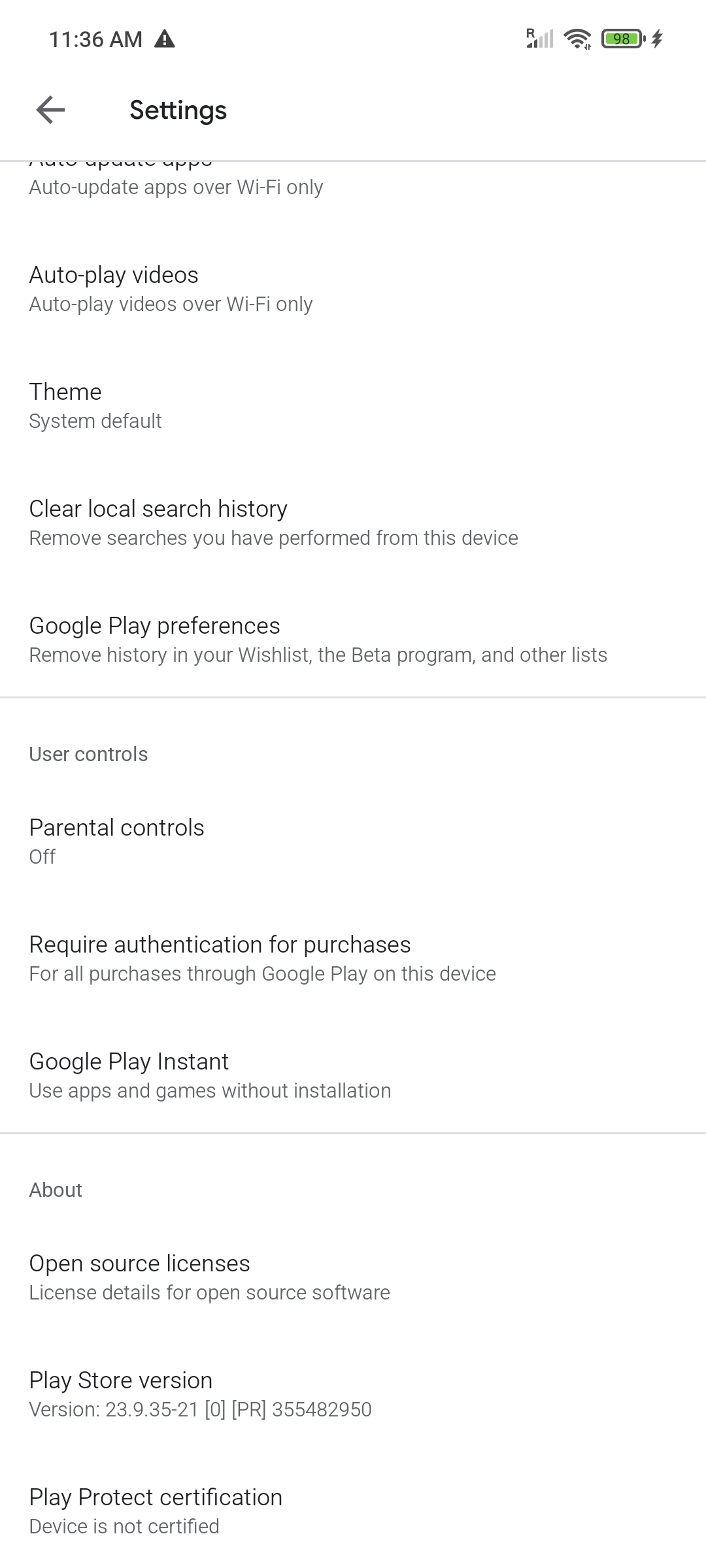

Its Stable Beta.. it will pass CTS when Xiaomi release it to public.. move to weekly ROM or downgrade to previous version if SafetyNet is so important for you..
I've downgraded to V12.0.8.0 and still device not certified.

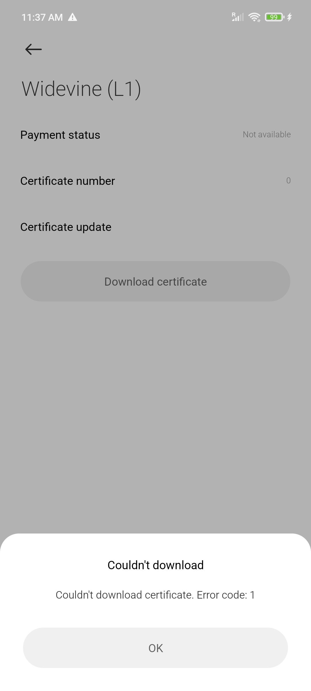

34775
Then everyone said if I want widevine L1 I have to flash the stable, and I did. v12.0.10.0 did not have and someone said to downgrade to previous version as that was stable beta. so I flash v12.0.8.0. And still can't download Widevine L1 certificate
34776
after install / reboot: clear Data / Cache "Google Play store", "Google Play services", "Google Service Framework" - reboot
https://xiaomi.eu/community/threads...fetynet-cts-profile-failed.59384/#post-584227
Somer hints:
  • hide magisk (Usb installation in developer options on)
  • hide app
  • hide google-services
  • delete /twrp
  • delete magisk_patched.img if its there
  • check play protect certification
I'm currently on weekly rom. When i search about background data usage of gallery, i only see weeklies, so I'm asking if the stable rom has this issue on gauguin .

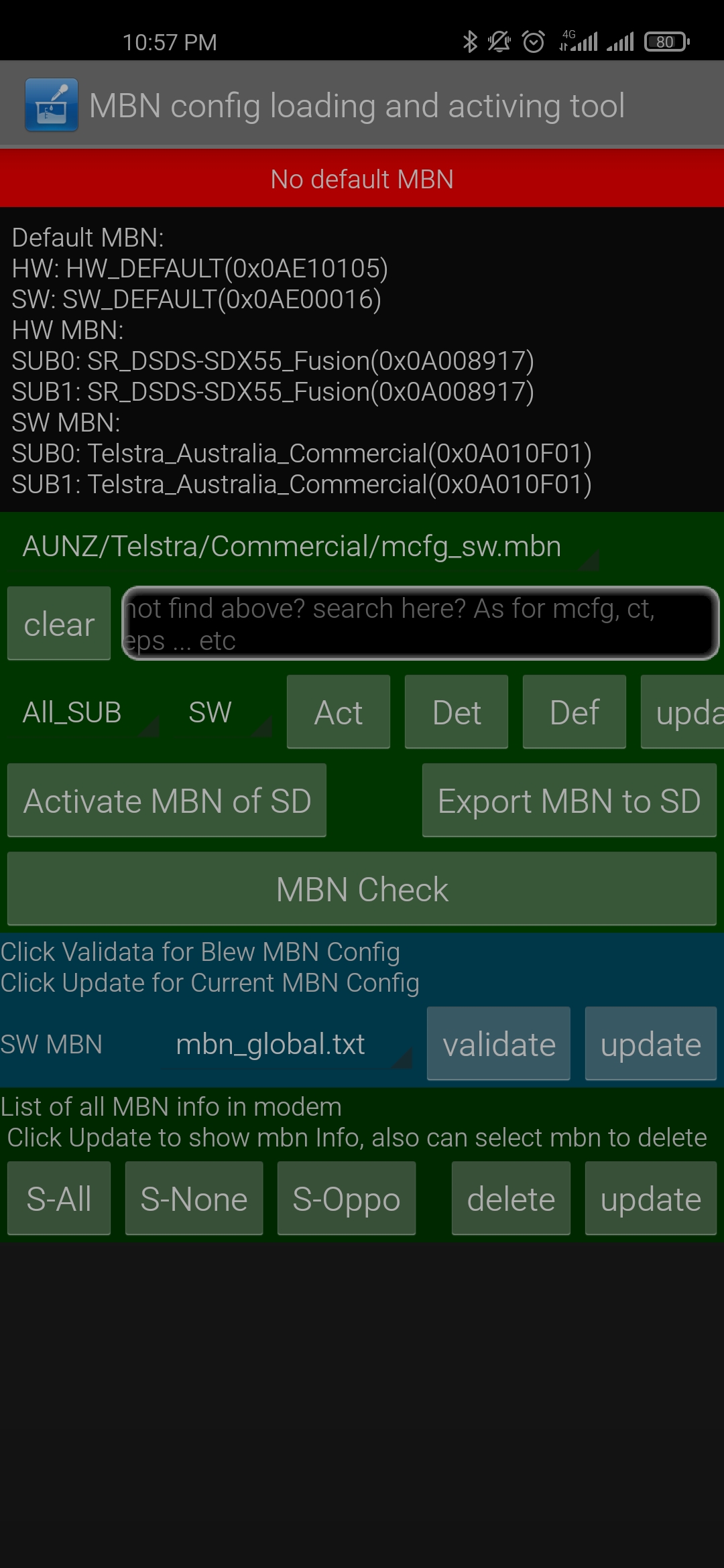

Since this is the first Stable Android 11 release for your device, changes in behavior are expected...
You shouldn't have to switch SW MBN, since Telstra is available in the default oem_sw.txt list, but try switching to mbn_global.txt (mbn_eea.txt won't work for you, it's optimized for Europe region).
Also, take a screenshot of the MBN config screen, so we could see it auto-switching to Telstra works.
Thanks, see attached. Is this what you meant?

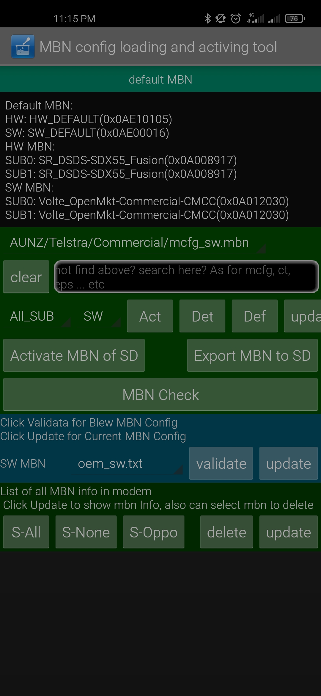

Yes, and it means nothing, because you set Telstra manually, it's obvious due to "No default MBN" message.
Telstra exists in the default list, set oem_sw.txt and reset to defaults ("Def" button) then reboot manually if the app freezes (happens often).
Only when the top bar is green instead of red, take a screenshot.
See attached
