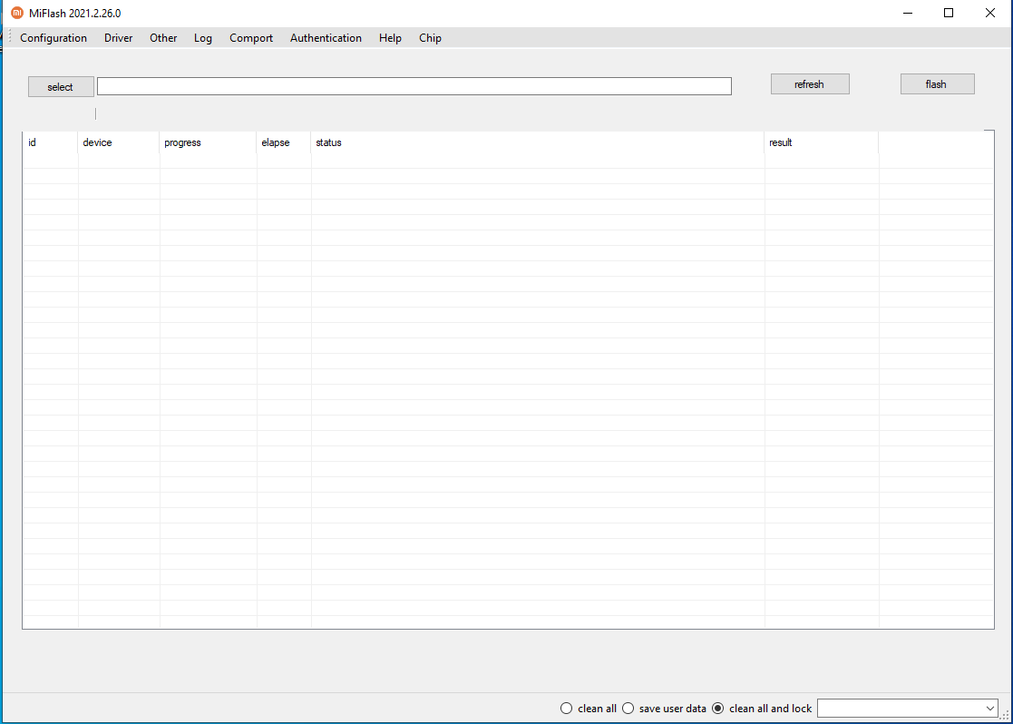

Hello, I have performed the installation of the rom xiaomi.eu_multi_MI11_V12.5.3.0.RKBCNXM_v12-11-fastboot-STABLE on Mi 11 stock with unlocked bootloader without any problem, I wanted to ask if I wanted to return stock and re-lock the bootloader, how do I do?

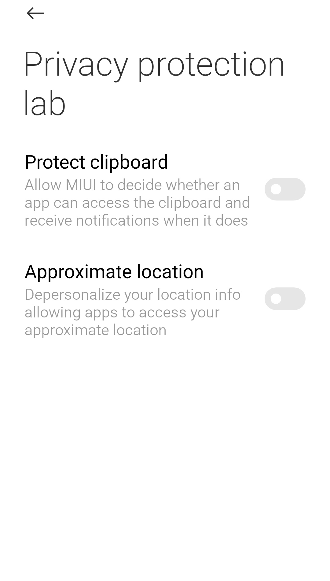

With the 12.5.3 stable I can't set the APPROXIMATE position of the GPS. I switch to activate it but the switch deactivates and turns gray. Ty for help
You have to use mi flash. A program that allows you to install the stock rom and relock the bootloader
