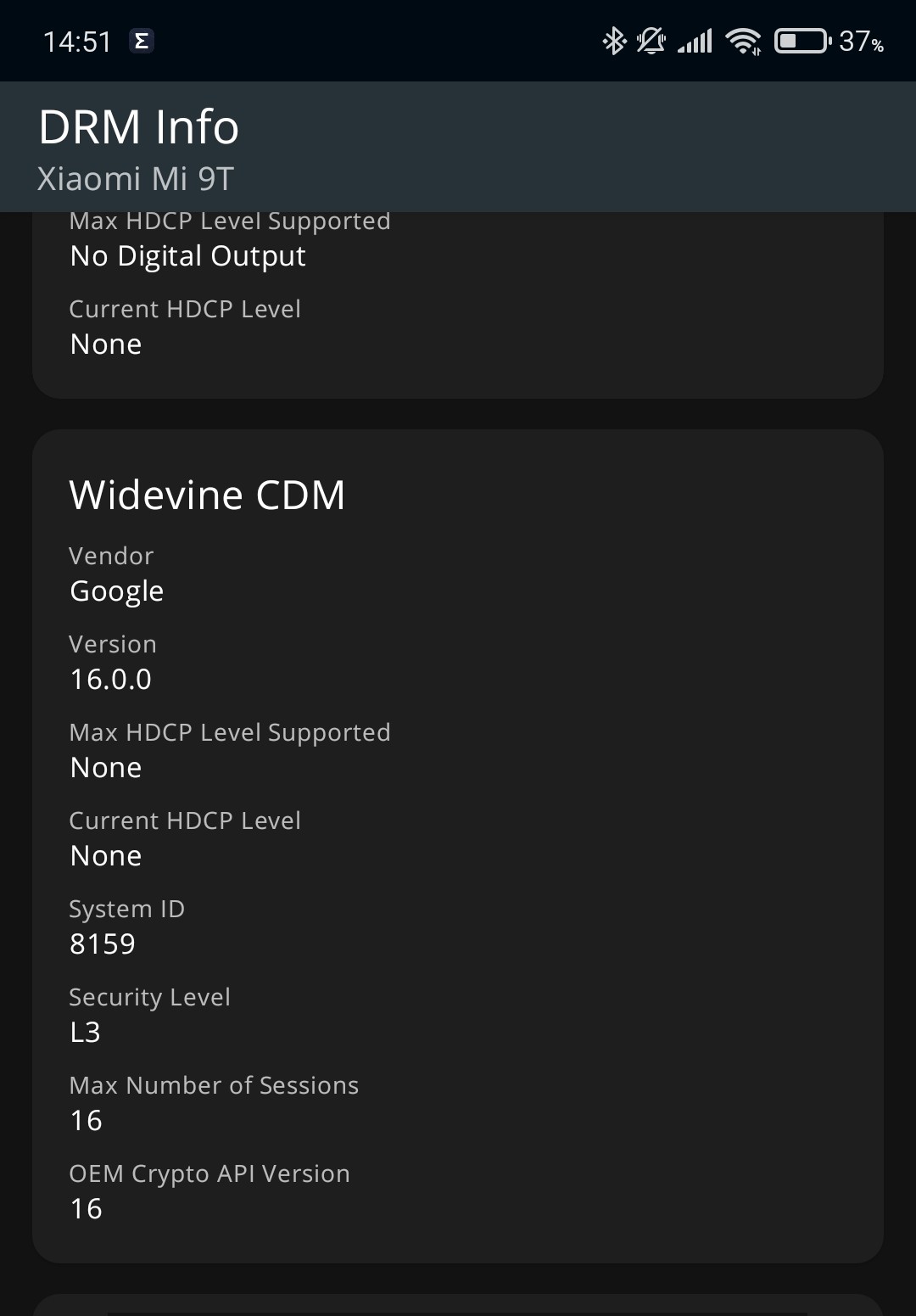

After a week using the latest version for the Mi 9T and with Widevine L1 it has suddenly automatically switched to Widevine L3 without touching anything. I don't have root. Any solution?
Mi 9T Android 11, Xiaomi.eu stable 12.1.2
There are a few reports of this issue for Mi 9T here...
Hard to find what is exactly the reason. :(
It's weird because it changed levels automatically without doing anything. Hope they can fix it as I use various platforms like Netflix. For the rest, I like the rom, I only have this bug right now.

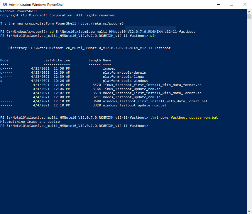

I using xiaomi.eu_multi_hmnote10_v12.0.5.0.rkgmixm_v12-11-fastboot.zip for Redmi Note 10 (sunny).
But i can not update to xiaomi.eu_multi_hmnote10_v12.0.7.0.rkgmixm_v12-11-fastboot.zip via fastboot. Who can explain for me?
But i can not update to xiaomi.eu_multi_hmnote10_v12.0.7.0.rkgmixm_v12-11-fastboot.zip via fastboot. Who can explain for me?View attachment 36217
Run this command in fastboot mode for a second, we need to know how to prevent this issue next time:
Code:
fastboot getvar product
Reactions: nguyentankiet
