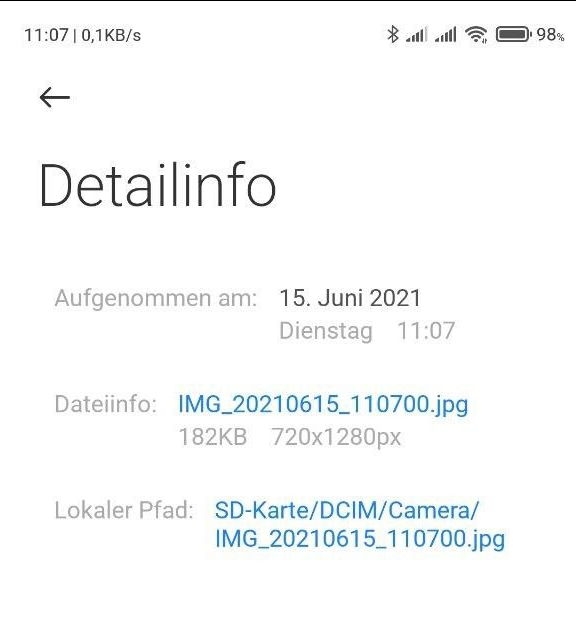

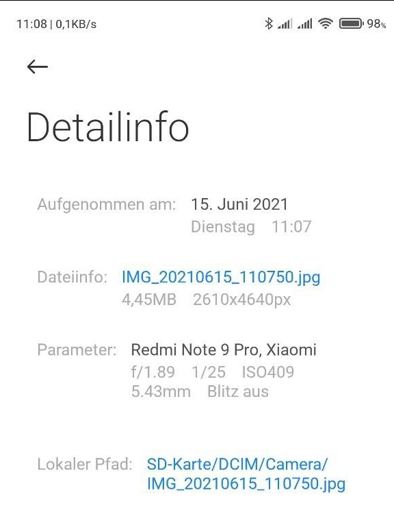

Hi there,
Since installed the "xiaomi.eu_multi_HMNote9ProEU_V12.0.1.0.RJZMIXM_v12-11", Android 11 ROM, I've Problems with the camera.
In Standard-Photo-Mode the resolution is to low.
When I switch to Pro-Mode it works normally.
Any suggestion?

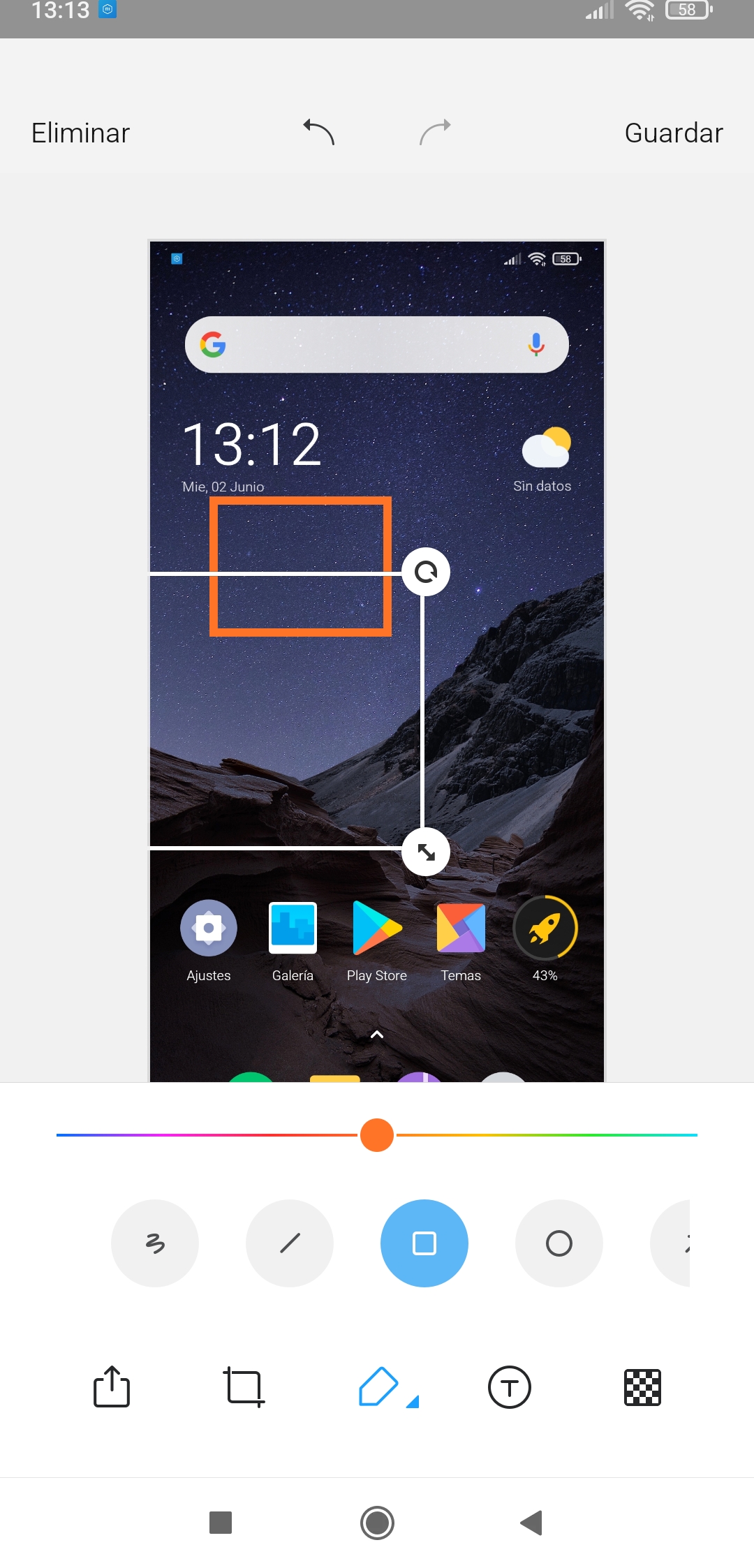

Hello everyone.
On latest Poco F1 (bellyrium) rom, screenshot tool is quite broken.
Take a screenshot and edit it. Then add any lines or squares and try to move/resize those. You will see there is like a desync bug between the object and its tools to resize/move it.
Any fix for this?
Best regards.
Sorry for bumping. No one answered and I would love to fix this.

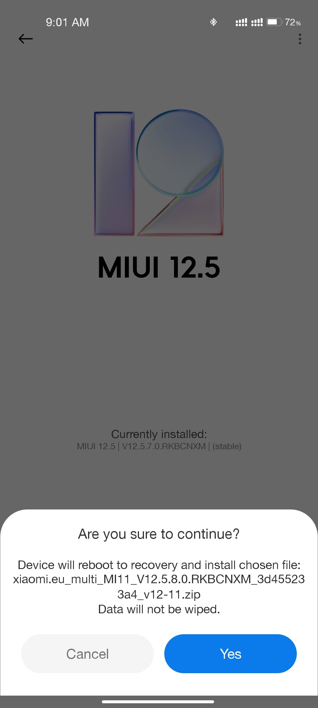

== How to install a ROM update
on Mi 11/Pro/Ultra ==
After that the Updater app downloaded the latest ROM for your device and after you checked the MD5, tap "Yes" to reboot in TWRP.
If you can't tap "Yes" button, tap "Cancel" then open "3-dots" menu of the Updater (top-right) => Reboot to Recovery. :)
In TWRP, go in "Install" menu and flash the new ROM (downloaded by the Updater, in root of internal storage a.k.a "/data/media/0" or "/sdcard").
Then reboot your device and wait a few minutes for the first boot to finish (after installing a new ROM).
P.S.: If your device is booting in "Mi Recovery" instead of TWRP, please follow this guide => https://xiaomi.eu/community/threads/guide-install-twrp-for-mi-11-pro-ultra.61239/

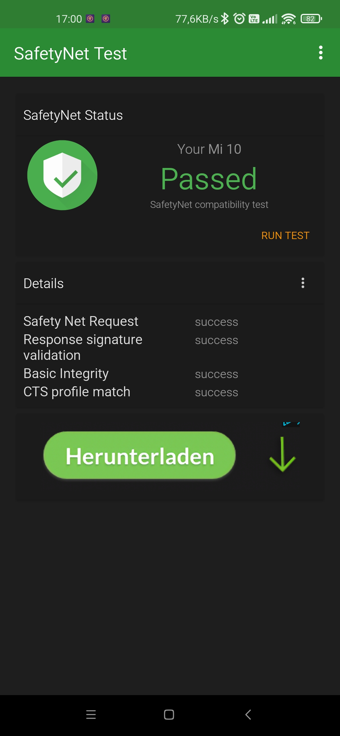

Anyone flashed it allready or i am gonna be first one who will report after flashing?
Safetynet pass? Bass fixed over streaming devices?
Edit: safetynet pass and so far it running. Bass issue on bluetooth streaming will be tested tomorrow but so far so good

Mi 10 12.5.5
Don't use safety net, but have flashed 12.5.5 and everything seems working fine.
