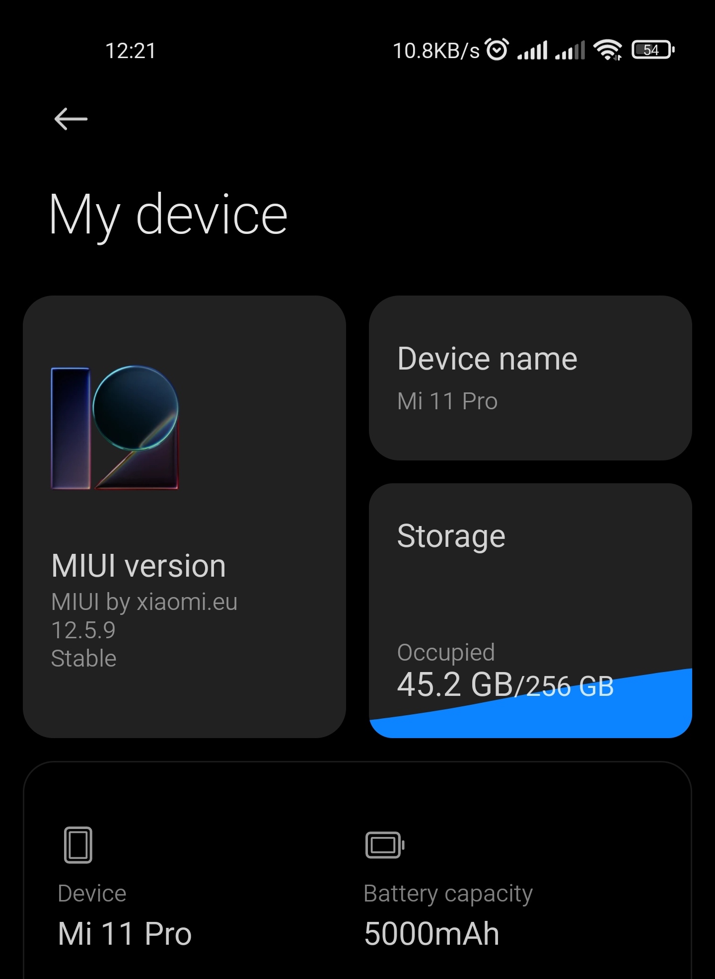

Hey Guys,
I have a Mi 11 pro and installed twrp
Now i downloaded the 12.5.9 but i cannot find it in twrp
Can someone Help me?

Hi, how are you? Where and how did you download it? Did you copy it directly to the phone's memory?
I downloaded IT with the phone's Browser.
Right now its located in the Download folder of the storage but when im in twrp i cannot find the zip
When you select install from TWRP and choose the Download folder, it doesn't appear? If you can, try moving the file from the Download folder to main memory.
Nah i even dont find the Download Folder, its Like that nothing is mounted
When i select the internal storage i See no files
Try downloading the file again from a PC and copying it directly into memory from TWRP.
Have you done some kind of Formatting before trying to install the ROM?
