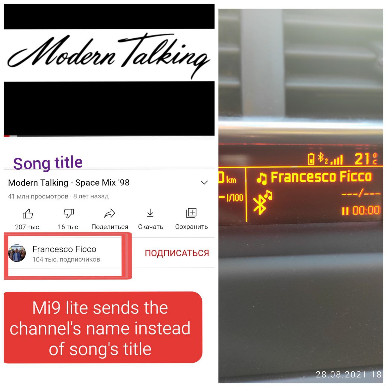

Mi 9 Lite, 12.5.3 by Xiaomi.EU, installed with wiping data (yes) and Cache clearance.
I have a disappointing glitch while Mi 9 Lite connected to the car audio unit (Citroen C4).
Since this week my smartphone started working incorrectly with media tags of any song on all music or video players like YouTube, VLC, Apple Music, etc. Please see attached pic. It sends channels names or albums names instead of the song titles on Youtube or Apple Music etc. So I have no idea what song is playing at this moment.
The past week I was on an official firmware on 10-th Android, everything was okay with tags and Bluetooth!! Then the ****** official update 12.5.1 (or smth like that) came over OTA, and the smartphone started glitching with the tags. Today I updated it with 12.5.3 by Xiaomi.EU, but with no effect.
I really need the correct info on my display when I'm driving the car!
I got the root access and can modify-overwrite any wrong fille in the system, but please, give me a tip on which one, what to do!
Many many thanks in advance!

Guys, please help!!!
There is a setting in Developer options that might help, AVRCP Version, try with different versions, with my Poco F3 i had the issue that it didnt sent any track info to my car, now it works after going from 1.4 to 1.3, give it a try.
Thank you, but I had tried with no result. Maybe I should have re-pair devices after changing avrcp version, or switch Bluetooth on-off after that... I will try, but not sure that it can help.
