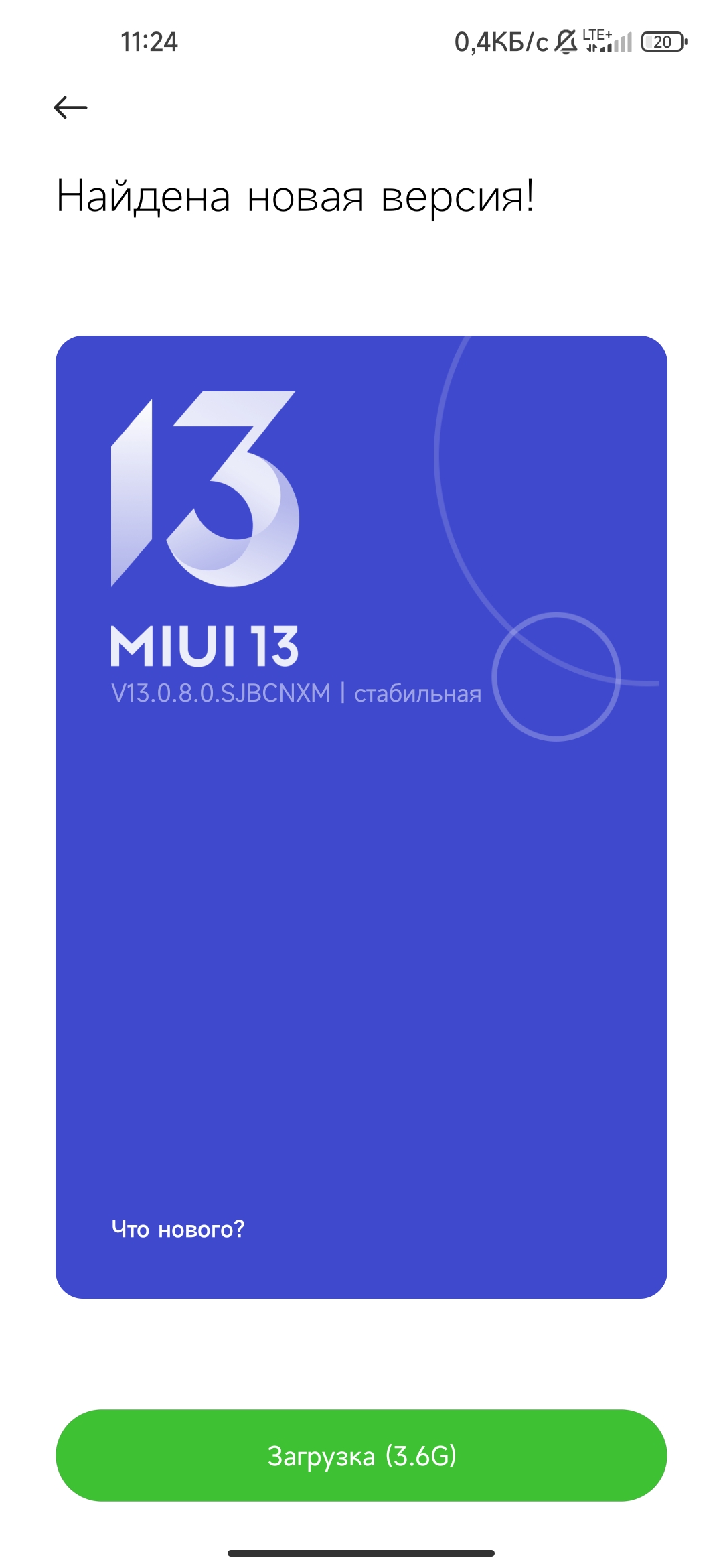

hello!!! If I download the firmware for mi 10 android 12, can I install via Fasboot? It's just written that version 13.0.8.0 is the latest available through the recovery?
Hi, no this is not fastboot rom. You need to install via package update or twrp (orangefox) Recovery
Latest ROM for Mi10 it's a recovery ROM...that mean you need to flash it with TWRP.
Only ROM zip files that have "fastboot" in the file name can be (and must be) installed through Fastboot - all others must be installed through the custom recovery
Simply check the names of ROM files for your phone on the Download server - there might be older releases of Fastboot type and newer of Recovery type (once a custom recovery that supports A12 becomes available for the given phone, all future releases of Xiaomi.eu ROM for that phone will be of recovery type)
And no matter is the installation Fastboot or Recovery type, this is a custom ROM, hence Bootloader must be unlocked.
When unlocking BL and later when (first time) installing the custom ROM, your phone will be Factory reset
Reactions: katerpanne
