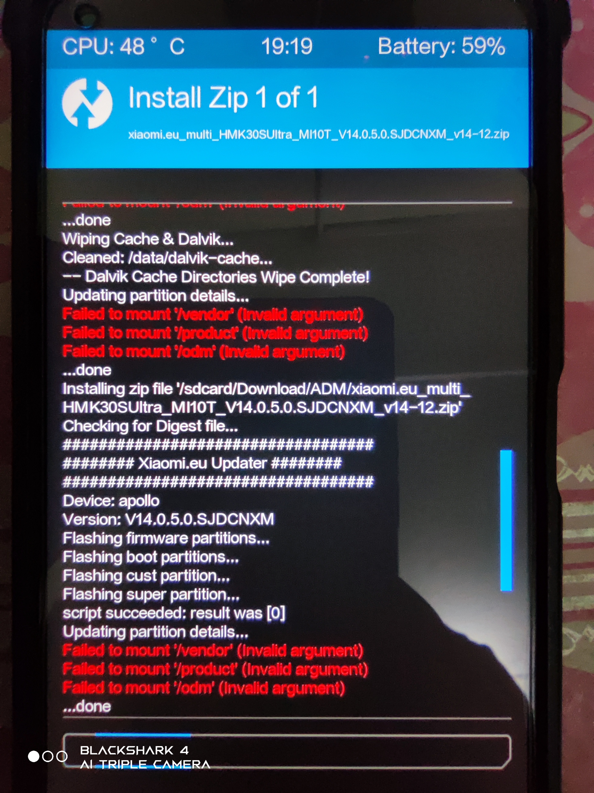

Device mi10t pro got this issue after flashing to latest miui14.version before is miui 12.5.when i want to reboot said no os installed.this normal or something wrong
