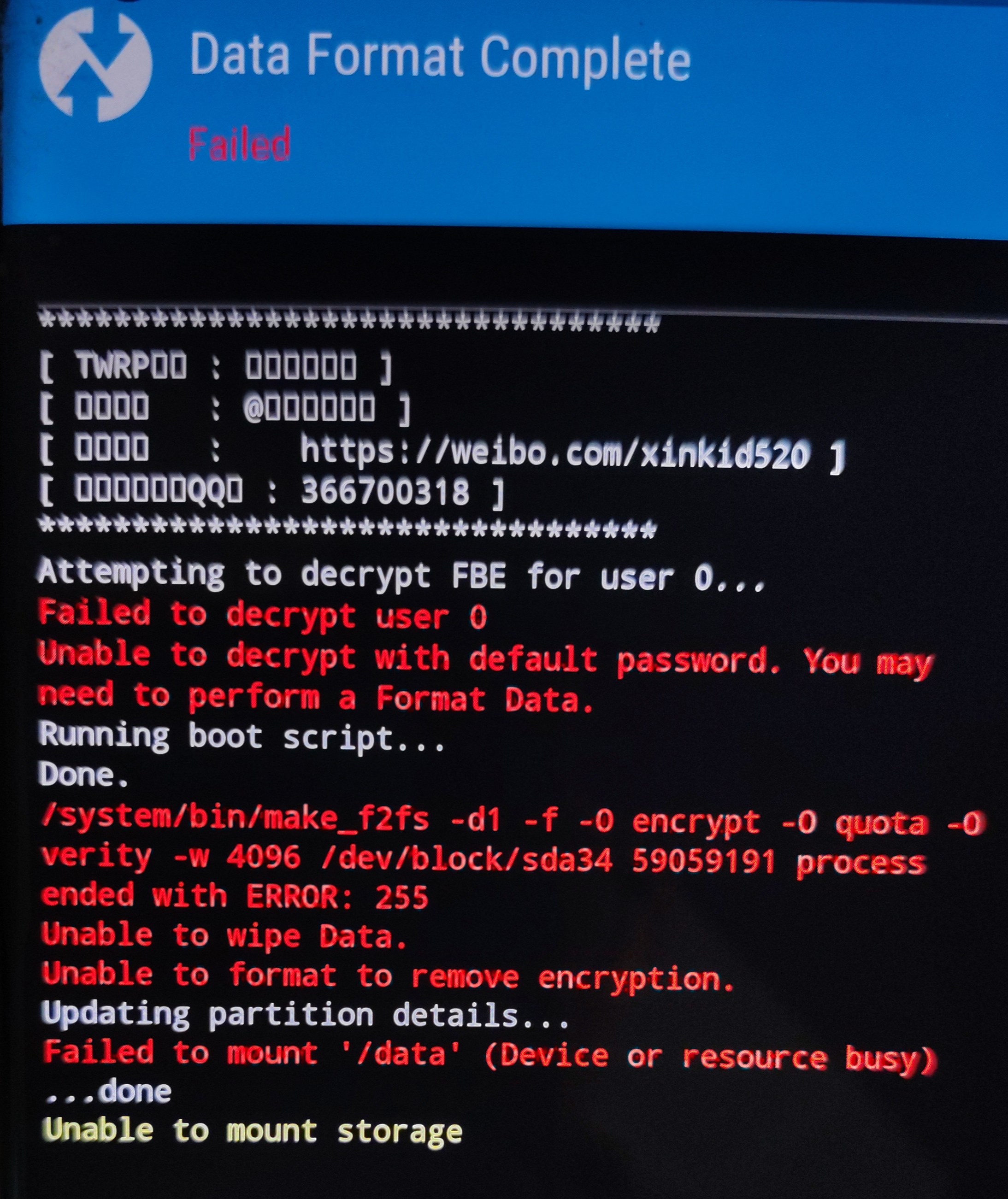

For some reason I can't uncrypt data
I even tried disabling face unlock, set up a password instead of a pin, but I am stuck and can't wipe data
How to fix this?

This is what twrp shows when I click on format data

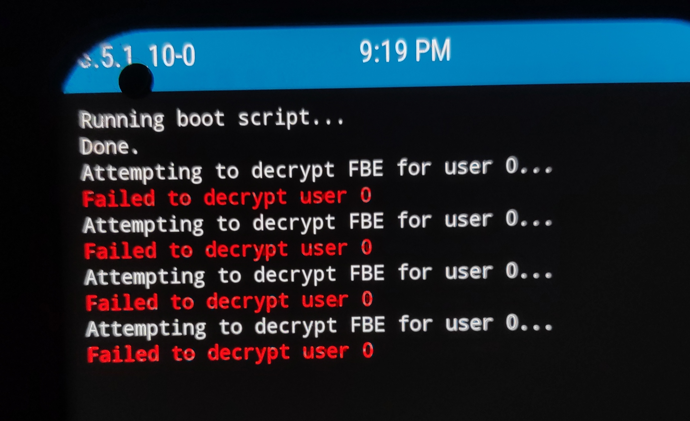

Update: I solved the decryption (I'm not sure, though) rebooting to system and removing every face/fingerprint data + activating usb debugging and oem unlocking on developer options. Problem is I am still stuck with this

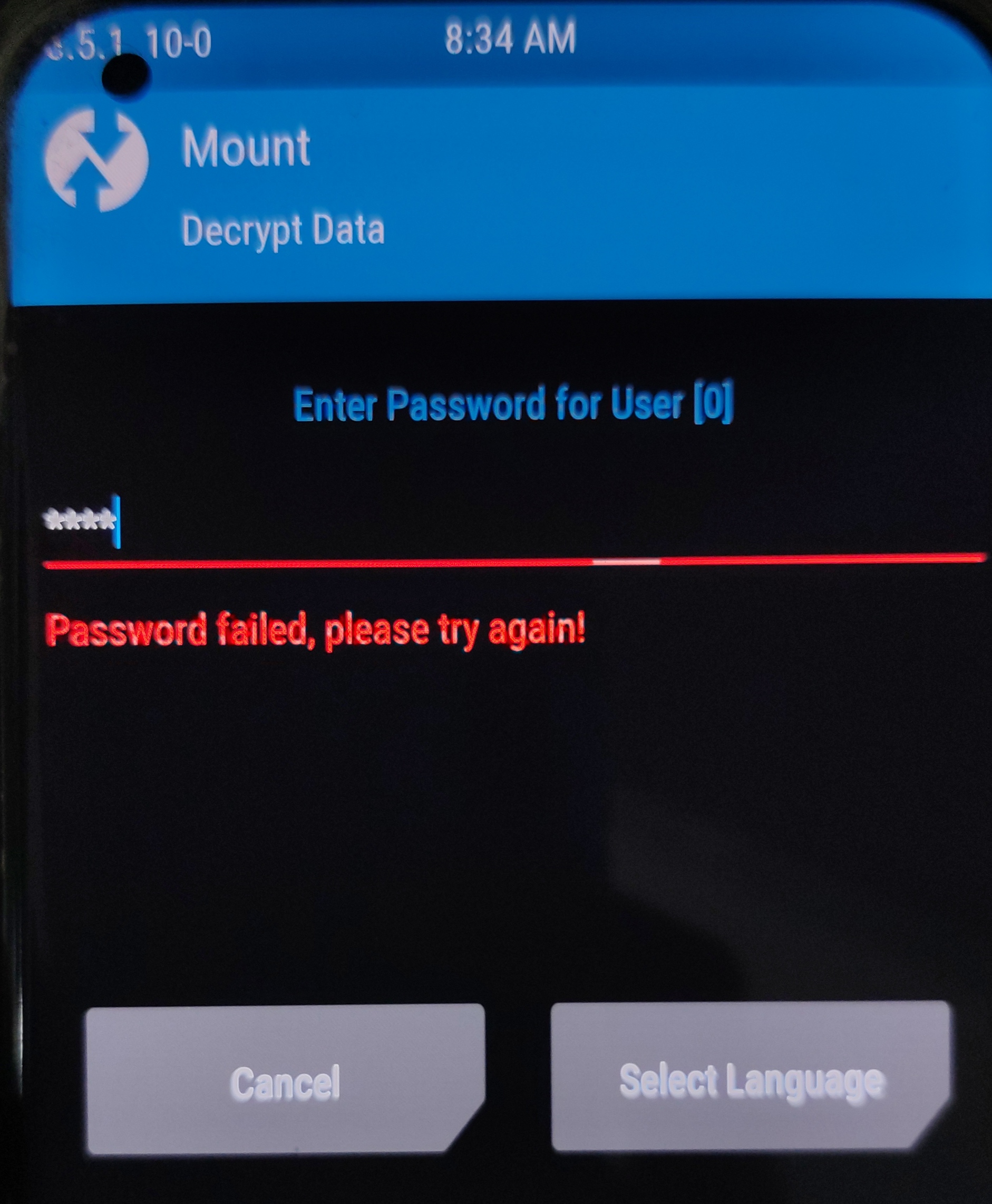

I followed your instructions, but it keeps asking for a password I don't have, since I removed every kind of lock on my phone, when trying to decrypt data via "mount" menu.

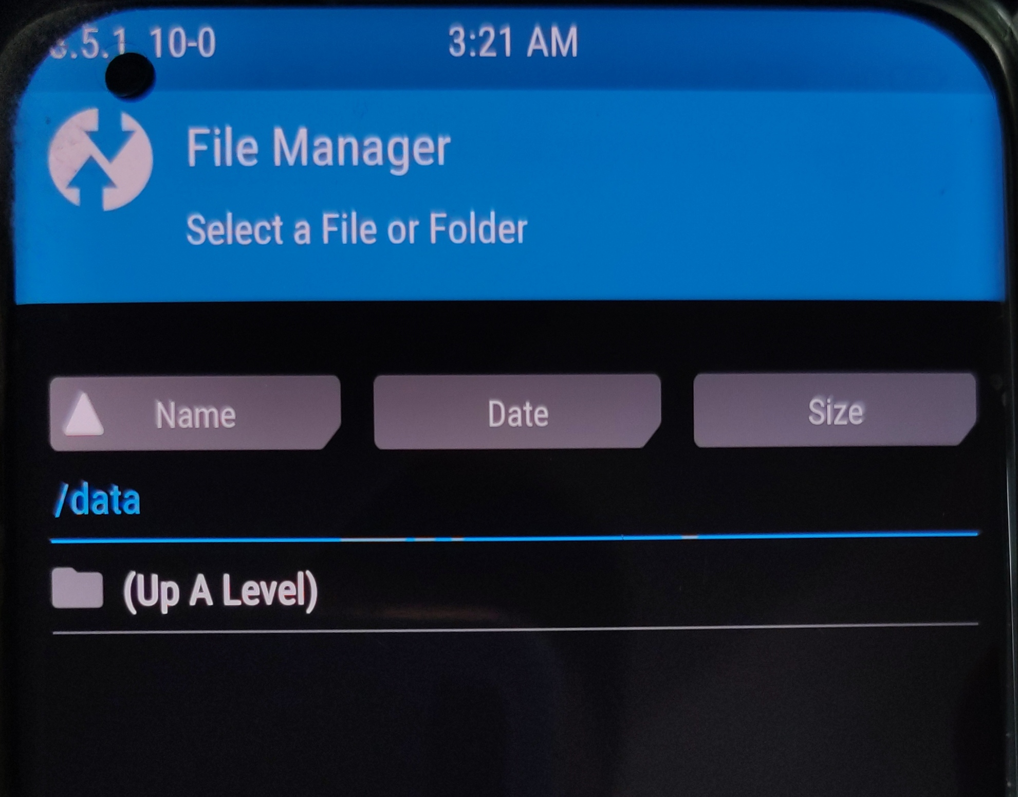

I can't find locksettings.db on data/system:
you cantfind it coz it is not decrypted. try to set a PIN - 4 digits and try this again

New pin set, but still not working

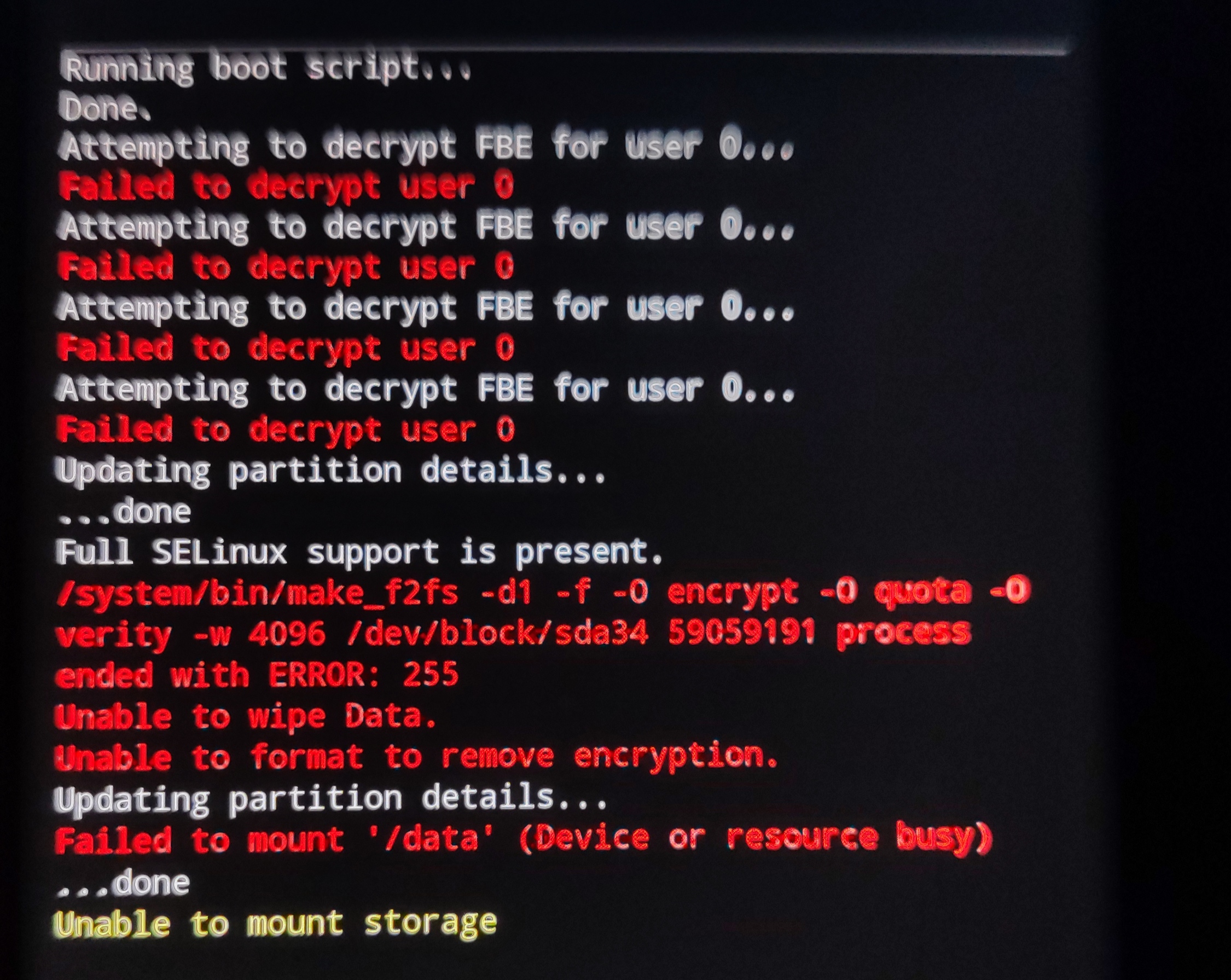

Edit: I somehow managed to get access to data/system and deleted locksettings.db, but after reboot to recovery I still can't format data since twrp is asking for a password
