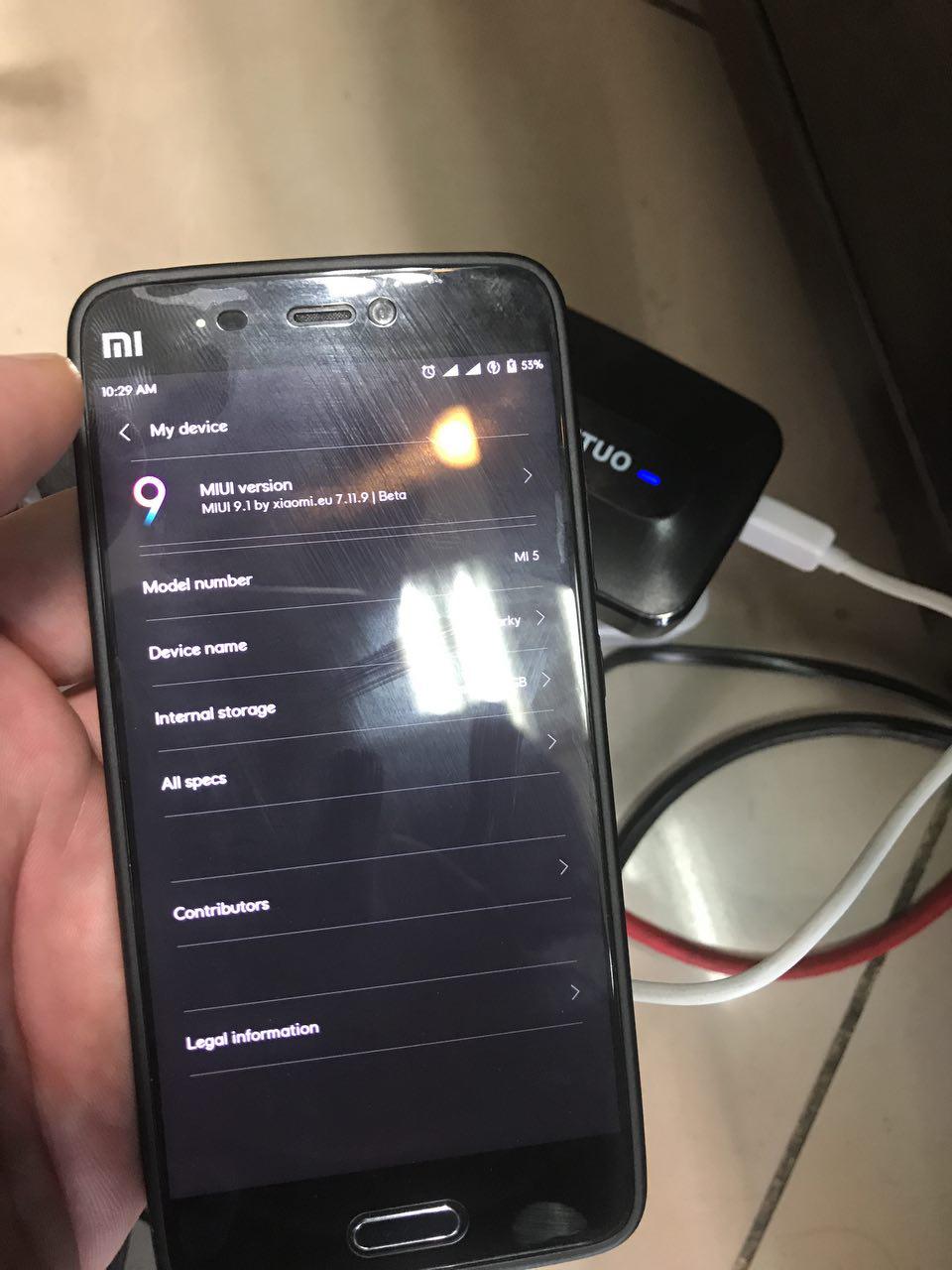

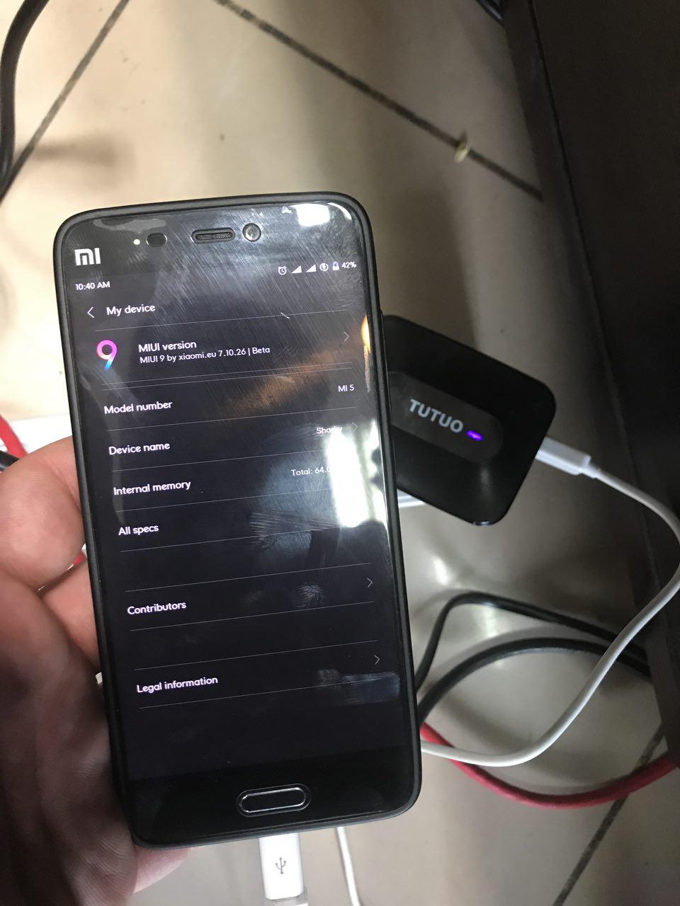

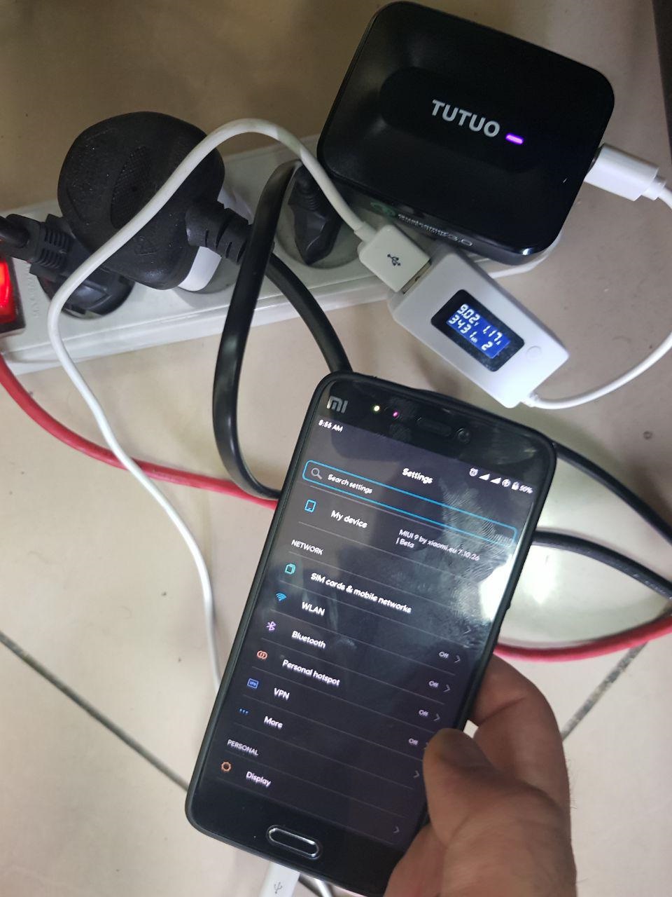

Still useless !!!
The only version that QC3 works fine is the 7.10.26 !!!!
I tested with Apmere Meter, and with my new Tutuo Charger(Qualcomm Certified) when the phone supports QC3 and start charging with various voltage (Start from 12v/1A) the LED turn to Purple from Blue !! Blue means normal smart charging and Purple Means QC3 !!!
It's been a while since the first MIUI 9 rolled out !!!!

Dude i got it, you are a scientist, but mine charges with 6V/1.8A , So, 10.8W is very LOW from the Expected power !!!!
Before it was 9V/1.5A and 13.5W was satisfying !!!
