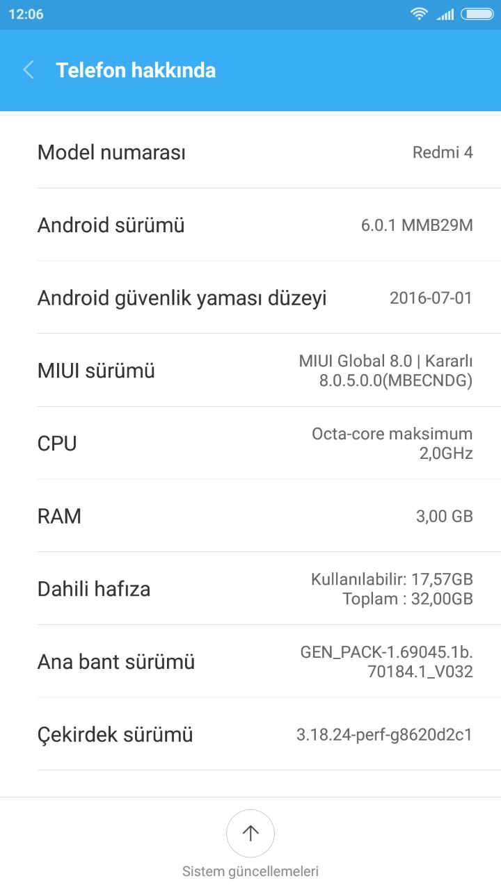

Can someone tell me if i need to install another Ui this one is ok.
Its a fake shop rom, you can flash xiaomi.eu if you want to or stay with that one, but you wont get any updates
