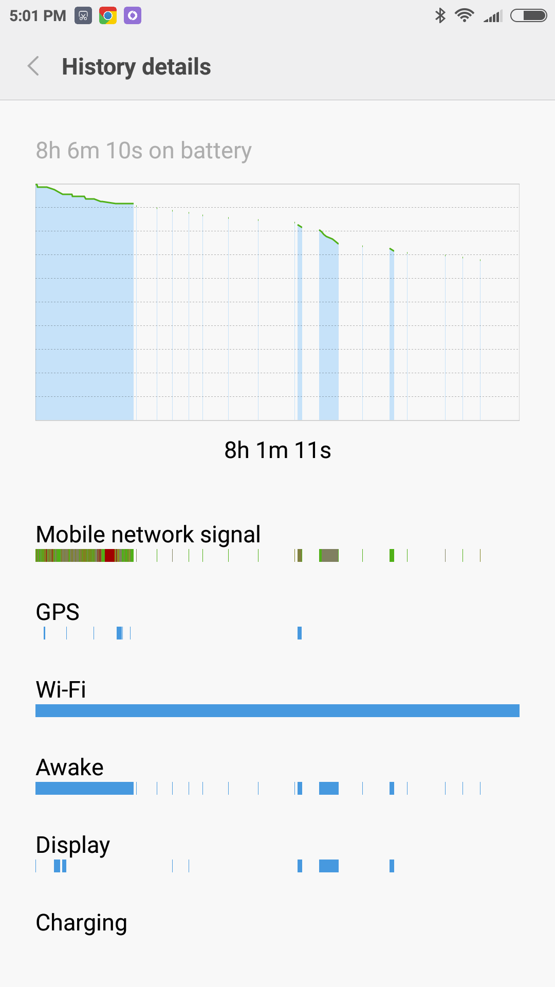

It sadly is not a ROM issue. We are many Redmi note 3 pro Qualcomm suffering this serious issue. And it occurs in every ROM around.
What happens is when the screen is off (phone idle) radio will shut down. That's why you are not receiving calls. The signal drop can be seen in Security app>battery use>battery history (the small clock icon in the upper right corner). See attached screenshot.
This issue is frequently reported by users at MIUI forums, but we don't know if anyone at MIUI team is actually working on a fix. As of now mods keep marking the issue as answered and telling the users to wait for an update (this answer is being served for more than a month now)
Sadly the only thing you can do is going at MIUI bug report and confirm the threads about this issue and hope it draws developers attention!

Had a look at Gunmoule's img and have never had this happen to my phone, I have had my phone 2 weeks and never seen this problem , today it started, noticed it started when the battery reached about 70% lost network about 4 times until battery was at 47%, have recharged it and will keep an eye on it and see when or if it starts again, 1.5 hours on and it has not dropped network at all...
Thing is most users will probably never notice because of the randomness of networks drops. If no one calls you during said interval, it's transparent.
Most of the time it is perfectly fine for me in the morning and then it will randomly drop for the rest of the day.
