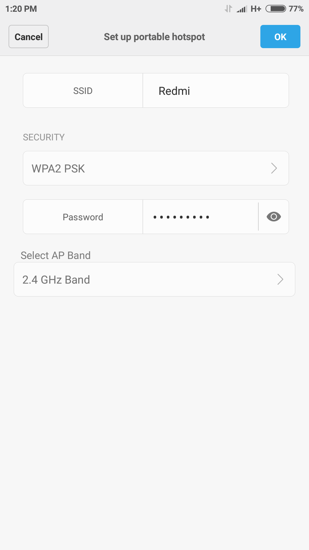

People that can use SP Meta Tool and change the settings ,ould you check if this enables 5GHz?
1.- 'AP Editor'. Click on “read from NVRAM”, select the APDB file and click open.
2.- A tree will appear in the left side of the window. Expand “AP_CFG_RDEB_FILE_WIFI_LID”, select '1' and click on “read from NVRAM”.
3.- The right side of the window will now be populated. Change the values of ucSupport5GBand and ucEnable5GBand to 0×01. Click on “save to NVRAM”.
4.- Reboot and check WIFI APs...
Thanks in advance.
The WiFi chip used in Redmi Pro supports 2.4 GHz and by modifying the software the chip will overclock the frequency up-to 5GHz and then the Bandwidth will drop more than double. So, it's not usable, just work with 2.4 GHz or buy note 3 Pro.
