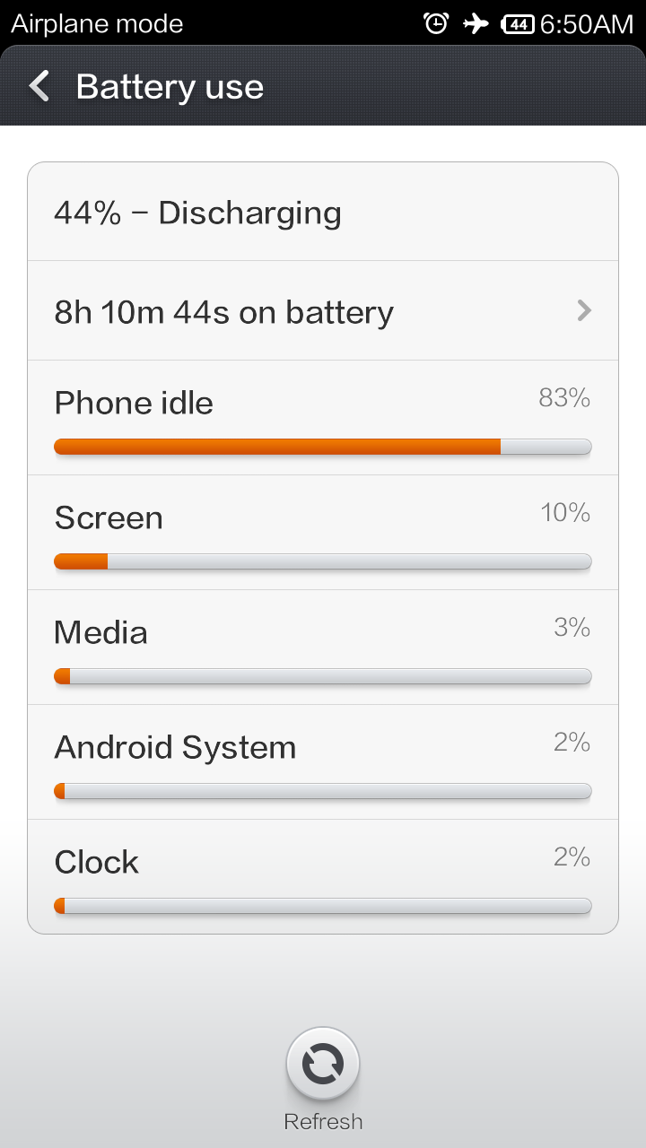

My Xiaomi MI2S Phone (32GB) consumes about 50% battery overnight. When I bought this phone, this was closer to 5%.
Even when I:
- disable Bluetooth
- disable GPS
- disable WiFi
- put phone in flightmode
- turn off screen
my phone still consumes 56% in 8h time.
Screenshot:
Does anybody else have this issue?

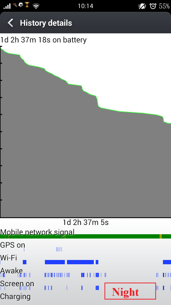

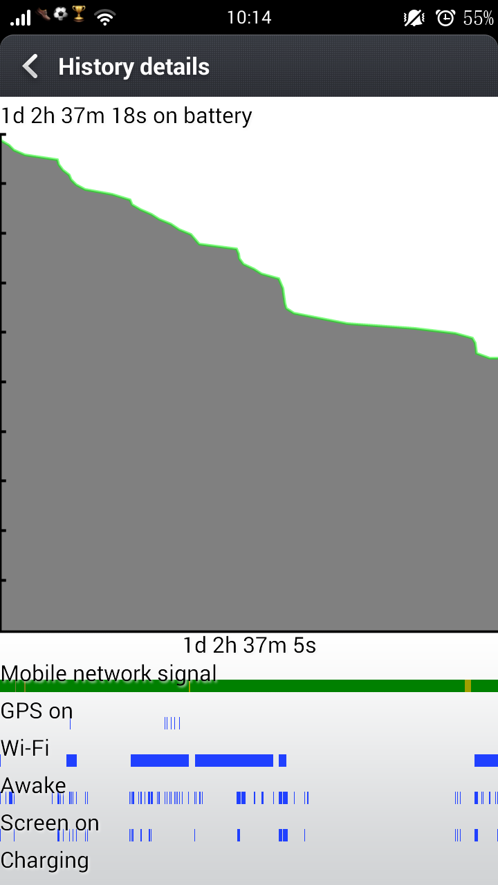

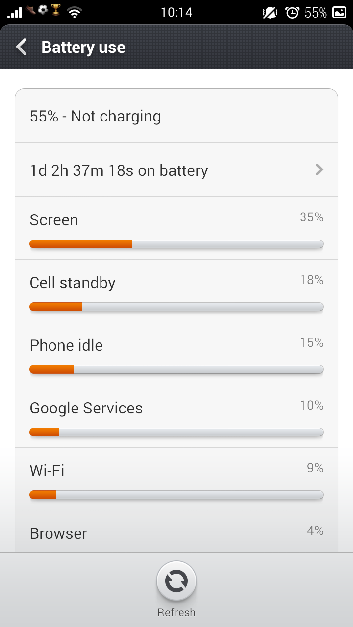

This is mine
