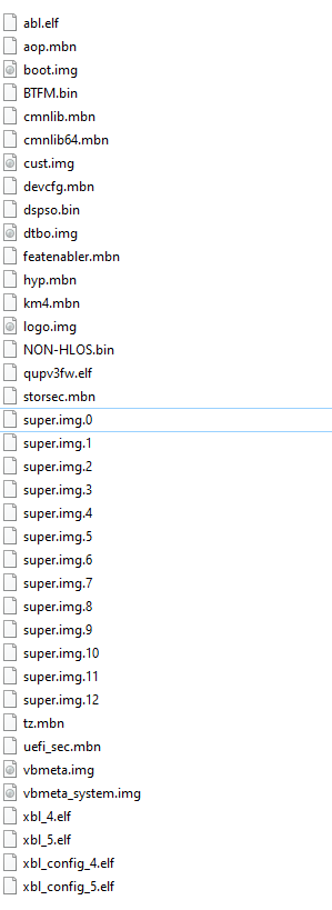

You could try to reflash the rom but with the modem.img from the previous release, no guarantees it will work or won't break anything but might help without a completely clean install
Already thought of this. But unfortunately I did not keep FW Version before rebuild and can not find it online or on my disk, I only find an older version on my disk.
Additional in older version and in the rebuild there is no modem.img in the Image folder.
